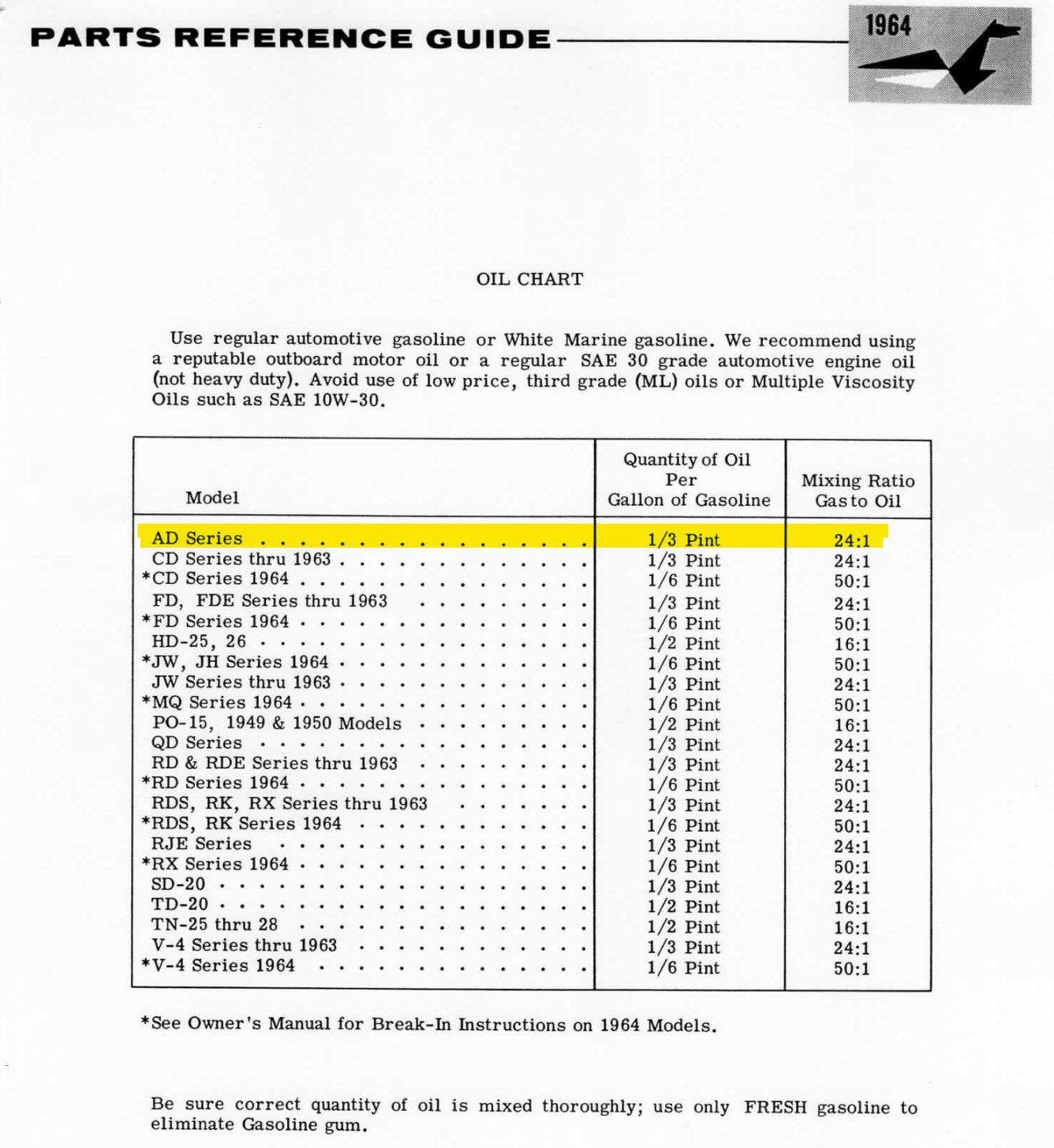

    My Johnson AD-10 owners manual says to use a 1:16 mixture. Yet I came across this common parts list from 1964 which mentions 1:24.
    I’m aware of the brass bushings and pros and cons of using these mixtures but I was wondering if anyone of you has actual experience with running these engines on a 1:24 mixture?

    Well, it is up to you.  Personally, I disagree with this recommendation, especially on the 7.5hp models, which are more prone to rod failure.  I know, today’s oils are better, true enough.  But, they are not that much better.  The beauty of these engines is when they are in good tune, they hardly smoke at all, even at 16:1
    Stick with the original 16:1 recommendation…

    Thanks for your response. To be clear, I’m sticking to 16:1 as recommended, I’ve just finished a complete overhaul and paint job. Since this will not be my daily runner I’m not that concerned of using a 16:1 mix. It’s just that I’m curious if people have actually run these motors on 24:1 over a longer periods and how that turned out in terms of wear and tear. Is there actual experience that it’s bad for your engine at modest speeds, or is it just a matter of “better safe than sorry”?

    As the years went by and consumer pressure mounted I am sure that there was “pressure from within” at all the outboard manufacturers to ease the oil mix requirements on their engines.
    One only has to look at OMC’s decision to recommend 100:1 for a while;  before they started getting a bunch of warranty claims for blown powerheads.
    I would (and do) stick to the original manufacturers recommendations on the 50’s engines .

    In 1971 the factory oil recommendations were updated again to 50 to 1.
    To answer your question as to do people actual reduce the amount
    of oil they run, I do. I run 3 oz per gal. (about 42 to 1) in most all my
    motors and have been since the late 90’s.

    Stick to the 16:1 in this engine…  Like I say, the rods on this style engine are “delicate” at best.  Make sure that lower crank seal assembly is correct as well, that is another good way of introducing water into the engine and throwing a rod.    There are surely some engines where a lighter oil mix is OK, but this isn’t one of them…
