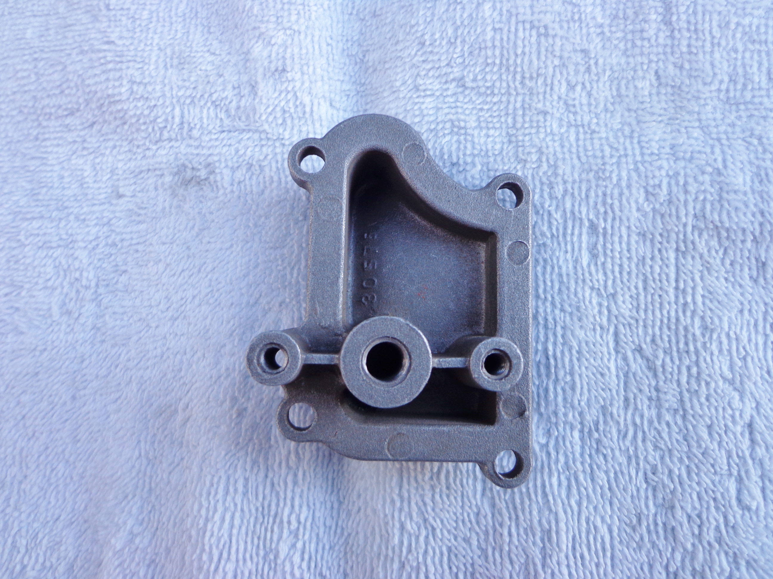

                The easiest way to mount a fuel pump would be to find a ’60-’63 bypass cover with the pump mount already made into it. A common small square pump as found on 9.9/15 horse motors will feed your ten no problem. These bypass covers came with either a high or low mounting point for the pump but it doesn’t make any difference which one you use.
                #76131
                  Good suggestion Mumbles. Didn’t even think of that solution. Was thinking about how I had to modify my 1954 5.5hp with no bypass covers. The bypass cover mod is the easiest way to go for sure.

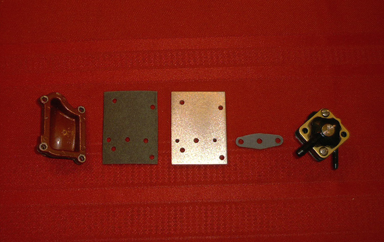

                    If you want to take the time to be creative, you can make an adapter plate to go over the existing bypass cover. I used to make some, but quit due to lack of interest.

                      I converted a five horse I had in for an overhaul (which included oversize pistons and rings) by drilling through the upper top and bottom exhaust ports. I used modified counter sunk headed screws inside the bypass to screw a quarter inch aluminum plate like Frank made to the side of the engine. I retained the 4 gallon tank, caping off the manifold pressure nipple and zip tied the hose to the starter support bracket on the intake manifold to act as an air vent. That way he always had the proper fuel / oil ratio for the five horse Fisherman. . . 😎
