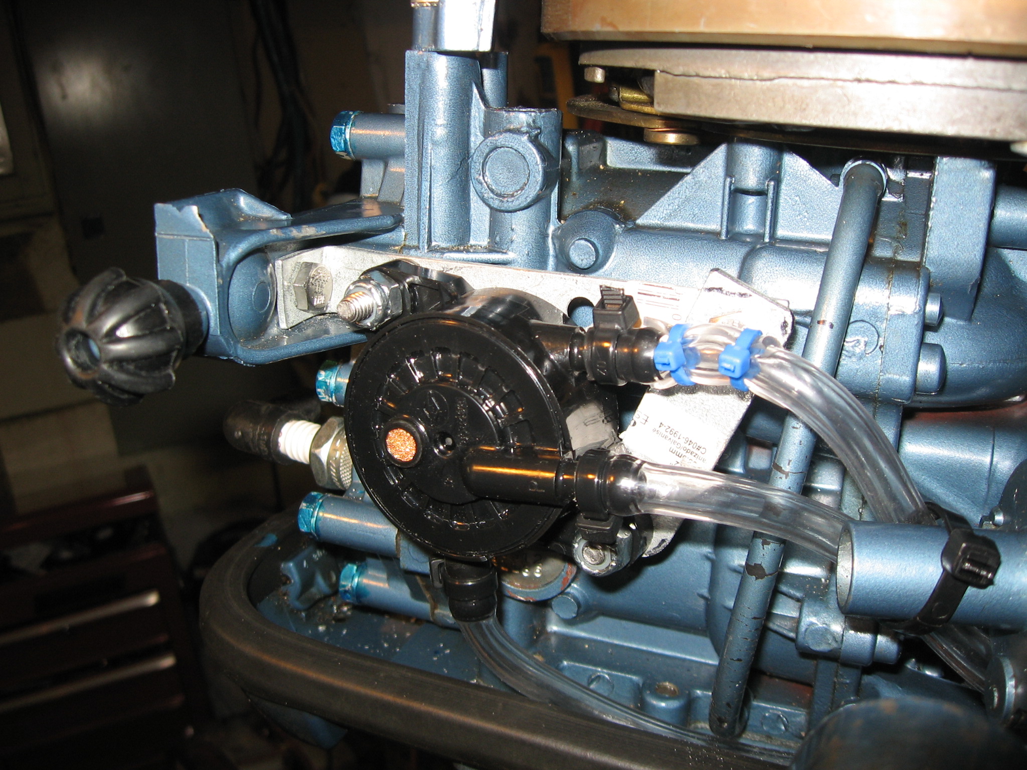

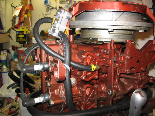

      Anything can be done. About fifteen years ago I mounted a small fuel pump on the side of the crankcase of a ’57 Evinrude 7.5 horse Fleetwin which does have bypass covers. This way it looked neat and you could swear it came from the factory with the pump. I used aluminum tubing threaded and epoxied to the crankcase and it hasn’t fallen off or dropped any pieces into the motor yet (knock knock). Unfortunately I don’t have any photos of it but I should pull the motor out and take some the next time I’m over at my storage place.

        I did it it….you can but first….locate a single line side connector
        the plate over the bypass is easy to do ….but do drill a hole in the bypass cover to allow pulse waves to reach the pump over the cover
        don’t forget if you do not use the pressure nipple method behind the carb just plug it with a piece of one inch rubber hose and plug it with a short bolt with a tye wrap
        https://www.youtube.com/watch?v=FtG4M7ye1N8 this method is ok but pump over the bypass cover is the best way to go (just my opinion) …if you can not locate a spare cover ready made to accept the pump.
        just cut up some aluminum plate, line up the holes drill & mount . make up a gasket install as shown between the cover and the plate
