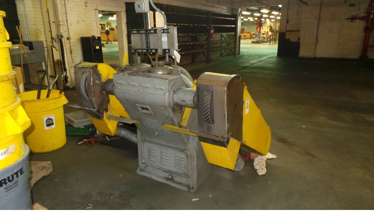

                Every hobby I’ve been into has had aluminum to
                polish and for well over 50 years of polishing that
                crap I’ve tried a bunch of polishes.
                The red (pink) polishes are some what abrasive to
                help smooth the surface to bring back a shine but
                you get the best (mirror) shine on a really smooth surface.
                This would be an example and the first I tried in the early 60’s.
                I have a buffer now and I’ve moved on. 😯
