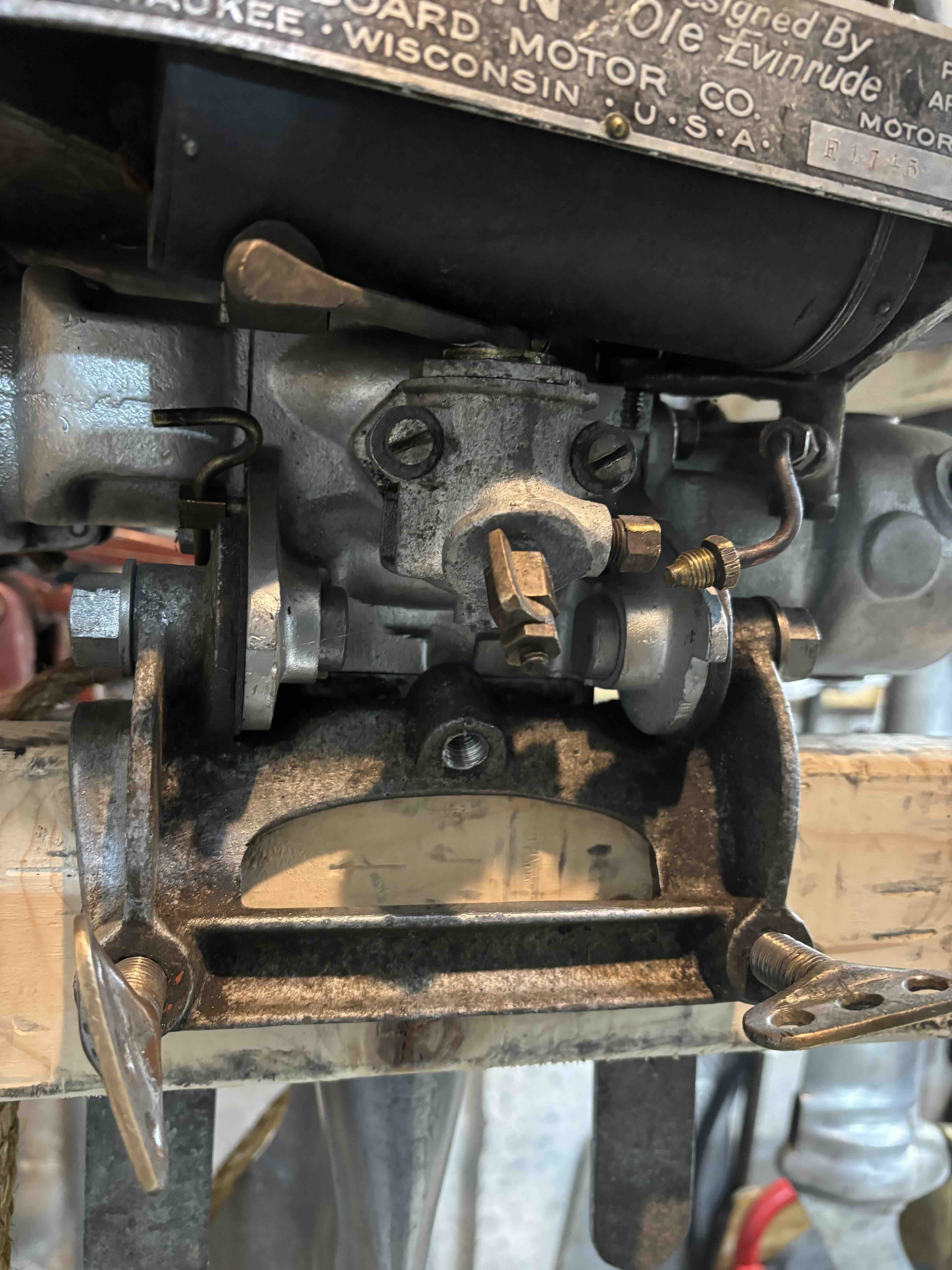

                    As you folks have mentioned… here are some more photos. Best I could get for right now, there are 4 green top Mercs that have been wedged in, blocking my full access to it.

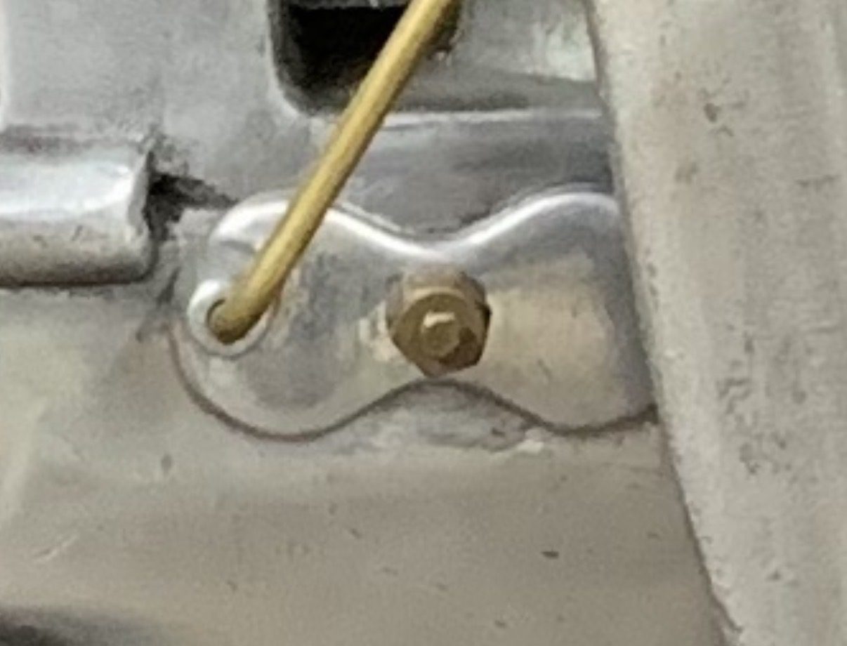

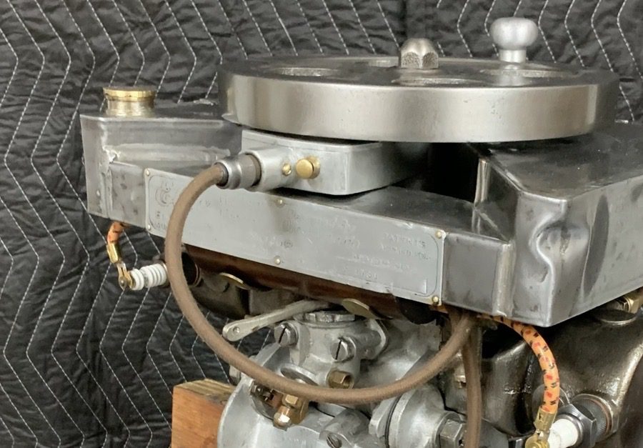

                        Everything in the photo you posted is correct for the F. It has the model F specific carb so I’m convinced this is likely an F wearing a 1922-23 fuel tank. The exhaust cut off on the side of the motor should look like a “peanut”. The timer should have wires out the front, but they were often changed to the newer style with the plug capped and the wires routed out the back. Photos below show examples.
                        IMG_9617
                        IMG_9618
                        So in short, you need a powerhead from a 1921 model F, 1922 (no letter designation) or 1923 model A. Lots of options. However, I would still try to free up the powerhead. You would be surprised how often they can be saved. It’s also easier to find a few parts than an entire powerhead. Good luck with your project.
