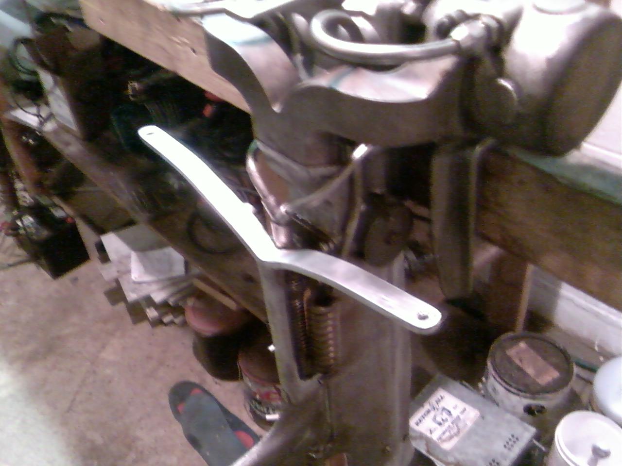

        My son came through for me. It wasn’t as bad as he thought with no volcanoes of dirt popping up. I’m not sure of year or model but it has 4 holes and a hollow rudder.
        #50276
        wbeaton
          It looks great, slim. I can’t tell where it was welded. Usually cast aluminium welds ok.

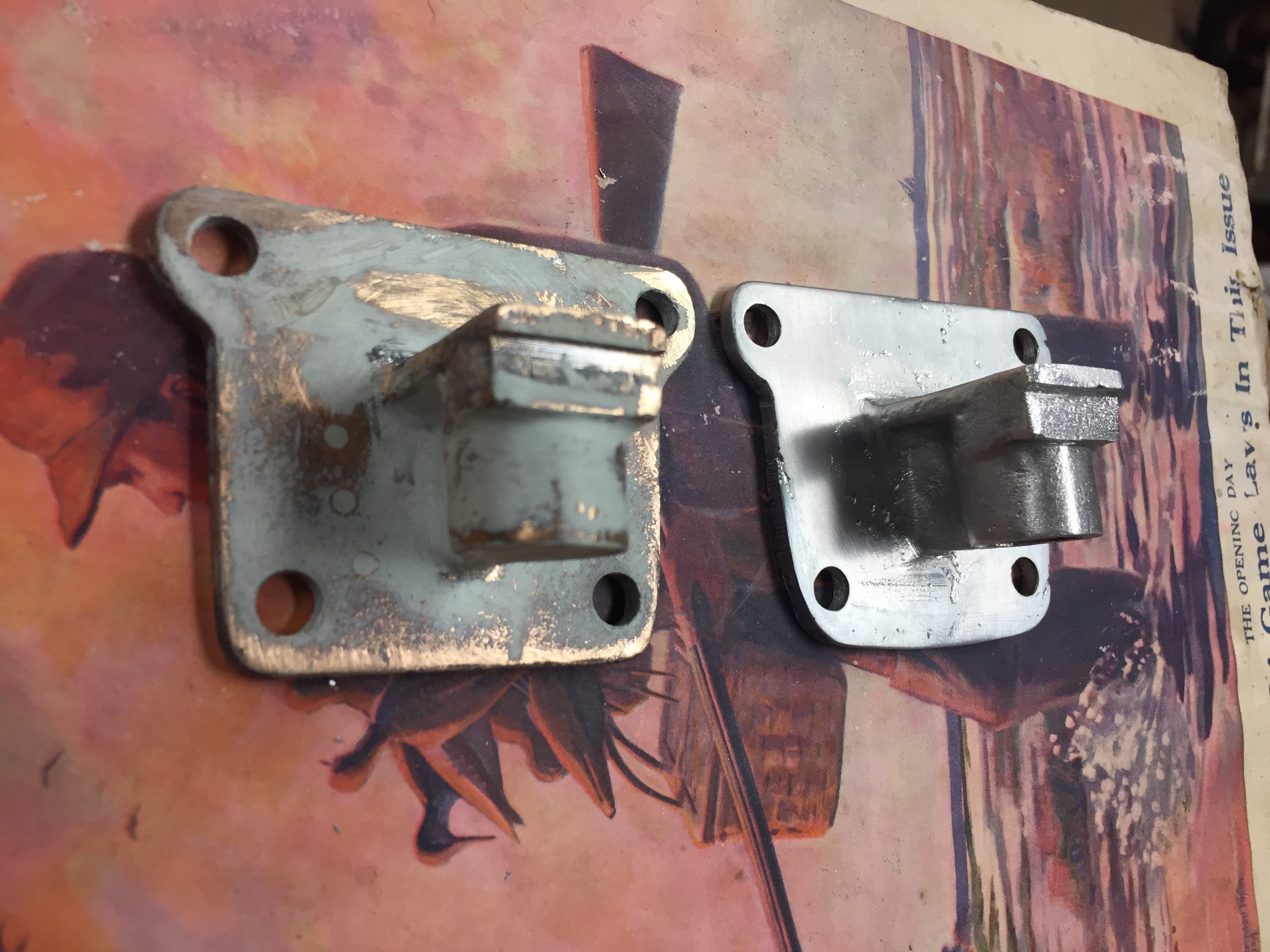

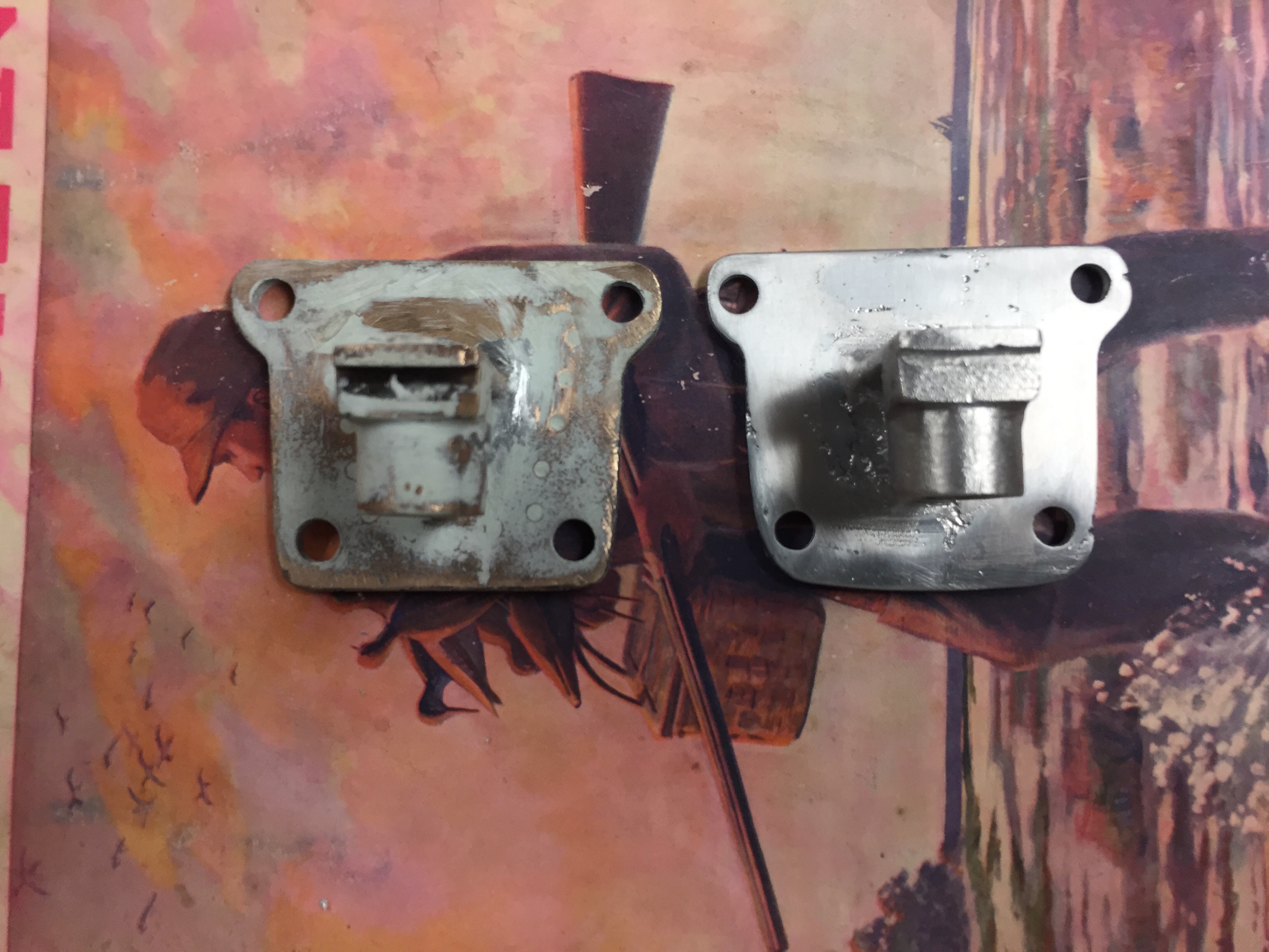

          #50750
          wbeaton

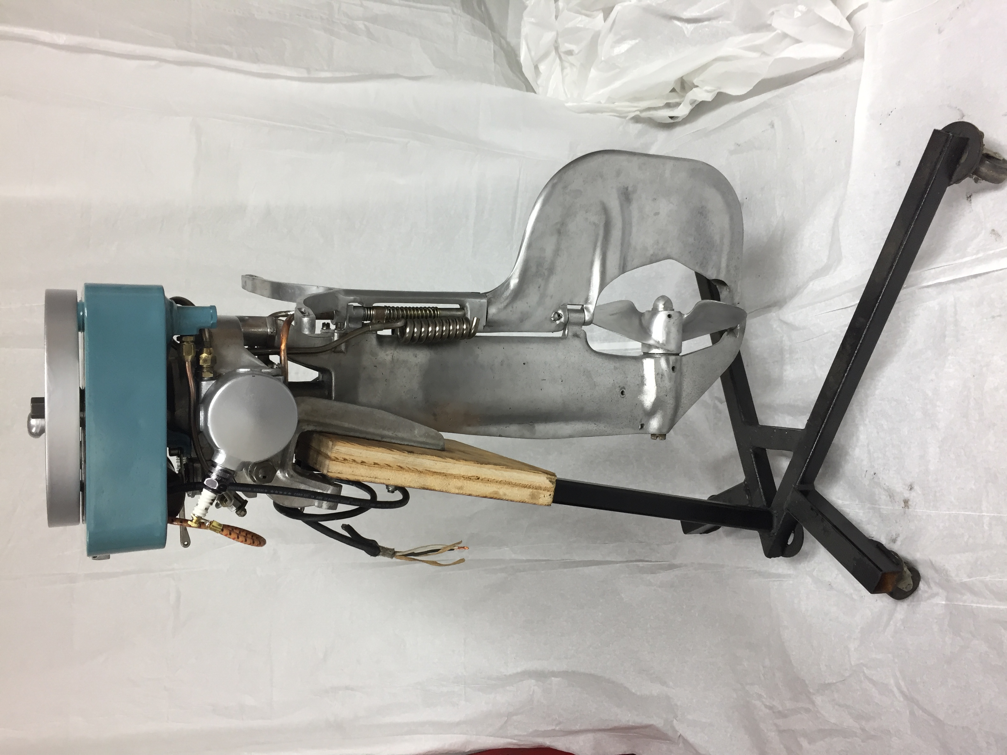

            I sandcasted a new mounting bracket on the weekend. I removed 1/2" from my incorrect bracket and soldered it back together. I used aluminium instead of bronze because I didn’t want to nickel plate it. Can someone please tell me how many exhaust relief holes should be in the bracket or post a photo of one that shows the holes? Thanks.

              #50755
                you cast that???? dang
                #50762
                wbeaton
                  Thanks, Richard. I was disappointed that the casting didn’t turn out as good as usual so I’m pleased that you like it. It fits perfectly. I’m happy with this solution.

                  #50763
                  chris-p
                    Looks great Wayne! That kiln is really coming in handy lately.
                    #50765
                    wbeaton
                      Thanks, Chris. The foundry is awesome. Its great being able to make or reproduce your own parts. What is the diameter of the prop on your Ruddertwin? Mine is 9" and sometimes hits the rudder. Nevermind. I got it sorted out.

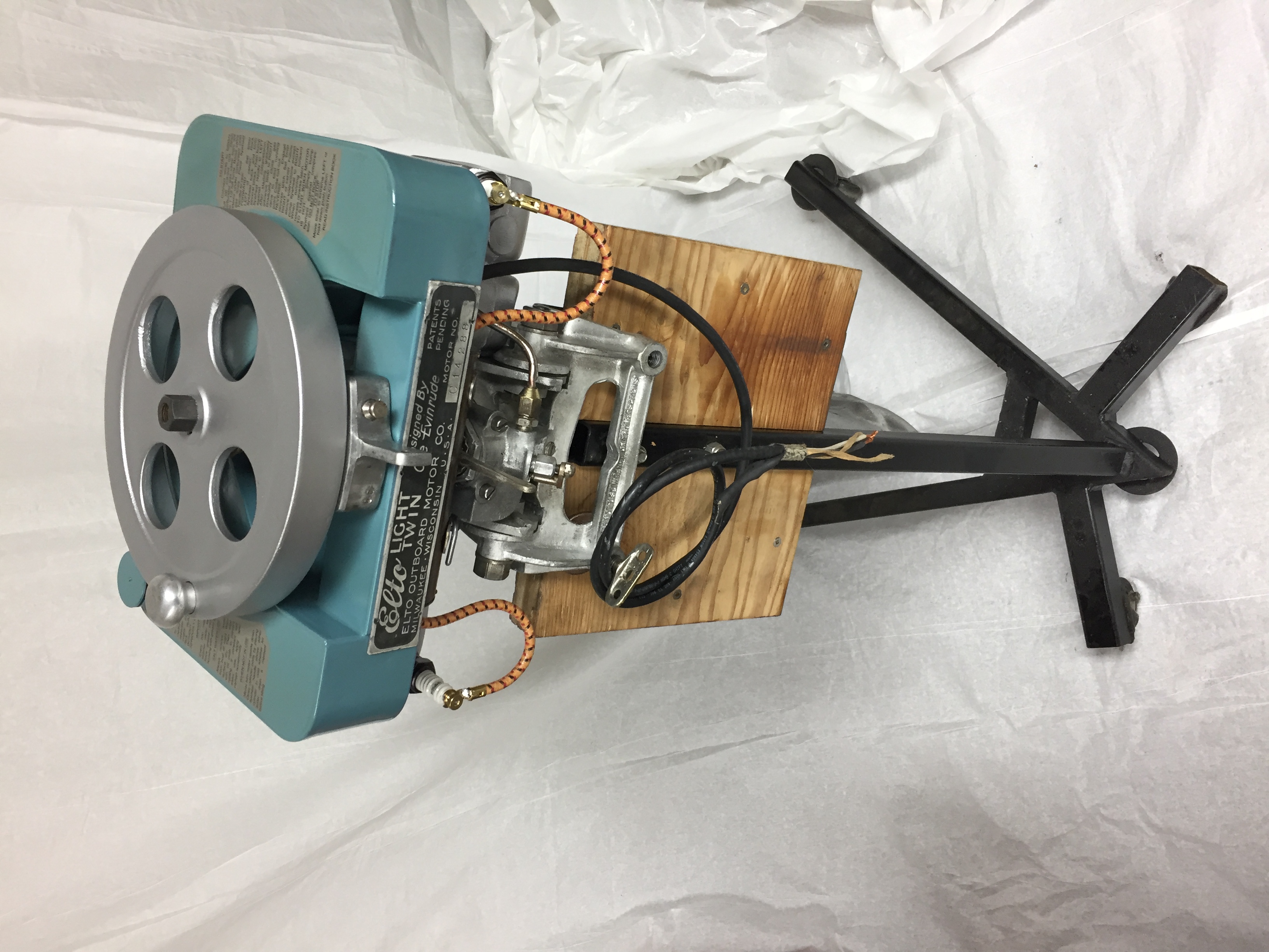

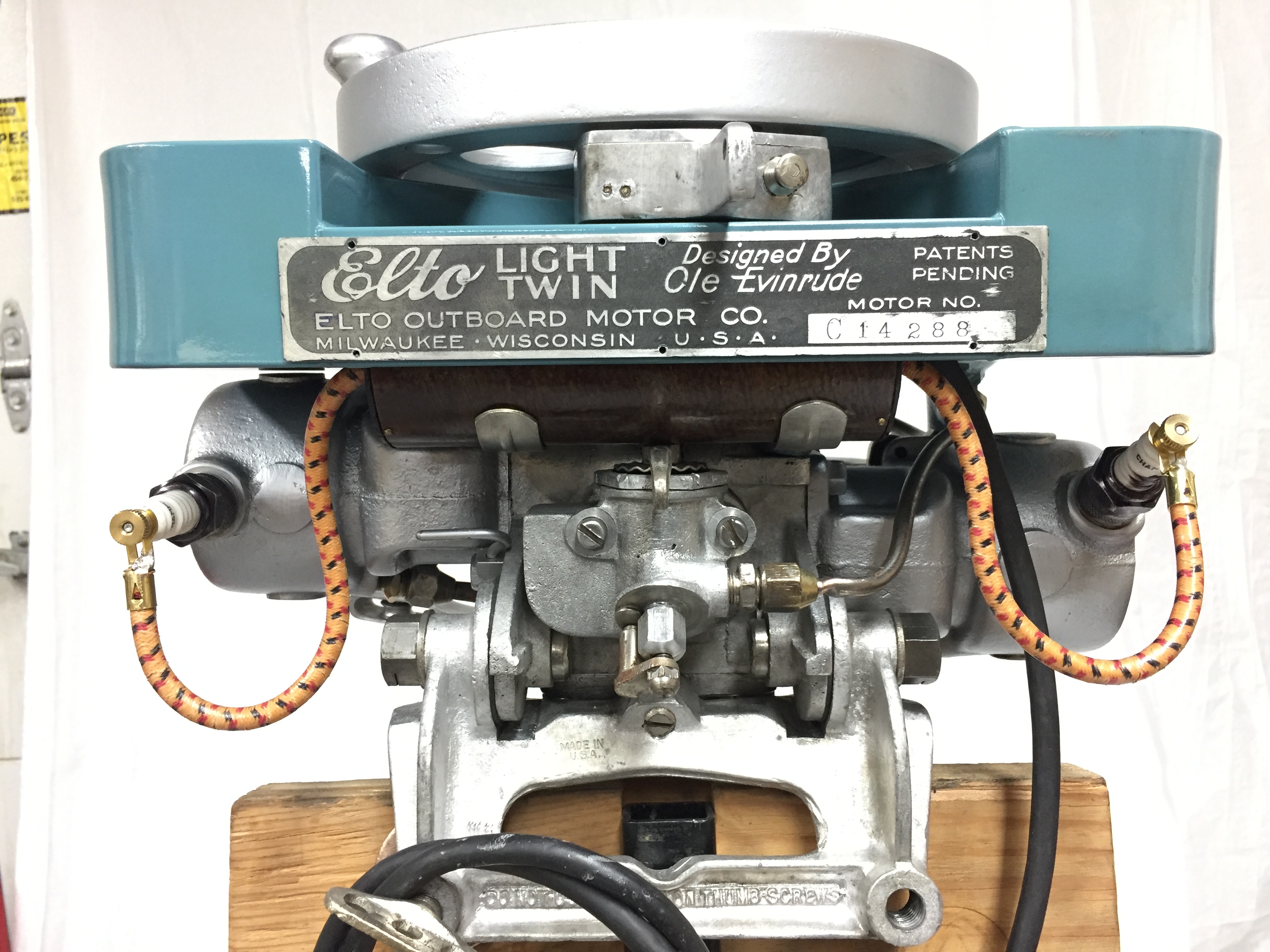

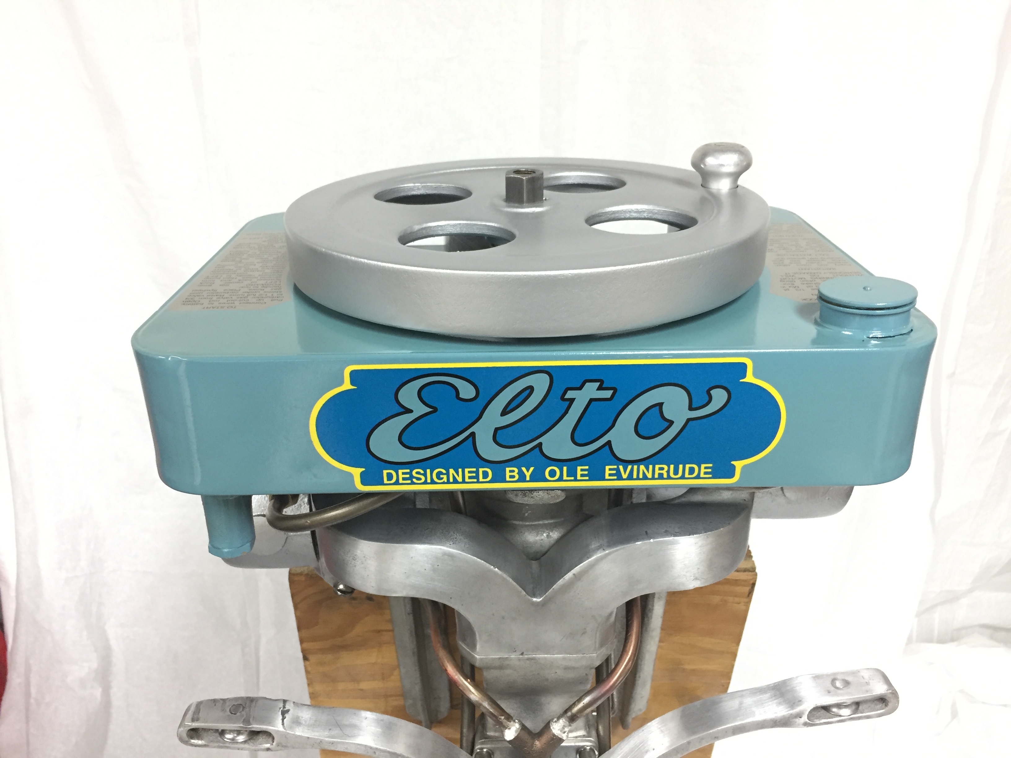

                      #51246
                      wbeaton

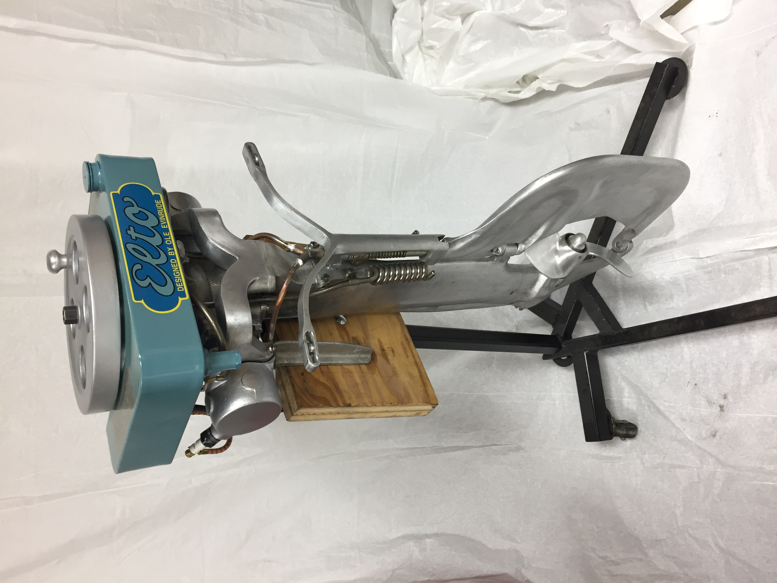

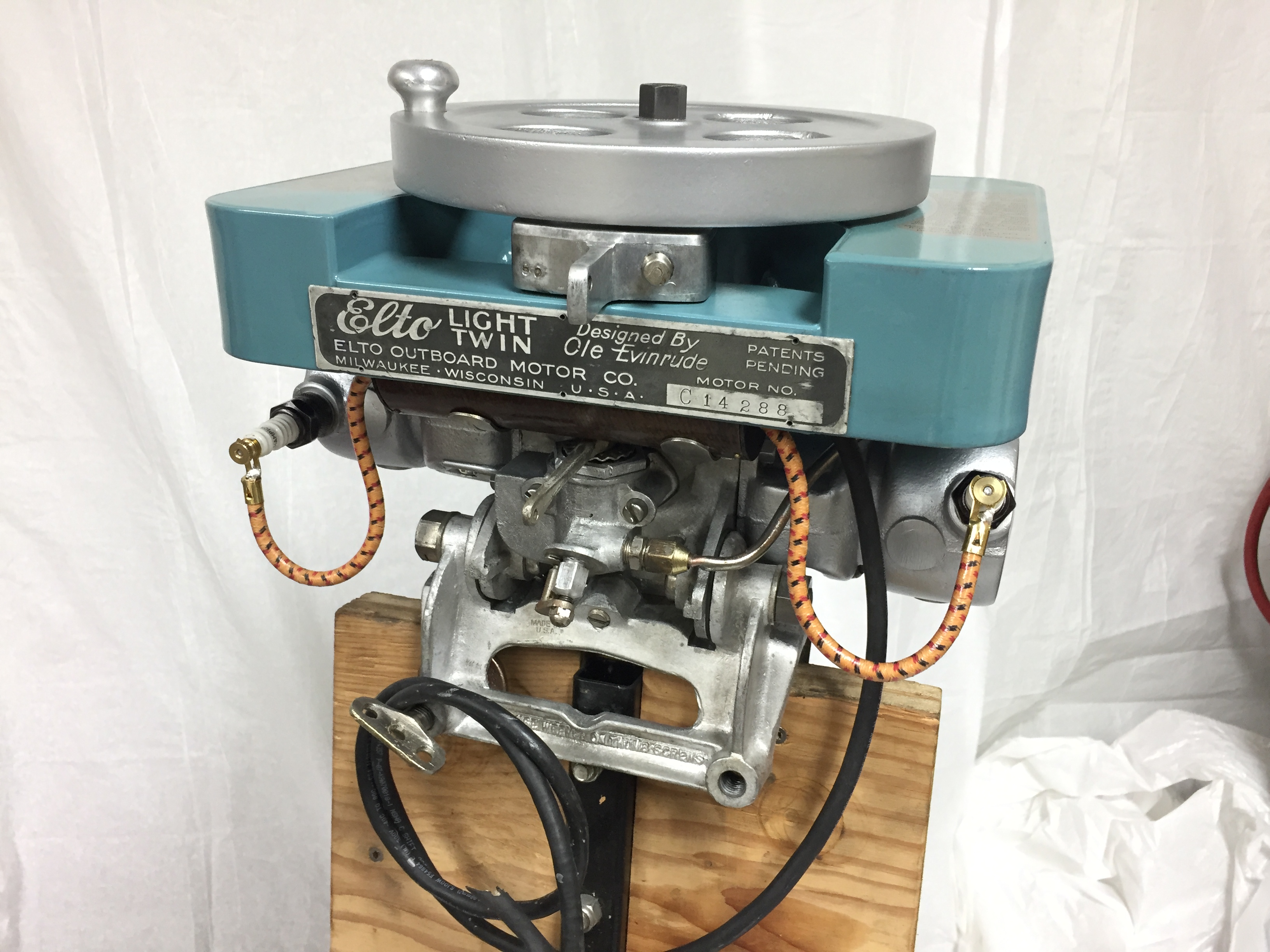

                        The resurrection of the Ruddertwin is almost complete. I’m missing three parts. I am on the hunt to find them. If I can’t find them I will try to make them. One piece is the exhaust cut-out mechanism. I have some photos of the outside. Does anyone have a photo of the inside of the mechanism? I don’t know what it should look like.
                        Thanks for all the help so far. Here is where all your help has gotten me. Sorry if the incorrect colour offends anyone.
