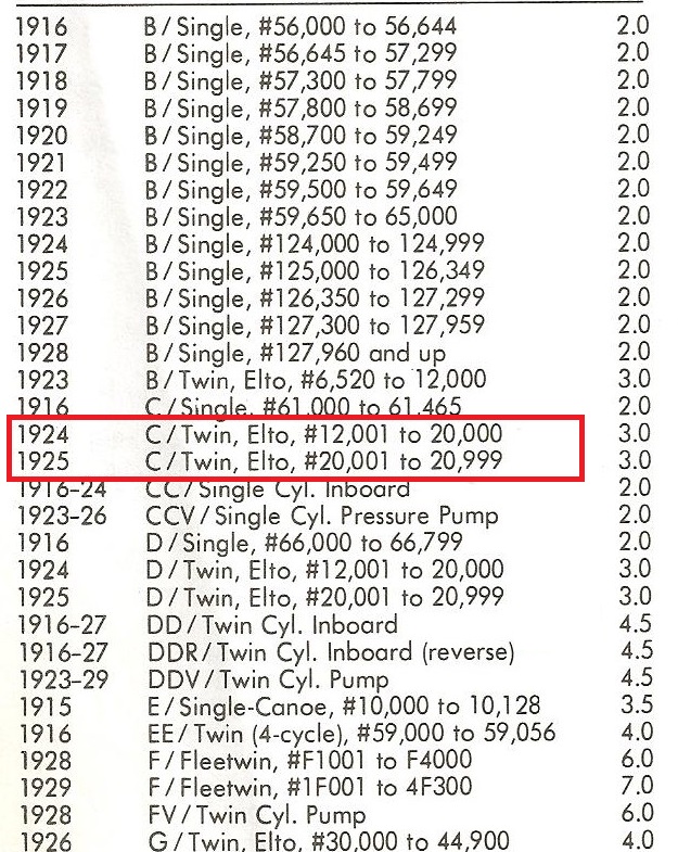

      OK, I do remember having a "D" with this type of top but it did have the small spring rivited thru the top. An Early Elto parts book does list a complete carb change at SN 20,000 and a part change at SN 20200 and the description of parts match up so this must be it . But no mention of the ball bearing."C" &"D" SN’s run from 12000-30000. Jim Ross.
      #53686
        And mine is like yours Tubs[/color][/size][/quote]
        quote Richard A. White:
        quote Tubs:
        That is a typo, should extend to 29,999. Mine is serial # 23336
        #53696
        hotrod
          After this discussion, I’ve decided to remove the metal ball since it apparently doesn’t belong in there. Also, if the cover is removed while on the motor, the ball will drop out – ending up inside the carb and then inside the powerhead. Thanks all.
          #53720
            29,999 for 1925 makes sense since 1926 starts with 30,000. At that time Johnson had built 30,560 outboards. . . 😉
