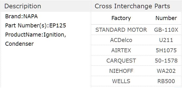

      your coils are fine with those readings, everyone I know down here in Florida uses these condensers,go to Napa EP-125 they’re under three bucks apiece… 😉
      #50116
        Thanks for posting that Echlin P/N Randy. Here’s some equivalent caps from different manufacturers.
        #52284
        lawnlawn
          All,
          I settled on the NAPA part number #EP125. When tested, it is .3 Microfarad which is the rating that is recommended for the 1929 V-45. I needed two. I wish all of these condensers were marked and put in the specs of the auto parts companies. I had to test and order a few before I got a .3 one. Both were installed and after two pulls, amazing, it started and ran!!! Can’t wait until Spring when I can get this one motor on the water.
