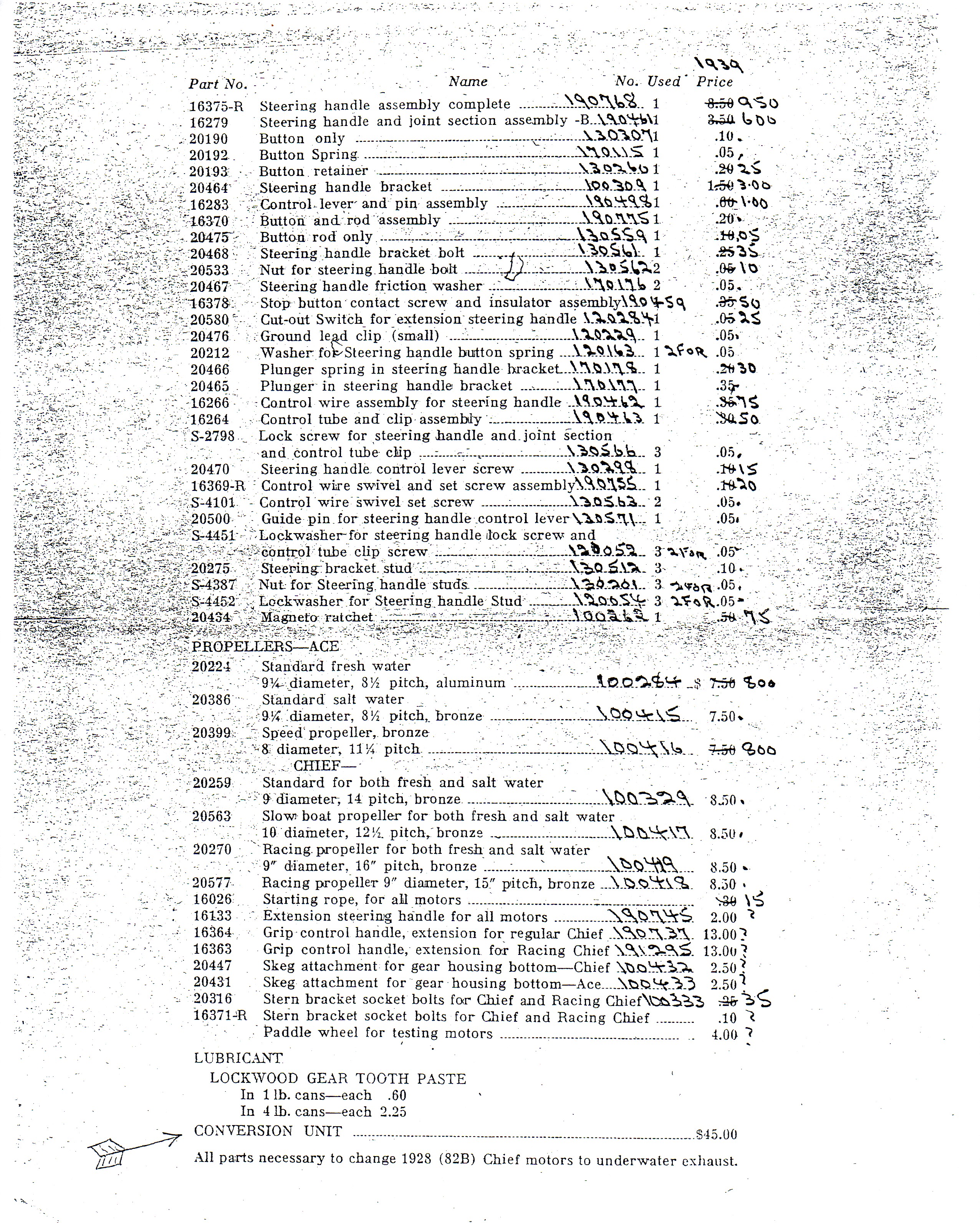

        Parts list from 1929 Lockwood booklet. Note item at very bottom of page.

              "Gear Tooth Paste" ??? 😆 😆
