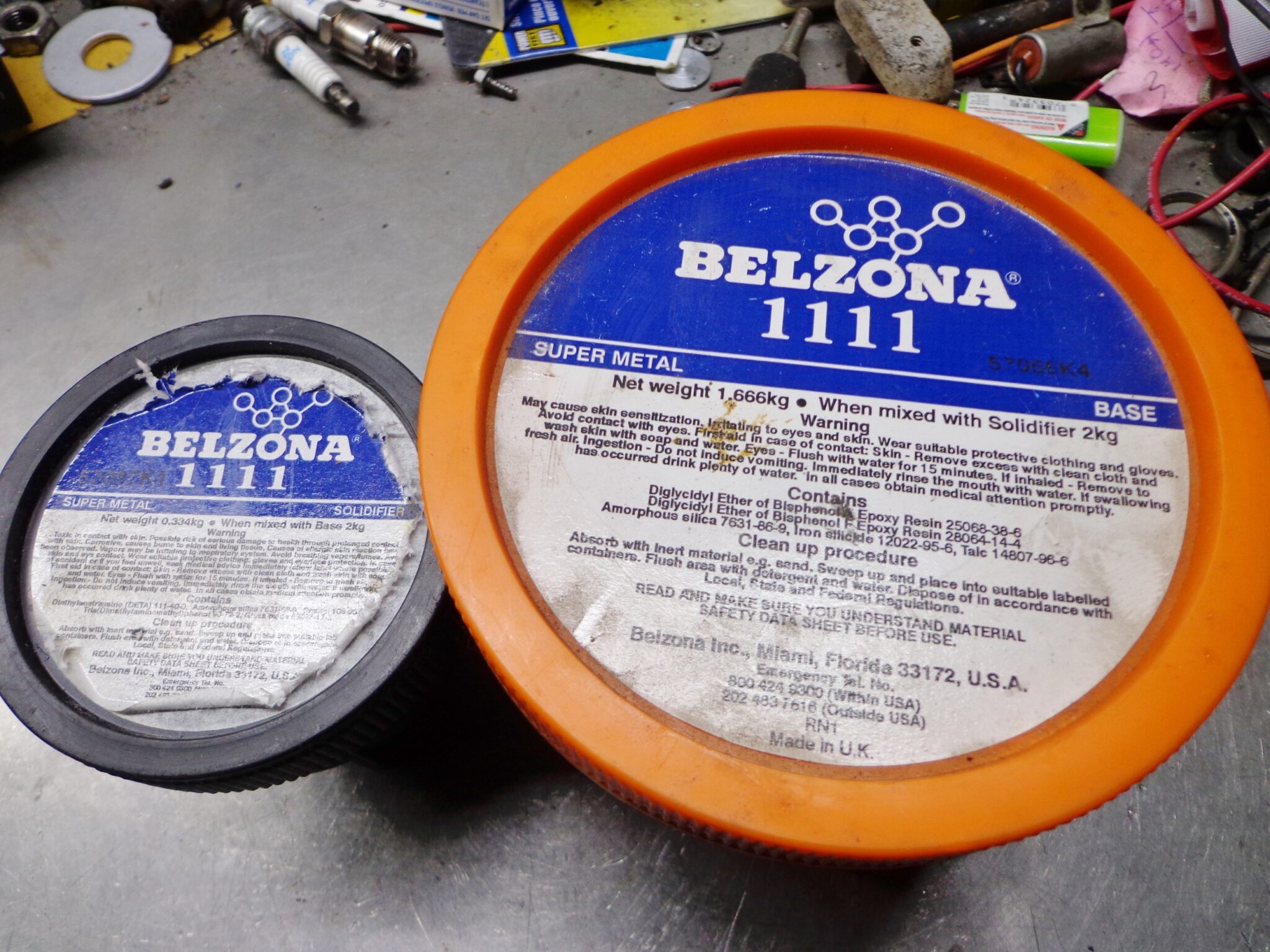

                  Did you consider using Belzona for this repair? It’s as tough as nails and has saved my bacon many times!
                  #245150

                      #245166
                        Belzona products are a line of super tough epoxies used for repairing just about anything. It’s expensive but leaves JB Weld and Marine-Tex epoxies in its wake!
                        Here’s some info on the Belzona 1111 which I use.
                        https://www.belzona.com/en/products/1000/1111.aspx
