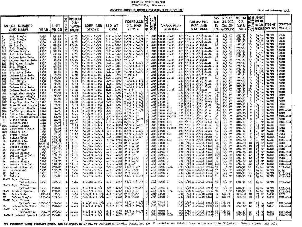

            #263389
              A little hard to read but my copy of the Champion motor specs (attached here) for the S1E shows the points at .015 and the plug gap at .027.

              #263395
              ml_mcm
                bobw,
                If I have a bigger gap but still see a good spark could the results be what I’m seeing?  A sputter every once in a while. I don’t have any experience with cause and effect on gap size.  I do have a lot of experience taking this flywheel off I can do it in my sleep
                ML
                #263397
                  That could be your issue.  On my ’37 Champion, I initially had the points gapped a little too wide but still had what appeared to be a good spark at the plug in open air.   But I couldn’t get it to fire off and run until I reset the points to the specified gap.   The starting instructions also say to advance the timing lever slightly to the right of center, but on mine I had to move it a lot further to the right before it would start.   Every motor is probably a little different but you might try that on yours as well and see if it will fire up.
