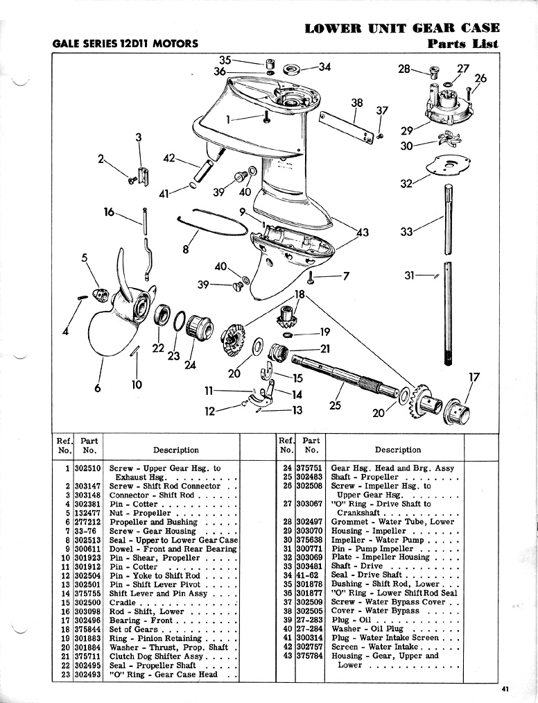

August 21, 2017 at 5:30 pm #63589Hi again everyone, took her out and she performed well. At first a little rough but I had to tilt the motor to compensate for the weight. I have a new problem, it leaks gear oil. Are prop shaft seals universal? Below is what I’m trying to get, not the whole thing but just the seal part that pops out. Any help is appreciated.
Thanks,
August 21, 2017 at 7:57 pm #63600O-ring #23 – 302493 or Sierra 18-7112
Seal #22 – 302495 (very expensive)
One member makes a real nice replacement seal for that, another member (might still) makes a bushing for that, that allows you to use a smaller less expensive seal 302545>313284 or Sierra 18-2005
Diagram compliments of Garry’s DropBoxAugust 22, 2017 at 4:38 pm #63643Make sure you replace the shift shaft o ring while it’s apart they seem to leak. Glad you have it running a again

turned off?August 22, 2017 at 6:26 pm #63646Thanks for the help, now to find some parts. About every marine/boat shop around here stopped me at "Its a 1954.." I’m not too concerned about price as this is my only outboard and I want to fish this weekend. Still thinking of ways I could fabricate my own just in case.
August 22, 2017 at 7:53 pm #63651A search at the original manufacturer’s site (Chicago Rawhide, now SKF) crosses the 302495 seal to SKF 6280, which is available at places that sell seals – not marine dealers.
Here’s the lookup site:http://www2.chicago-rawhide.com/popup_p … 457012.htm
Here’s where it takes you giving specs on the seal:
http://www.skfextranet.com/Catalogs/457 … asp?s=6280
and here is one of many places to place to buy them if you run a websearch on SKF 6280:
https://www.amazon.com/SKF-Small-CRWA5- … B002ERWYOC
DaveAugust 23, 2017 at 2:46 am #63667Thanks Dave, just ordered one. Beats getting a $30 one thats been sitting in a garage since the 60’s.
