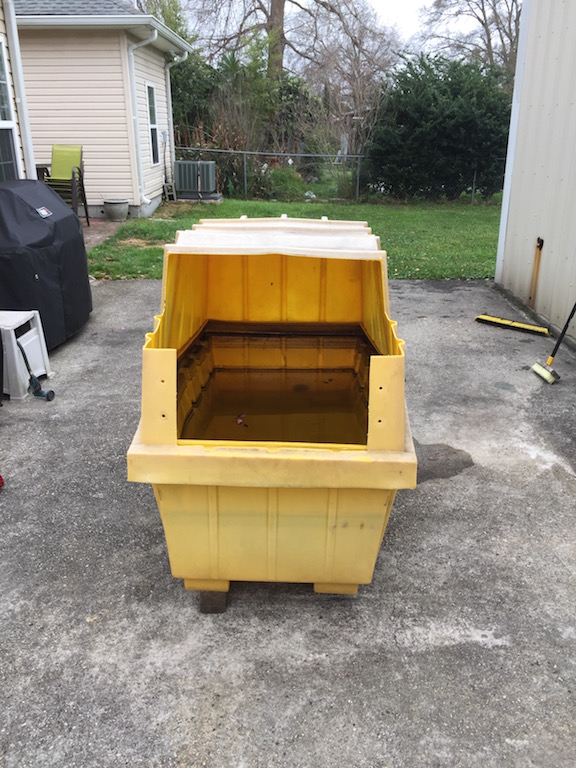

          I had some time over the weekend and got this beast to run, and to run fairly well.
          I have not had the time to look at the old jet, but hope to do that soon.

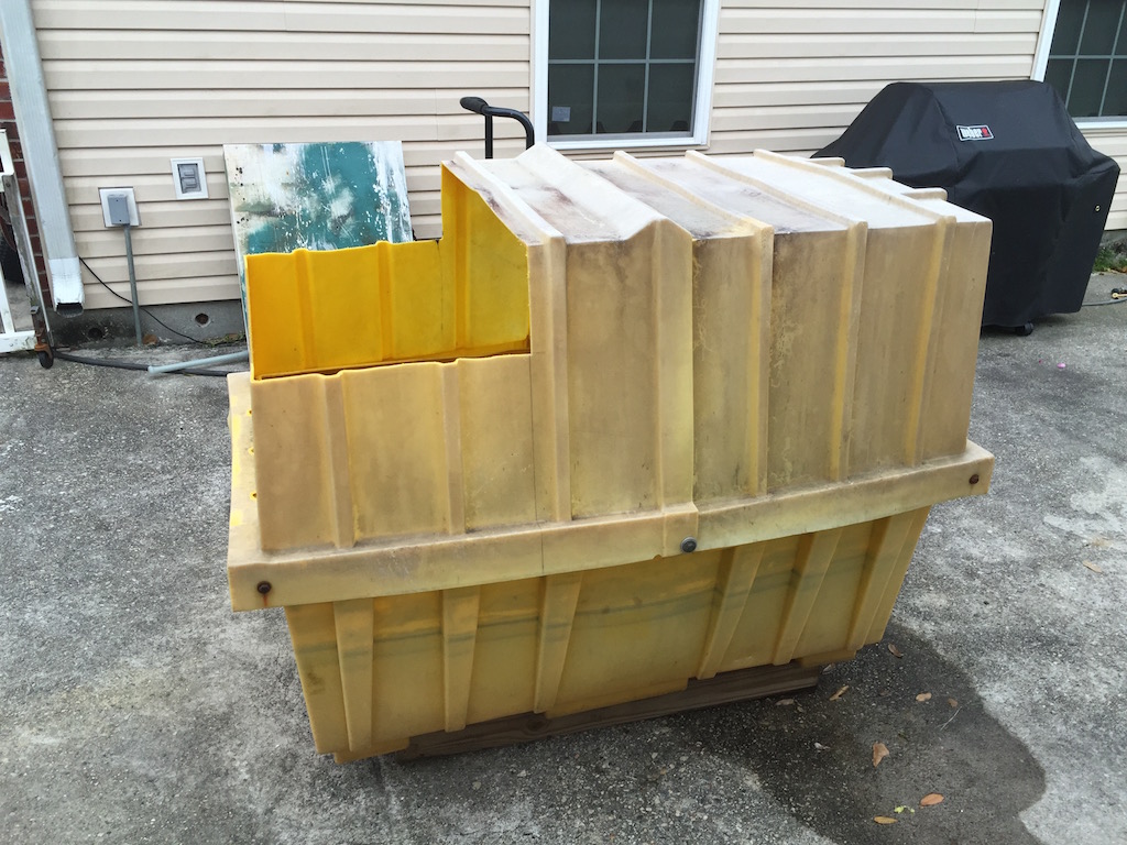

          Only issue I have now it that I am not sure it is pumping water. I got rid of just the bucket and modified an old storage box thing I have had for awhile (See pics).
          I know it is supposed to be like a mist while at idle, and then a nice stream out when more throttle is applied. I have looked over the Impeller and other parts, not much to them and all of the inlet holes are submerged and I also took the pipe off and blew out ever cooling hole with air and could feel and hear it come out of the exhaust outlet.
          Not exactly sure if these pump well in a tank???
