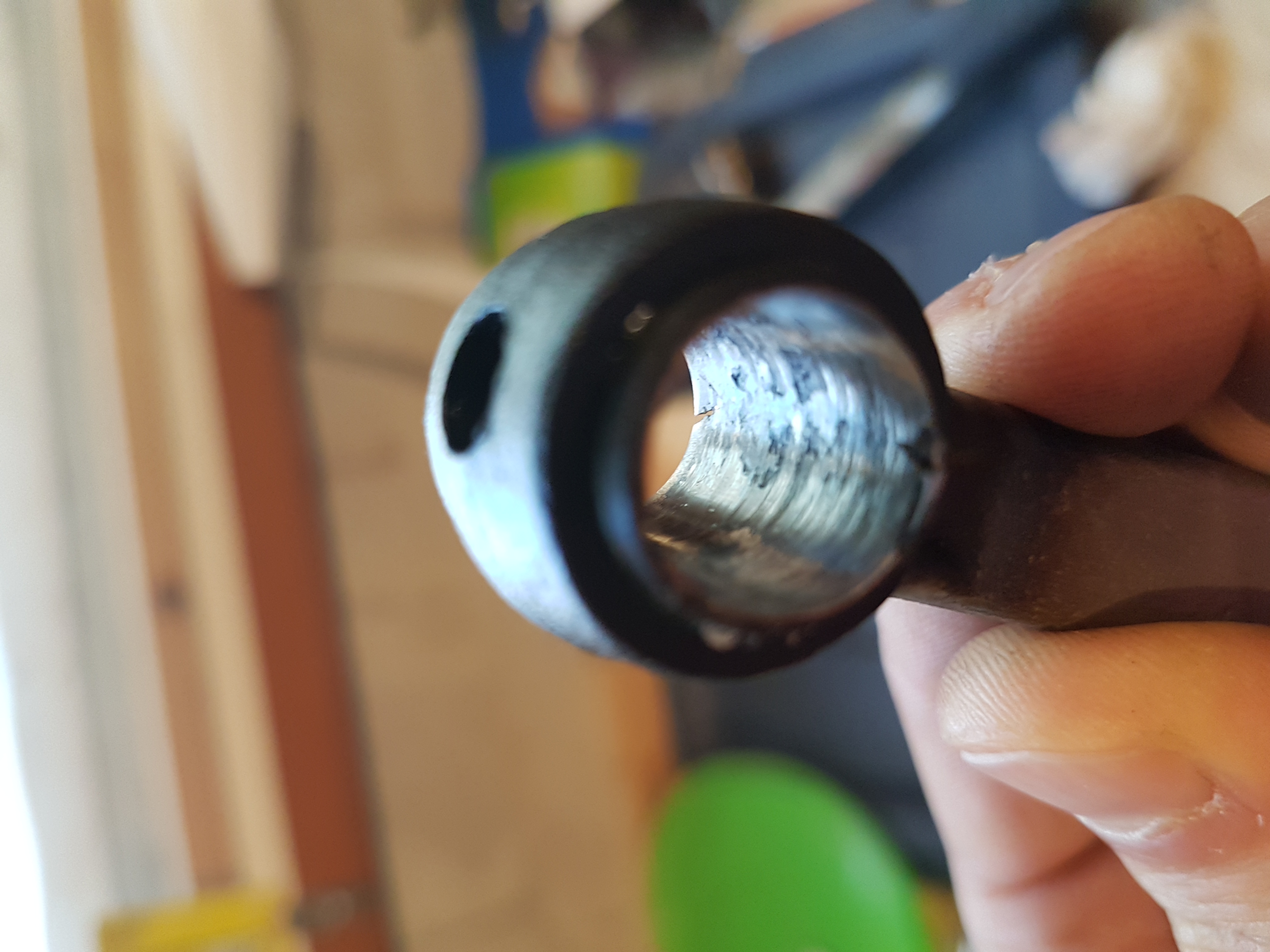

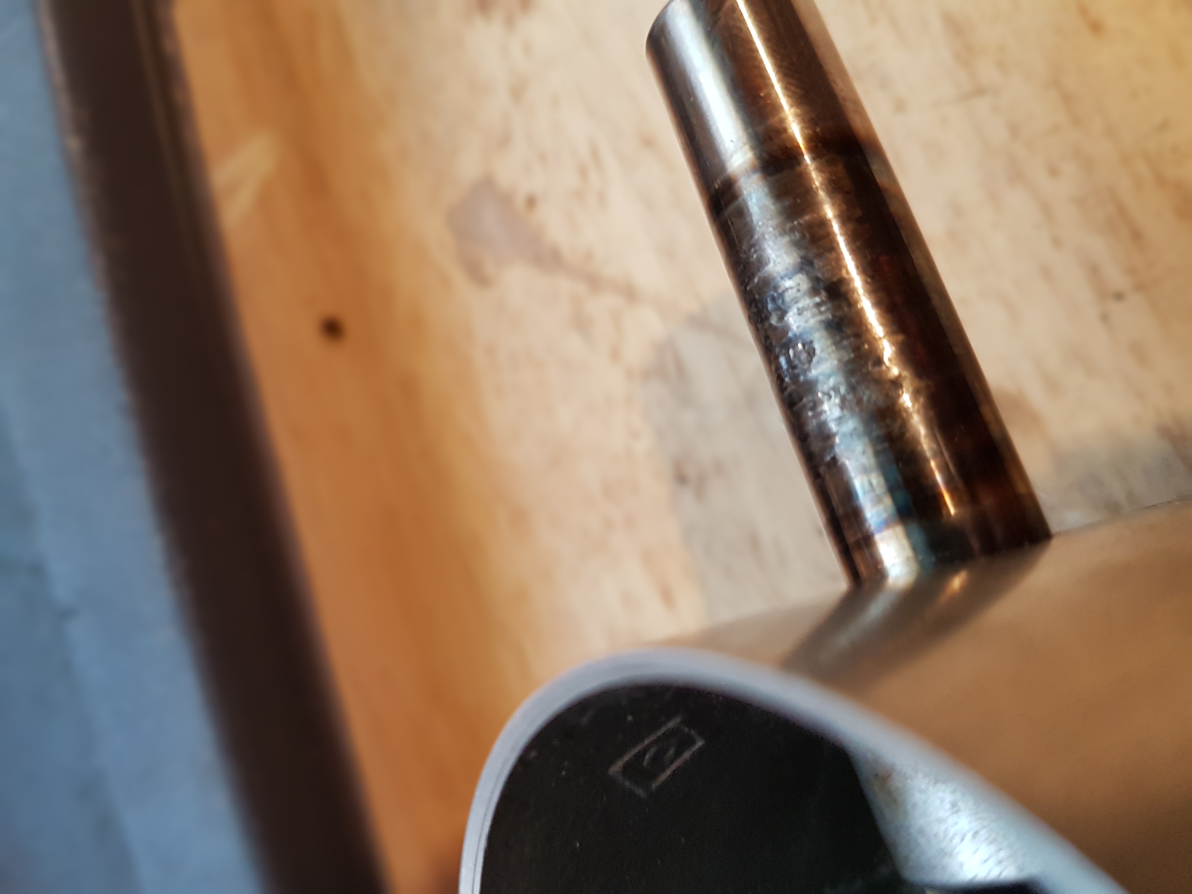

I’ve run into a bit of a hiccup restoring my grandfather’s old QD-12.After disassembly I noticed a great deal of play in one of the connecting rods…up/down, side/side and every other which way. Pressing out the wrist pin revealed this:
Might be kind of hard to see, but there is some pretty serious pitting and grooves worn in both the wrist pin and connecting rod…the brass(?) bushing in the connecting rod end is completely worn through in spots. There is a hole in the bushing and a hole in the connecting rod end that I’m assuming are supposed to be lined up for proper lubrication…they weren’t. 😕 has anyone seen anything like this before? The other piston/con rod seem totally fine.
Anyways it seems that the solution is a new con rod and wrist pin…
After digging up the part number I found the following con rod.
http://www.ebay.com/itm/375595-Connecti … 43b0b57d20
It’s listed as coming out of a QD-10, but the parts catalog lists the same part number for all QD motors, so I’m assuming they are all the same. Just wanted to verify with someone before I order the wrong part! He does have 2 rods available…would it make sense to replace the good one as well just for the sake of consistency?
Anyways, any thoughts or advice would be appreciated! I was very excited to find this thread – great resource!

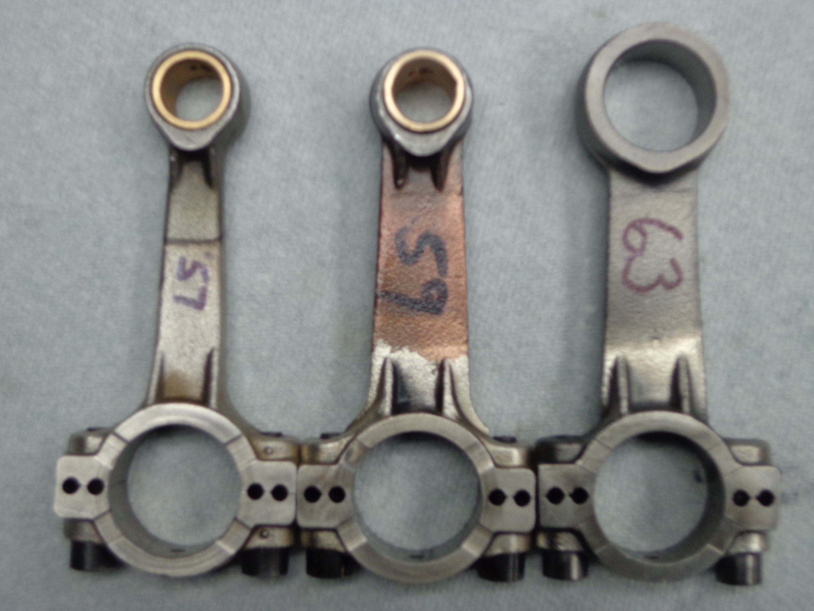

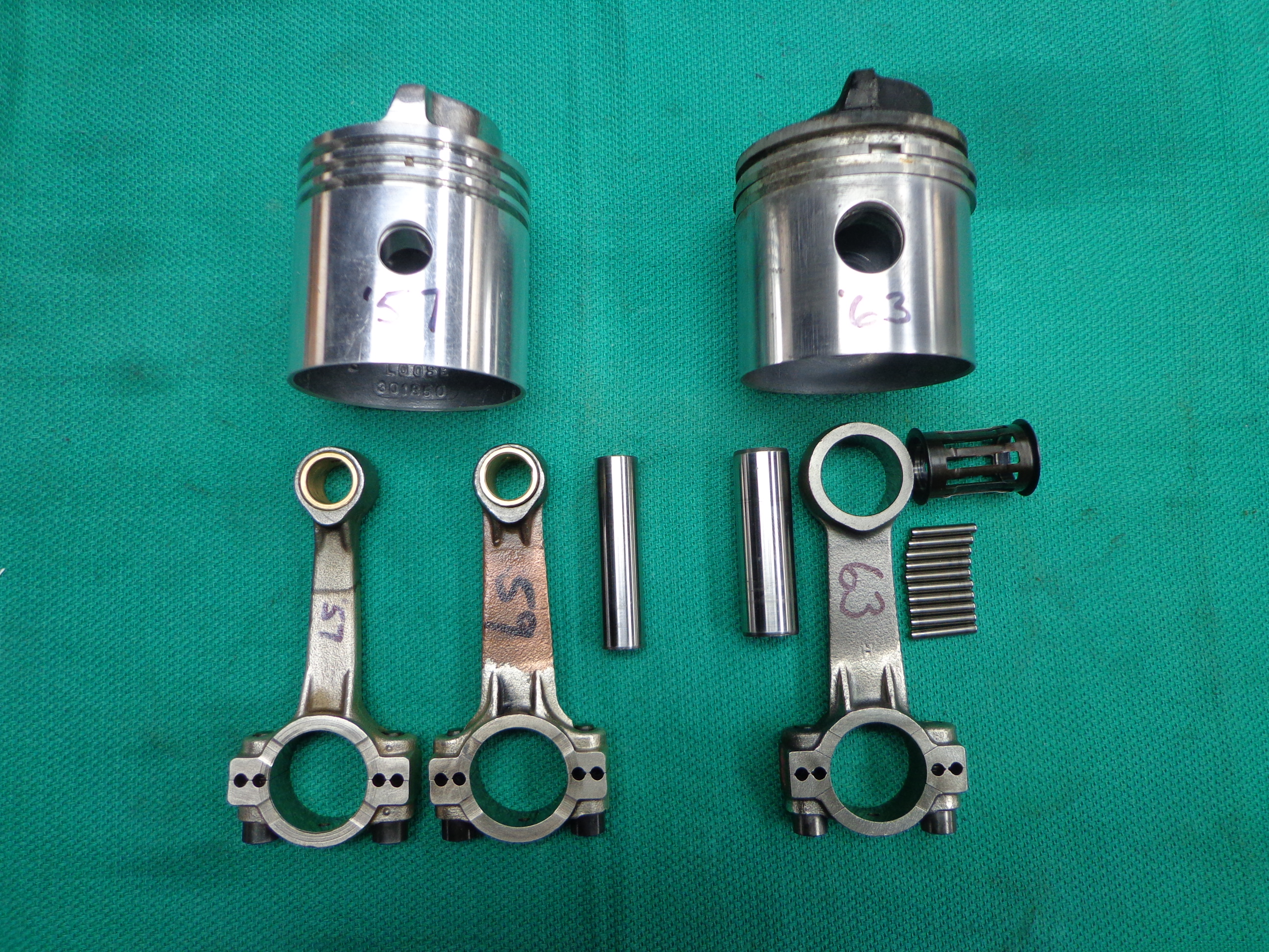

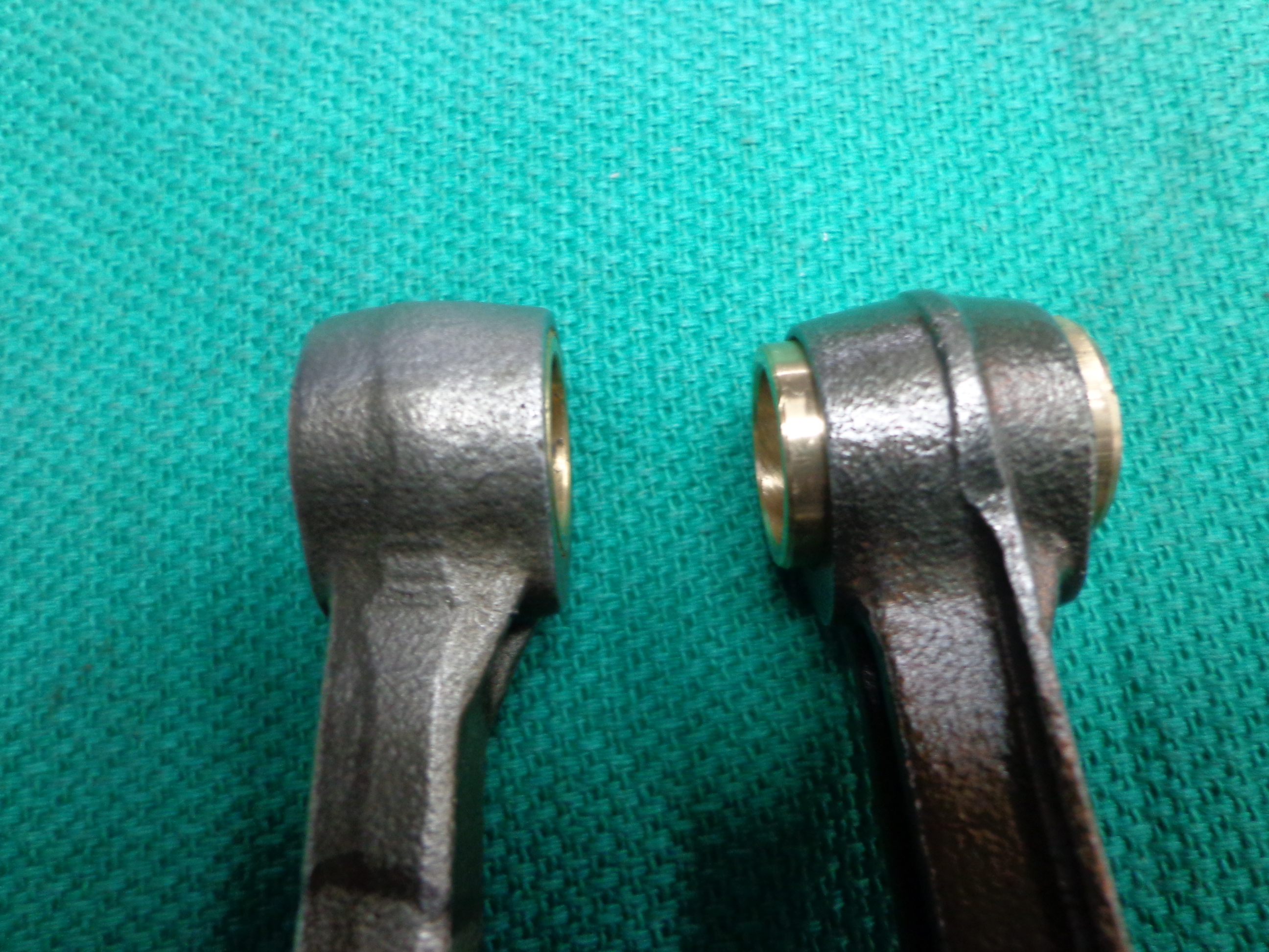

April 25, 2017 at 4:16 pm #56648Hi ggauld, you should start a separate thread with your question as this original one is getting old now.
The QD rods started to change around ’59 with a wider beam and bushing at the small end to help prevent the wear you are seeing. The wider bushing might not fit between your pistons pin bosses without being ground down. ’61 to ’63 QD rods are totally different and must be used with the matching pistons. Any rods from ’58 and down should fit your pistons.
Before the later needle bearing rods, the bushings were known to wear out and would make for a noisy running motor. If the pins are still serviceable, new bushings can be made for the rods.
April 26, 2017 at 2:07 am #56669Holy smokes, what a difference in rod construction!
