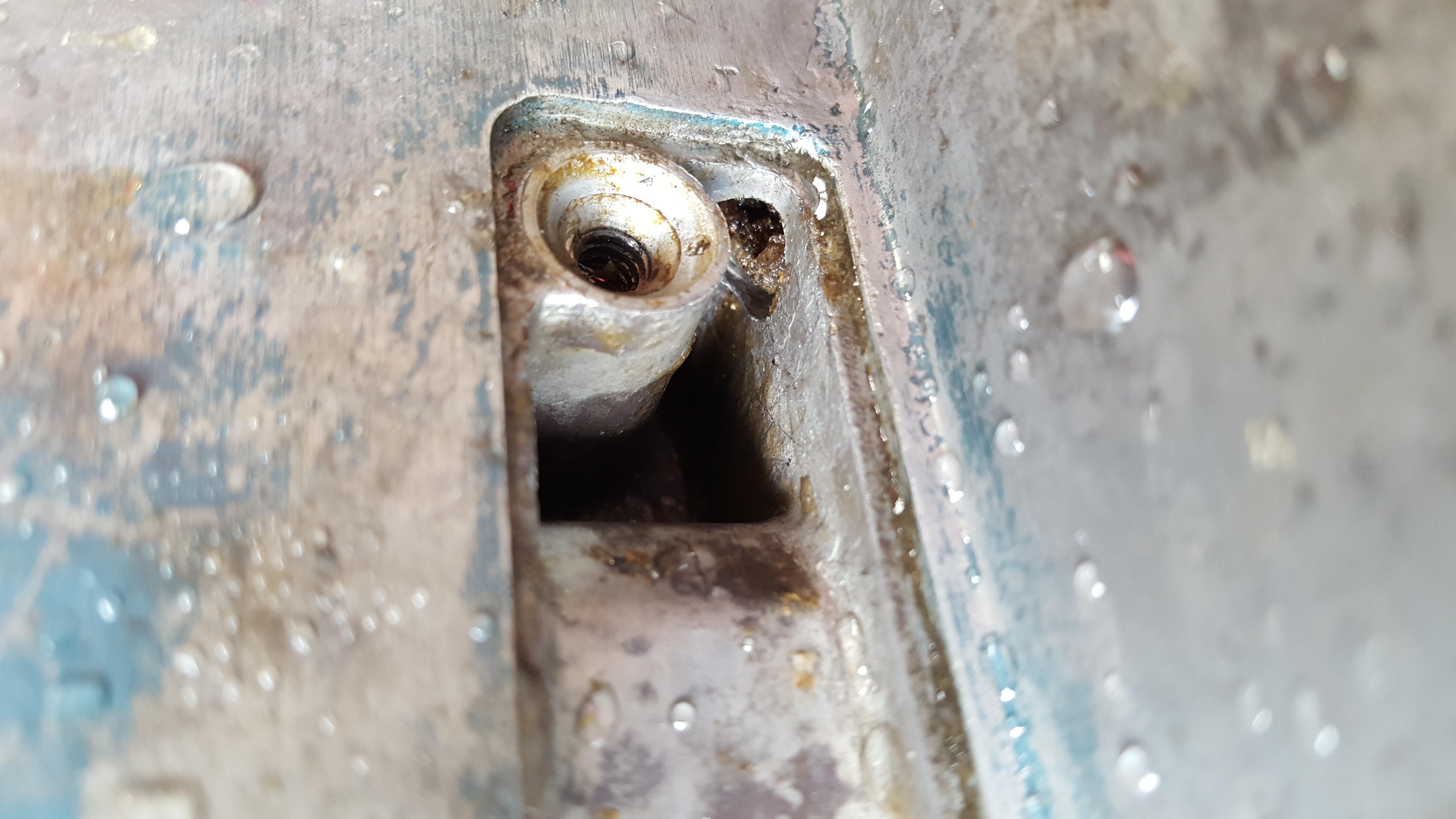

      Also, the whole inner of the lower unit is almost solid rubber, except for a cross shaped channel that the driveshaft fits into. Can’t remember if it’s in this post or a video I watched, but one guy said there is a hole just below the carb adjustment where water spits out. I don’t have a hole there either. Is it possible that the water spits out w the exhaust under water?

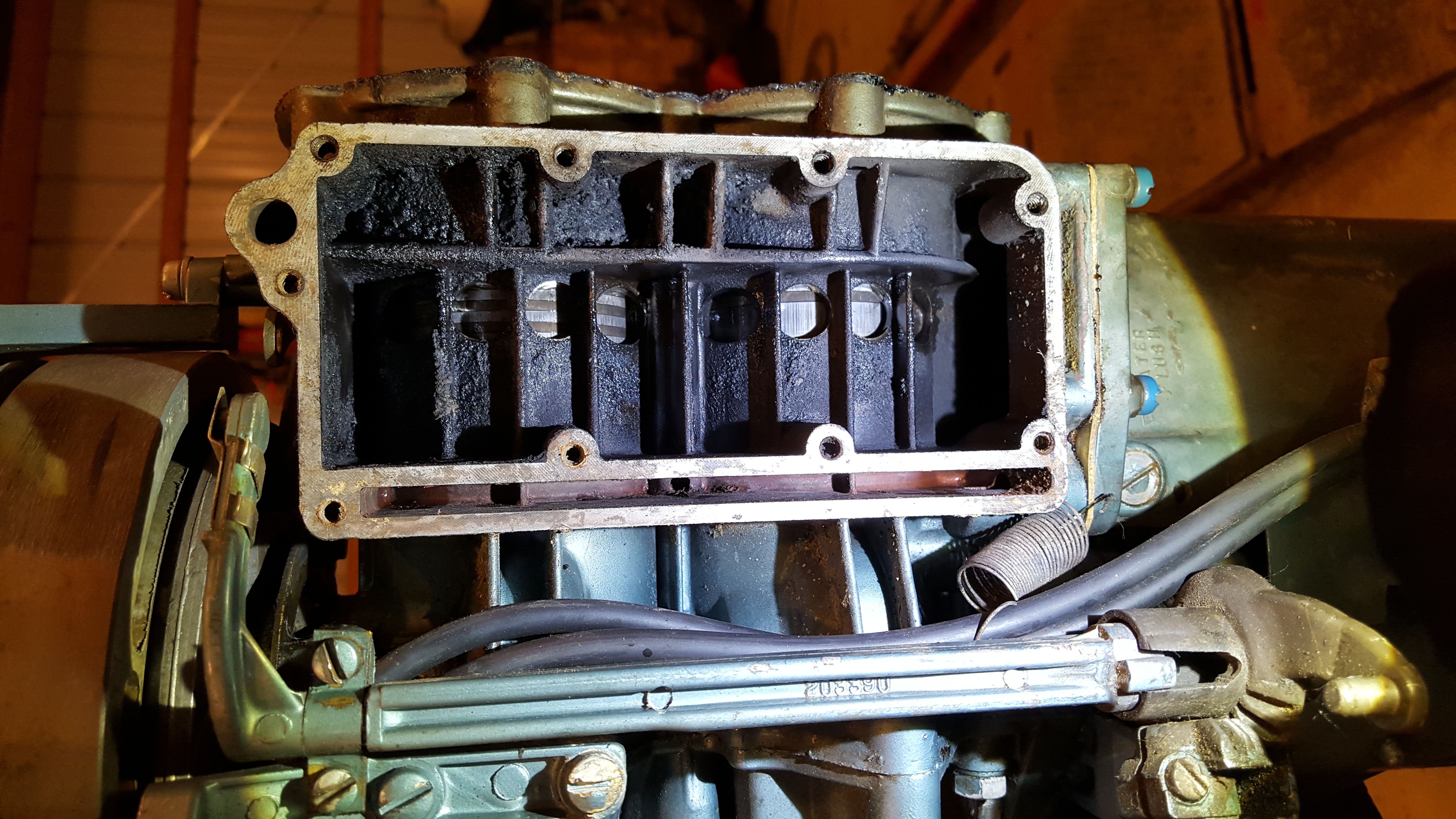

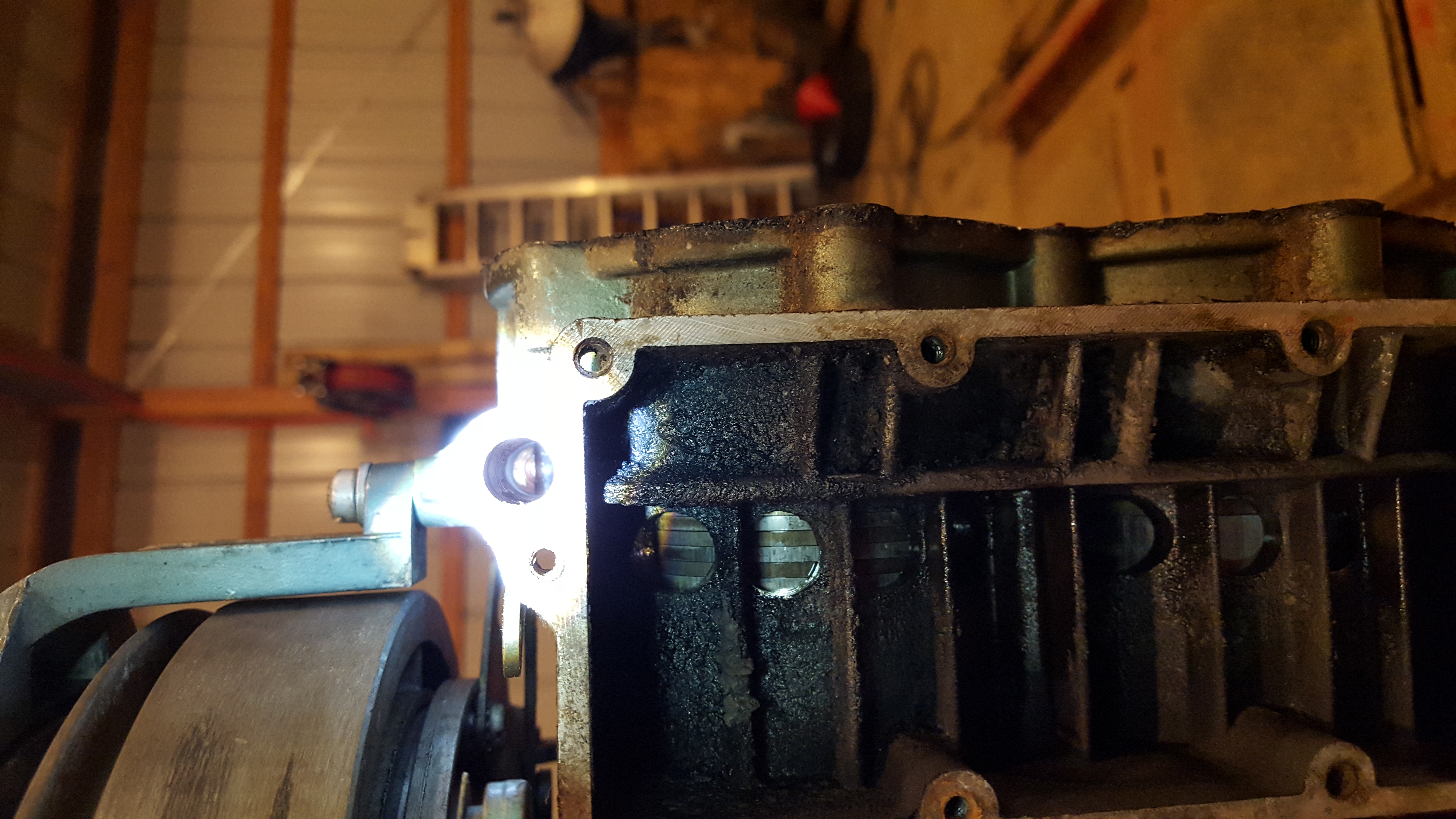

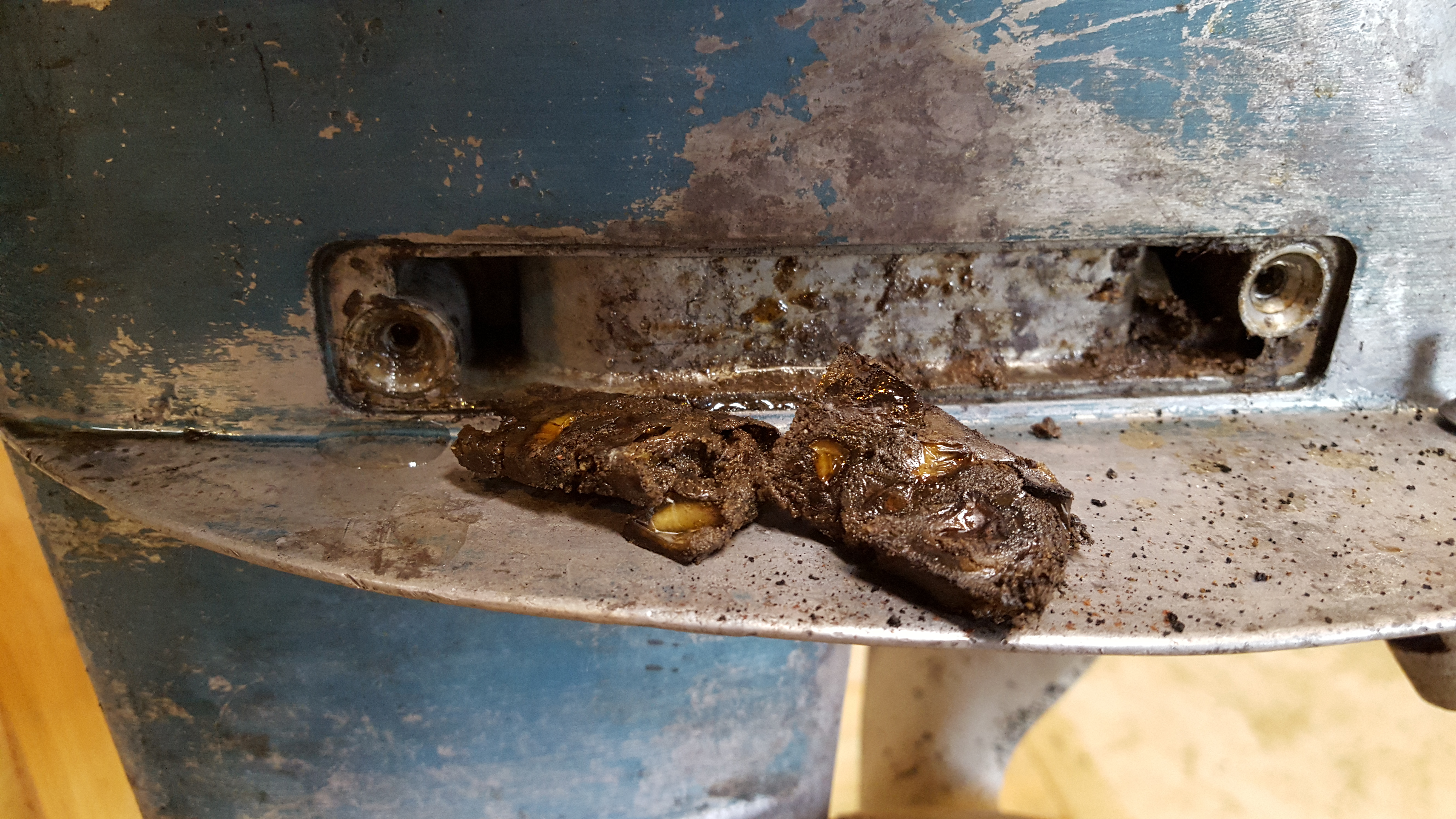

                    I hope the pictures come pretty soon. I want to see the solid slots. I keep thinking maybe they are just caked shut with carbon or something. I believe if there are any slots visible then they have to go thru. I believe these were machined into a plain casting when manufactured and if they did not go thru there would be no sign at all of them. I’ve been wrong plenty of times. Maybe this is one of them.

                    elfritzer
                      Dad burn my butt. You guys are right, the slots do go through! I was ready to hacksaw the ports, but I tried a razor blade first, and it broke through. THE CARBON DEPOSITS WERE PLUGGED THICK. I FINISHED THE JOB WITH A DENTAL PICK AND GOT INSIDE AND SCRAPED A LITTLE MORE THAN THE SLOT. I am still wondering about the leak from the cover, and what I should seal it with. The solid rubber is not the water pump, as pictured. The rubber lines the inside of the lower unit and runs vertically, like I said. Not sure if I want to tear it down just to get a picture. Going to fire it up tomorrow to check the telltale
