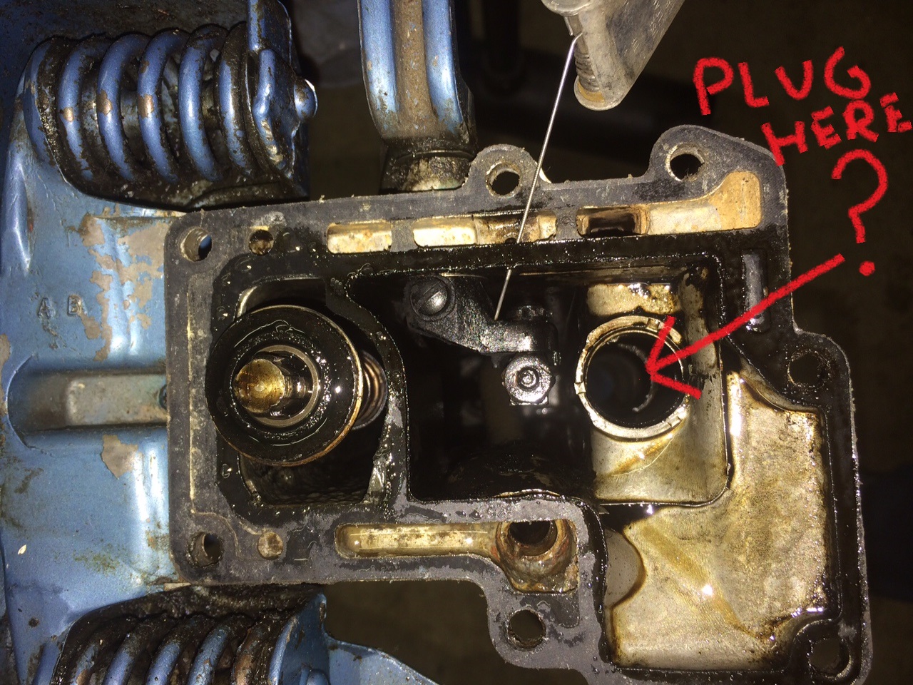

        Please replace the water pump impeller and lower powerhead seal components while they are easy to get at as well….
        Kind of hard to believe that nothing was spilling out of the bottom of the cylinder head, but I guess it is possible that the core plug fell out of the head while you have just been working on it….Have a look on the bench and floor, maybe it is there.
        You need to replace that missing core plug inside the exhaust housing as well, perhaps the water is sneaking out through there causing the leg to get hot.

          Thanks. I just learned how to modify photos. Not a computer pro by any means.
          The only place in the exhaust area that I can see and the only other place I can see that could take a plug is the one marked in the photo. Is this the "exhaust housing" or the spot you mean?

            Yes, at the top of that hole. Part number was 039139, changed to 306457

              #38429
              shoestringmariner
                Diameters appear to be 0.440" and 0.825"
                I hope my local auto parts store stocks a variety of these sizes. Guess I’ll find out tomorrow
                I had a look at the port on the cylinder head, I really don’t think water was coming out of there yet it is wide open. To me it looks like it has been dry for a while, but my experience is limited. This makes me concerned though, because if it was indeed wide open, and no water coming out, wouldn’t that indicate there’s a blockage in the cylinder head? Or purposely blocked for some reason?

                  #38434
                  beerman57
                    I think I would pull the cylinder head.
                    #38436
                      It’s real hard imagining water cooling the powerhead and not exiting that wide open hole. Why don’t you just put in a new core plug and see what happens before exploring further. BTW, I’ve seen lots of them with that plug rotted out.
                      #38441
                      beerman57
                        I’m a little confused, I thought we were talking about plugs on the cyl. head. The picture above with "plug here" in red, is of what? I know it’s the bottom of the powerhead, but it’s not the cyl. head, right?
