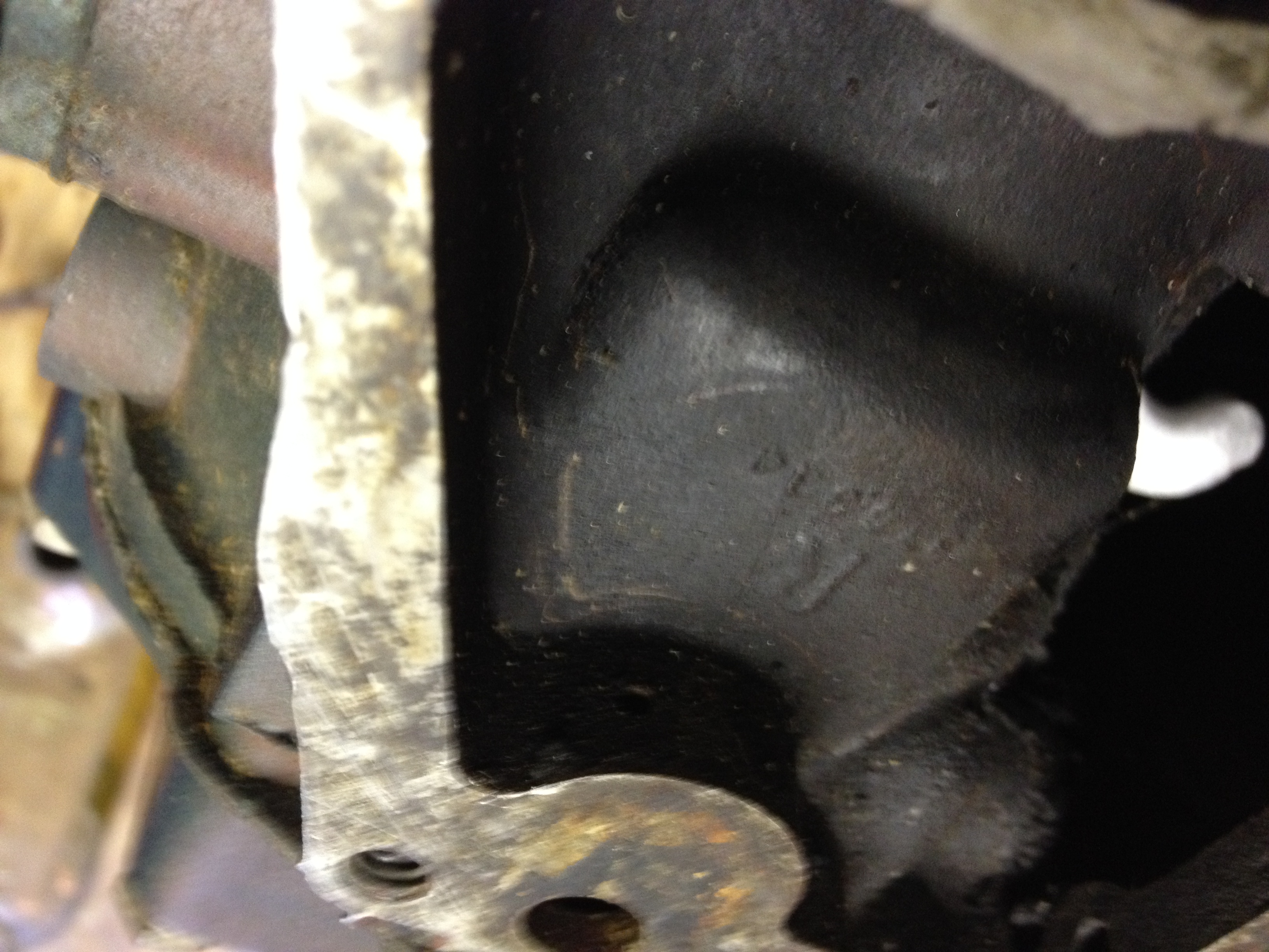

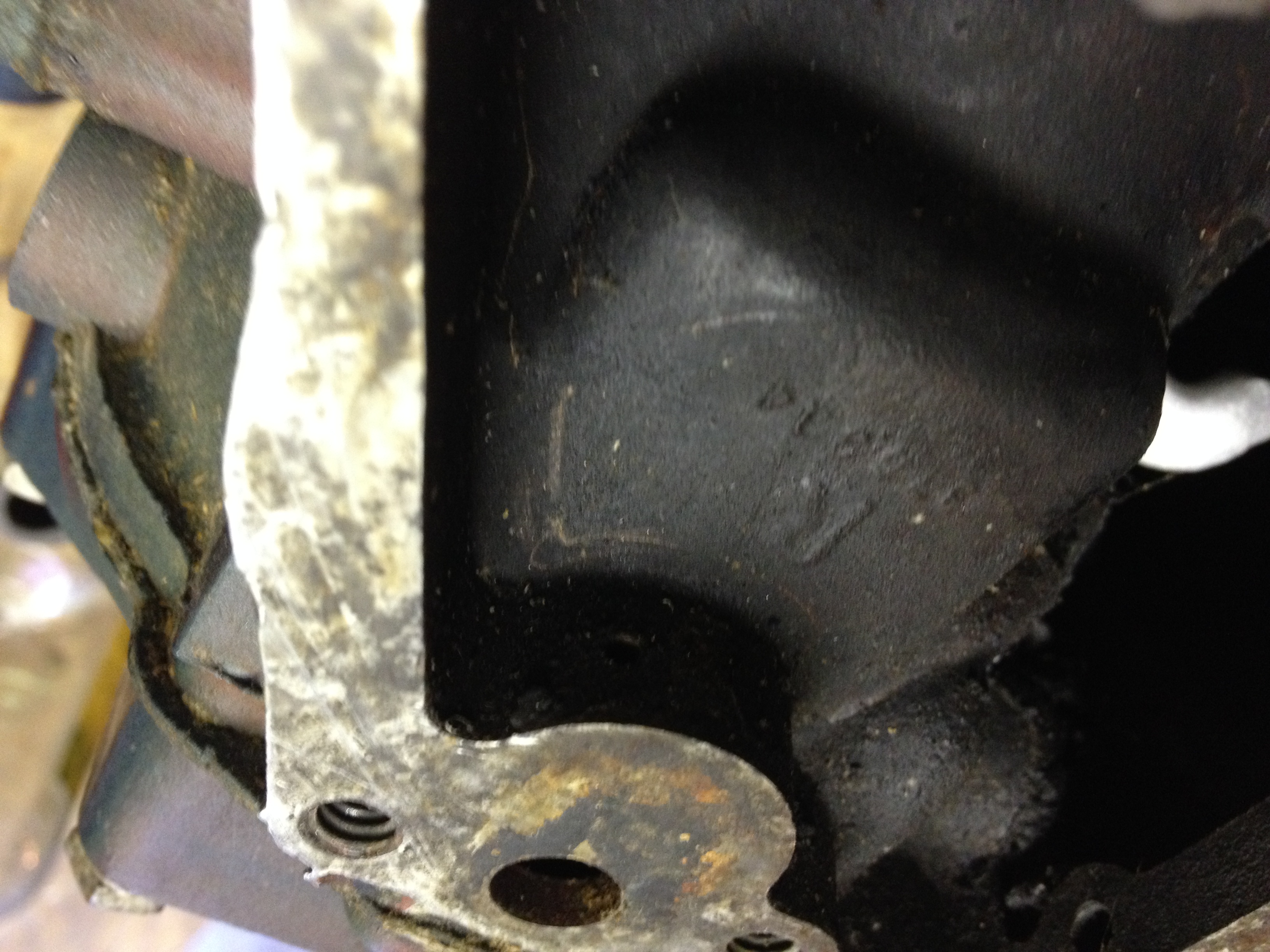

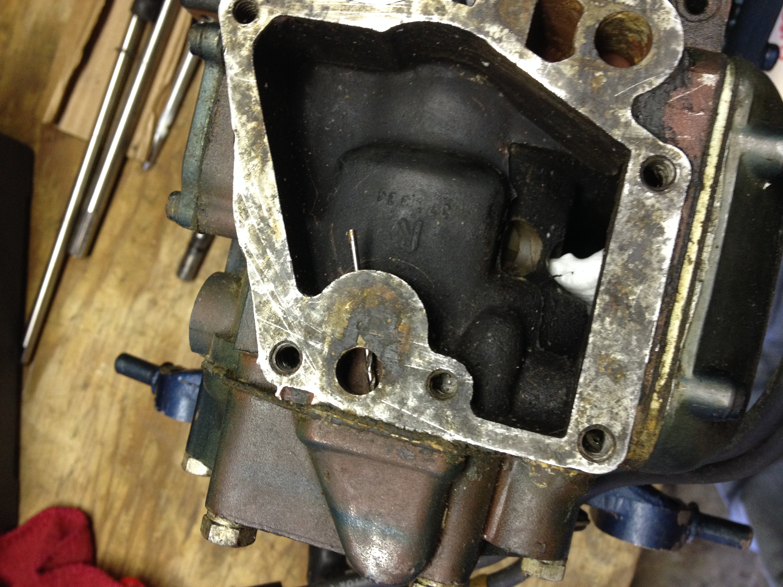

                  Next, I found a 1958 Sportwin powerhead, and had a closer look at it. I looked closely at the casting area around where the cooling water enters the powerhead, but saw no evidence of a cooling water bleed off. Next, I had a look at the rear of the powerhead where water exits into the exhaust hsg. I DID find a horizontal cooling water bleed off that is directed into the exhaust hsg, I’m thinking the hole is between 1/32-1/16" in diameter. Like I say, the hole is horizontal, although I’m thinking it is probably angled down just a bit to help cool the exhaust hsg. The exhaust chamber is open into the forward area as well, so I’m guessing this bleed helps keep the forward area cool as well. It should be noted that I found this same bleed hole on an FD powerhead as well…

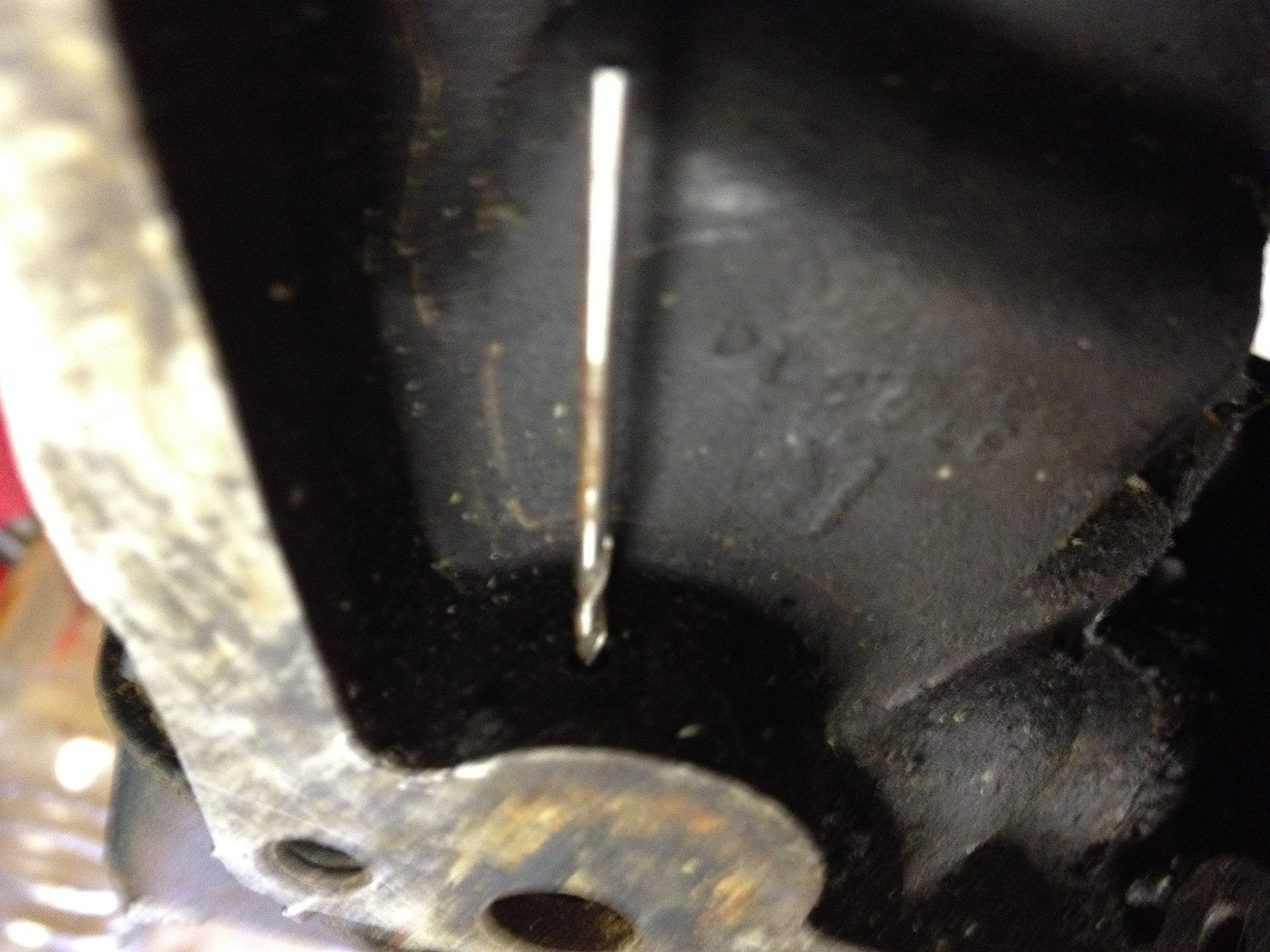

                      Update, just checked my powerhead, and could barely find the bleed hole that Fastwin mentioned. It was buried under layers of carbon.Took over an hour with dental picks and small drill bits to open it up. I’m 100% positive that this is what caused the problem. I would have never found the bleed hole without Fleetwins help. Thanks again. I will provide an update again once I get it back together, and give it a test run in the tank.
