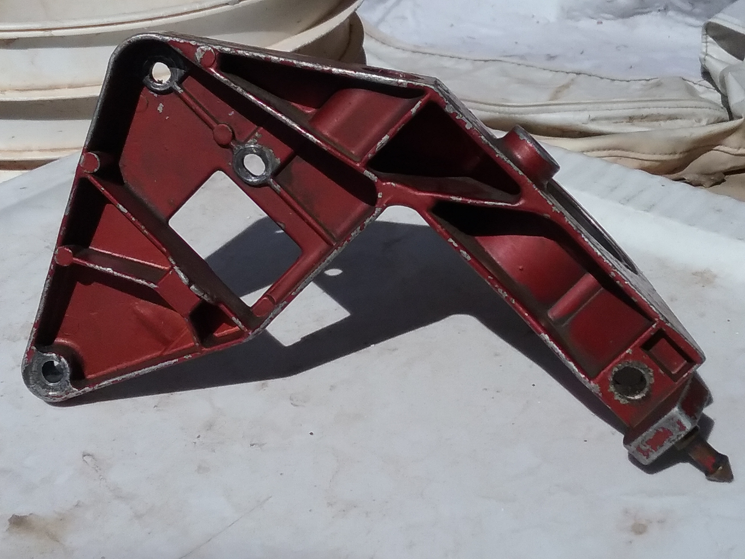

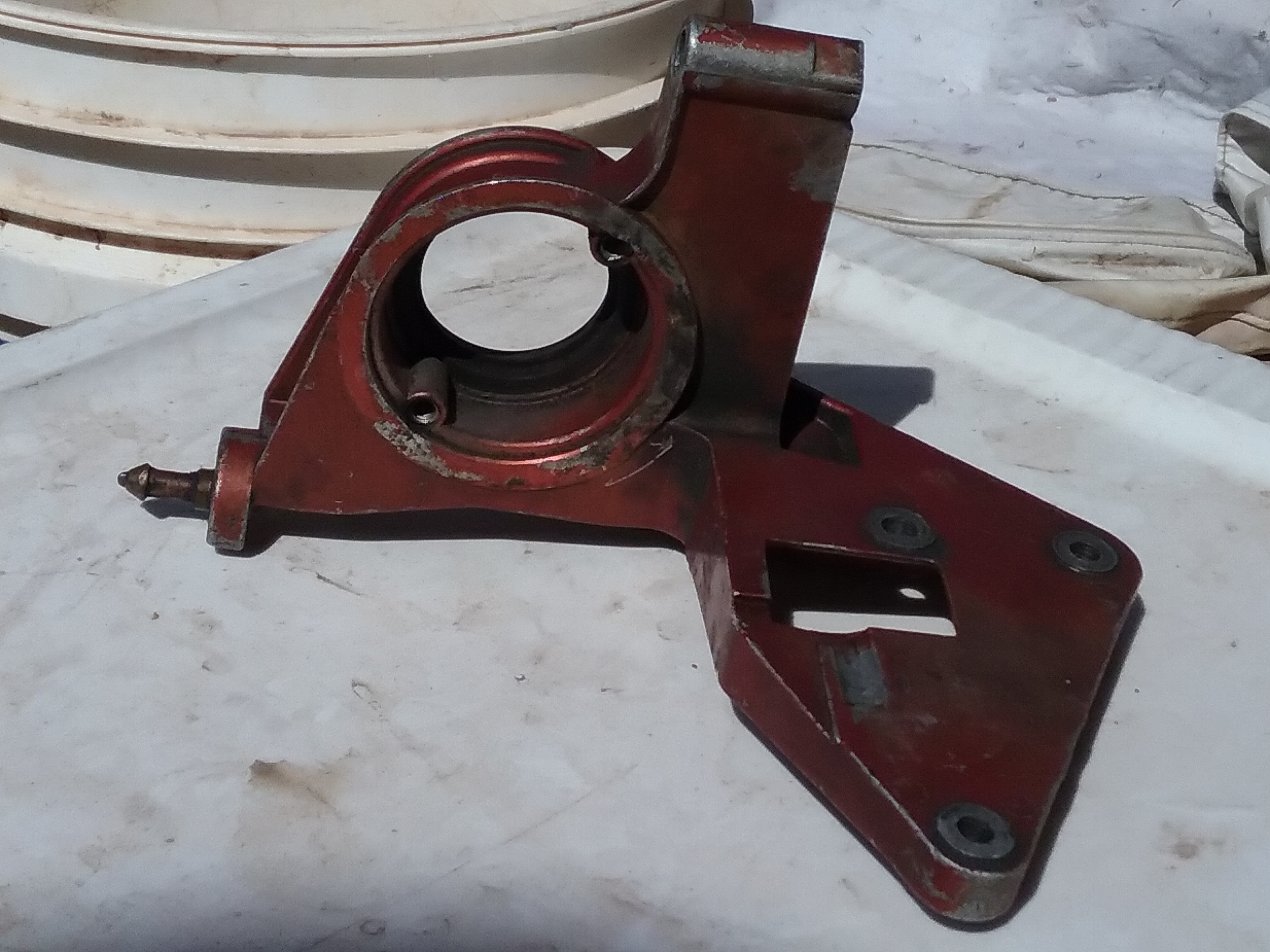

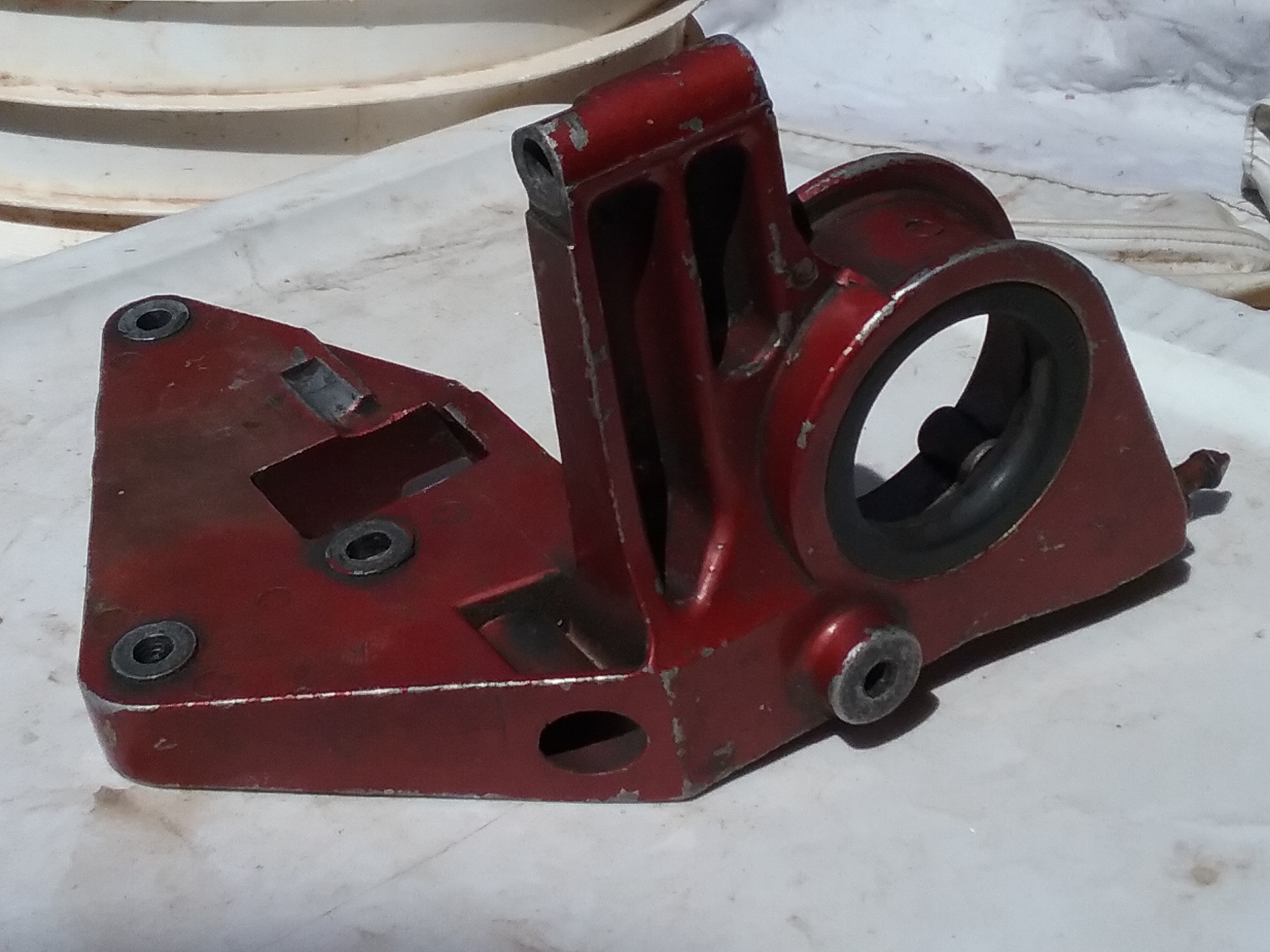

                      PS- can anyone tell me what this bracket fits and does anyone need it?
                      #59504
                        I think it is for a 1956 15hp Johnson 6 Volt starter, but not 100% positive. It is fairly rare and in high demand. 1957-up 12 Volt even more so.
