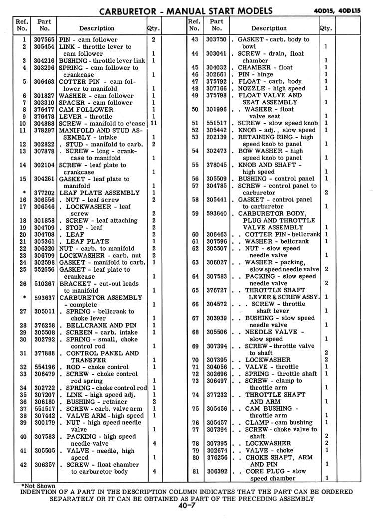

      Carburetor
      Pg-40-6-Carburetor
      #175999
        Carburetor parts list
        Pg-40-7-Carburetor-Parts-List

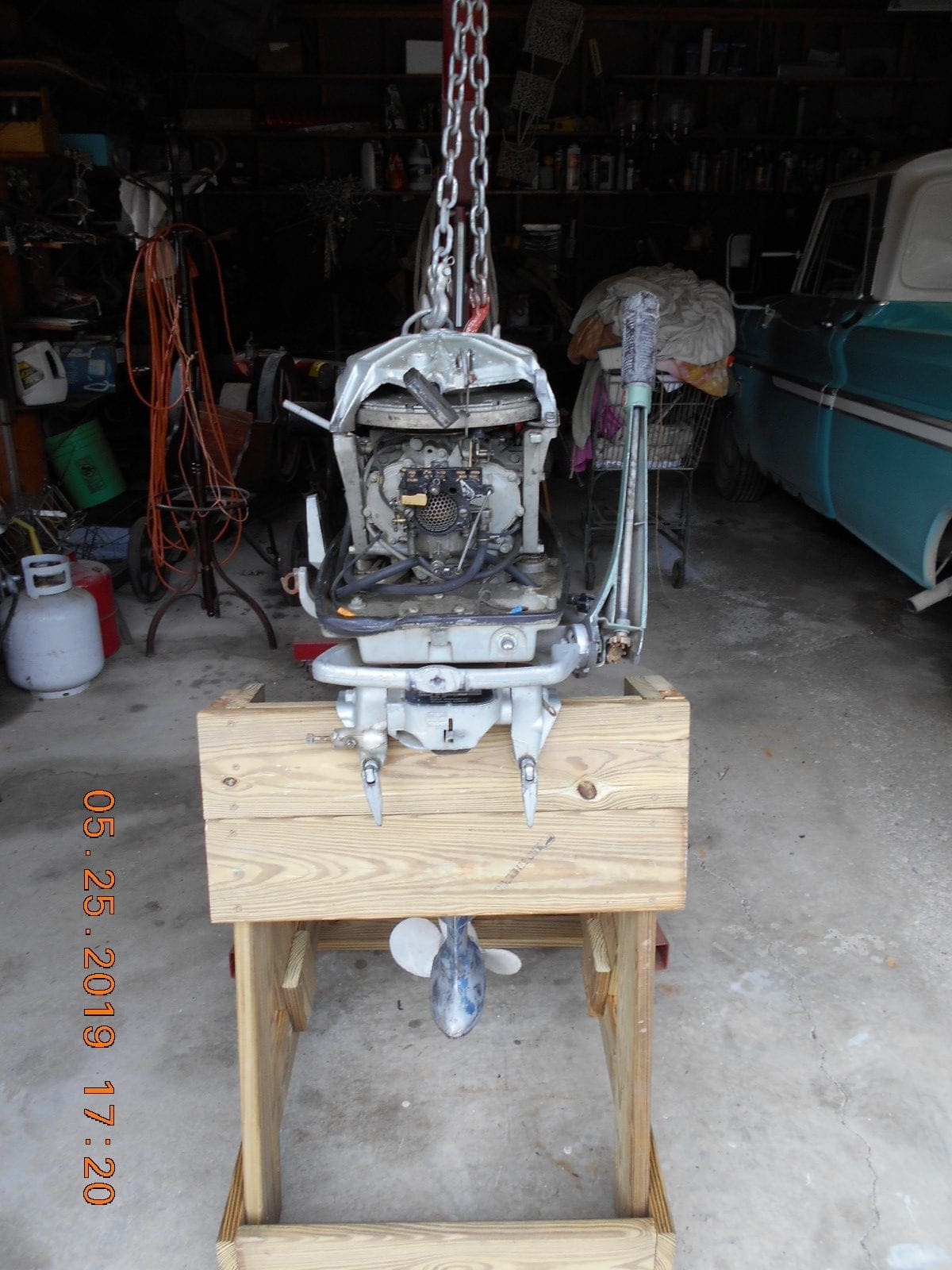

                Thanks Frank, much appreciated!
                I’m building a stand for the Gale right now
                so I can get it upright and get the cowl all
                the way off to see how it looks “under the hood”.

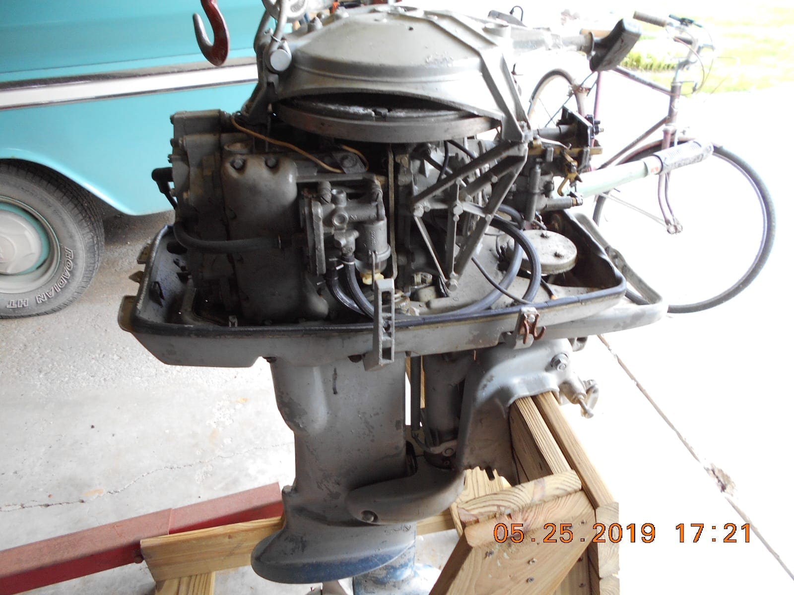

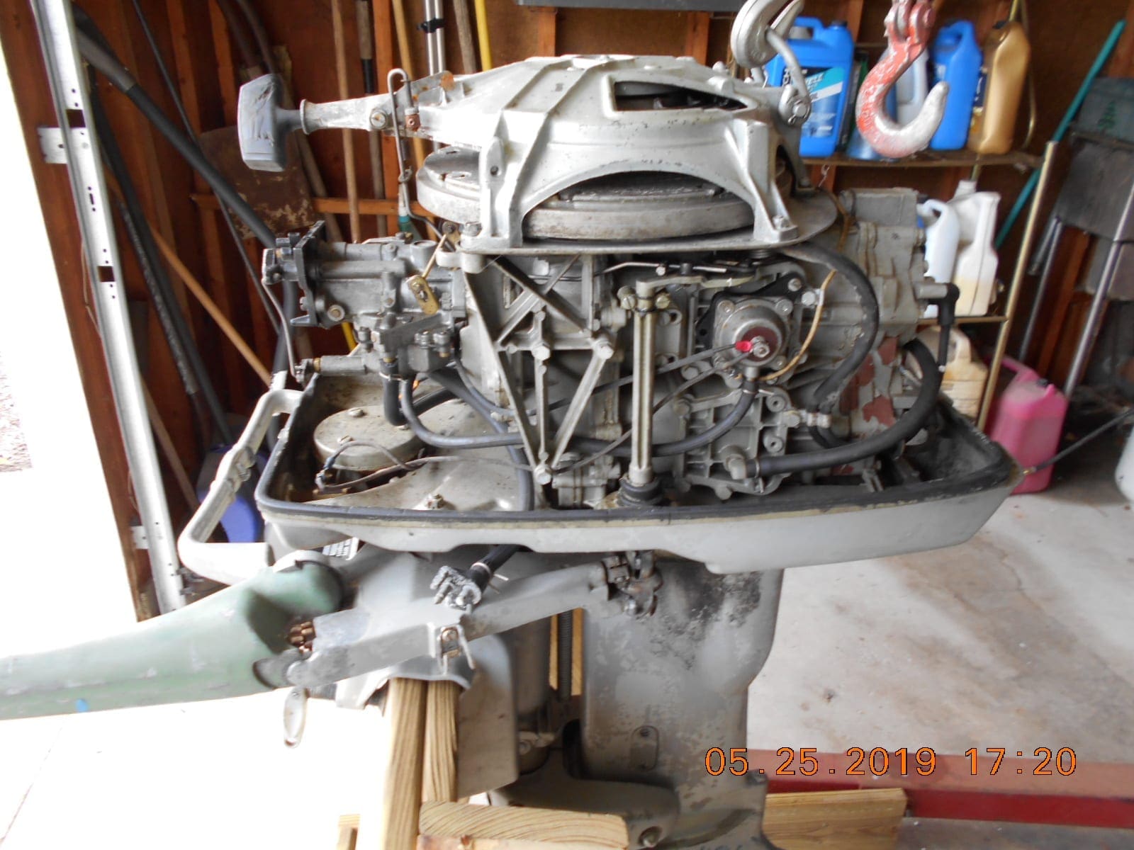

                #176044
                  The Gale will be a future project, but at least I got the stand made today
                  and the motor off the ground so I could actual pop the hood off.
                  It’s not pristine under the hood, but not too cruddy either.
                  DSCN7828
                  DSCN7829
                  DSCN7831
                  #176053
                    Looks to be in pretty decent shape. Good luck with it and keep us posted on progress.
