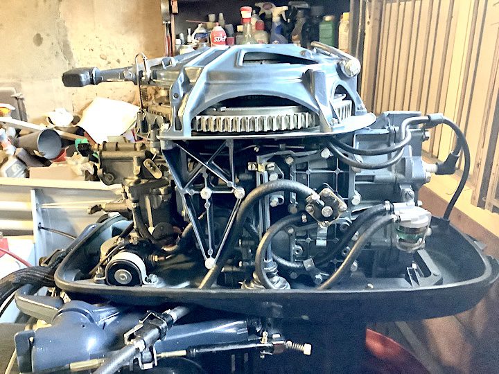

                      #261192
                      bob-d
                        Here is a picture of the internal fuel plumbing. Let me know if anything here looks incorrect. Hopefully the new OMC fuel pump is oriented correctly?
                        Bob D
