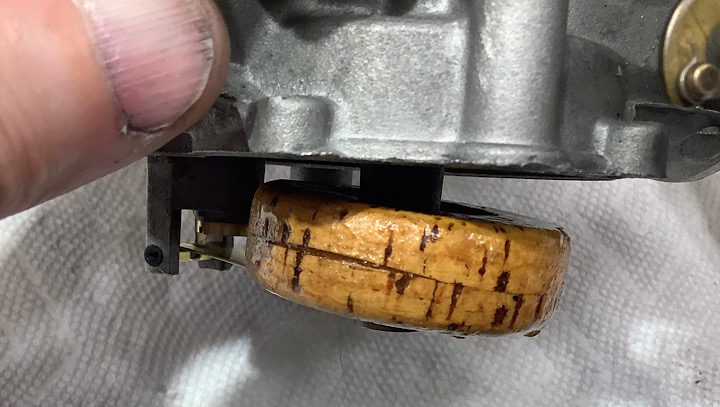

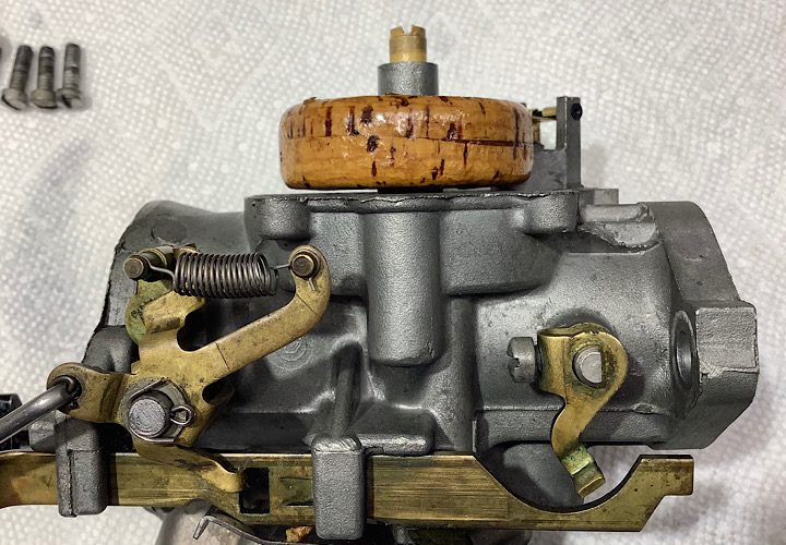

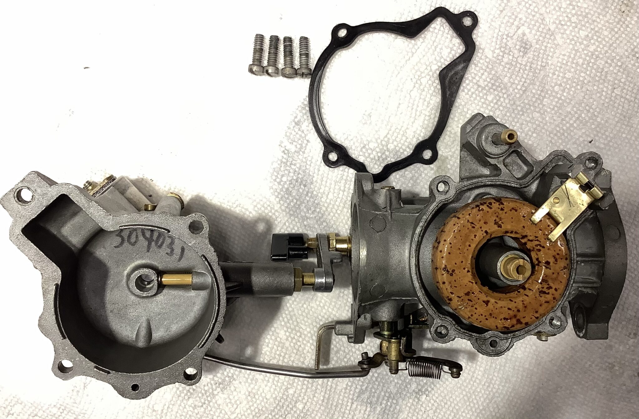

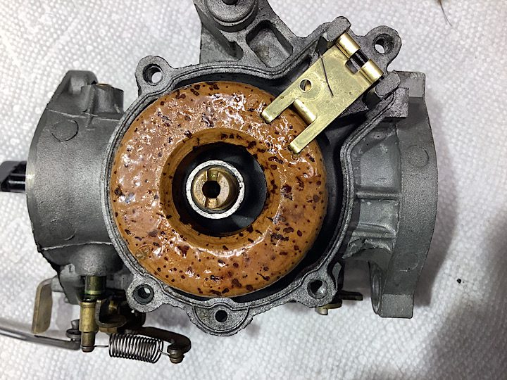

                So this afternoon I took the carb off and shot a few pictures. All looks good…….except possibly the amount the float hangs down? Is there an official  OMC measurement from the lip to the top of the float in the hanging position?
                Let me know if anyone sees anything else I might have done wrong.
                Don you were correct, the new small square OMC fuel pump was upside down in the last photo. The small drain holes in the base are suppose to point down.
                Thanks,
                Bob D

                  I am seeing the gasket for bowl does not encircle the little hole in pic #2.  ????????????
                  • This reply was modified 3 years, 9 months ago by DAVID.
                  #261250
                  bob-d
                    Hi Dave, it’s not a full circle, is just and indentation which can be seen on the gasket near the carb base in picture 2.
                    The vent hole was open. I was hoping I screwed it up, and had the hole covered by reversing the gasket, or something simple like that.
                    Bob D
                    #261265
                      Should be a full circle around the hole. look at the bowl ridges. BAD gasket.

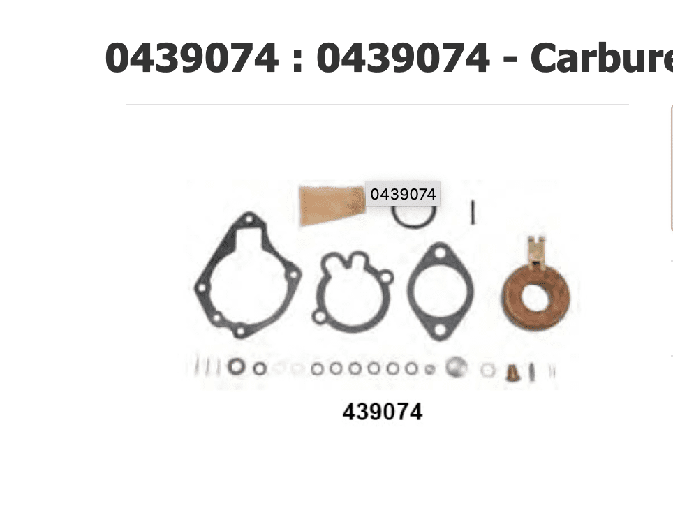

                        Dave is correct – that is a bad bowl gasket.   Your 28hp takes OMC/BRP carb kit 439074 – here’s a pic showing the correct gasket.   There may be another issue with the carb but I’d start with getting the correct gasket.
