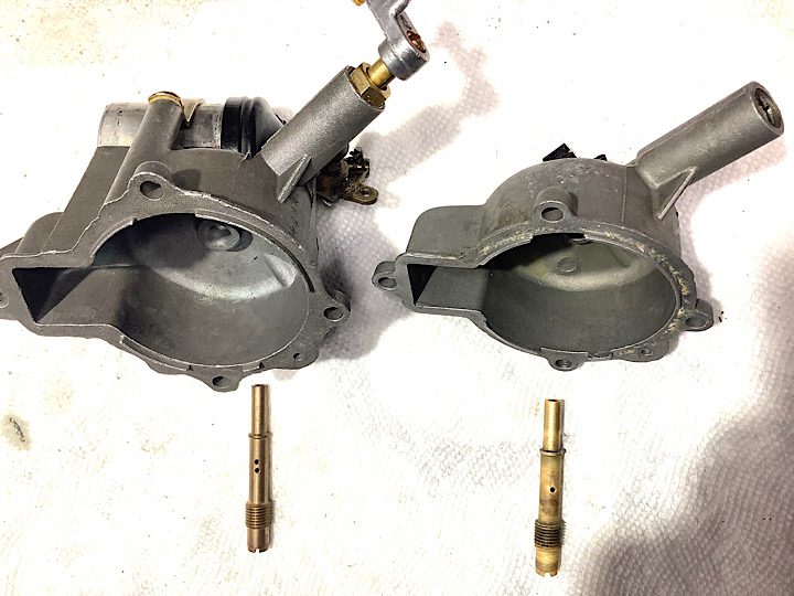

              Before it was determined that the float bowl gasket was incorrect, I was searching for any differences I could find between the bowl with the casting for the choke solenoid that I changed to from a 33HP from my original bowl from my 28HP possibly causing the non run issue.
              Looking at part numbers the bowl nozzle was different for the bowl with the solenoid. It had an extra hole. I picked one up. Should I use it, or did the engineers at OMC just use it because of the 5HP difference and various other changes they made to the 33?

              58434FA2-B885-46F1-A3EA-DEEB0A86F2F1
              #261341
                side holes allow air to emulsifty the fuel .
                a bigger engine probably needs  more emulsified fuels  hence  the extra hole
                yet parts diagrams  are not clear on the actual amount of holes.
                the pictures in the  J service manual  seem to show 1 hole  for bigger engines….. maybe  since their vacum pull is stronger   1 hole is ok   while  smaller hp rated engines need more   side holes…. since they have  less  “pull vacum”   on the carb.
                try one hole …see what happens
                theory anyway 🙂

                  If it fits ok, use the nozzle originally on you motor.
                  #261346
                    Yeah, definitely use the 28 hp nozzle.

                      Bingo, the saga has ended (37 posts later) ……….
                      Dave and Bill get the prize, and my unconditional gratitude for picking up the wrong gasket mistake. Hey, Bill even gave me a guarantee that the correct gasket would work!!!! That was enough for me.
                      I made a quick gasket out of cork, and it fired right up, and ran great.
                      For the life of me I don’t know where I got the replacement gasket from. I guess it looked like the correct shape, and I didn’t check parts numbers, and called it a day.
                      FYI Crosbyman, I also went with the nozzle with one hole.
