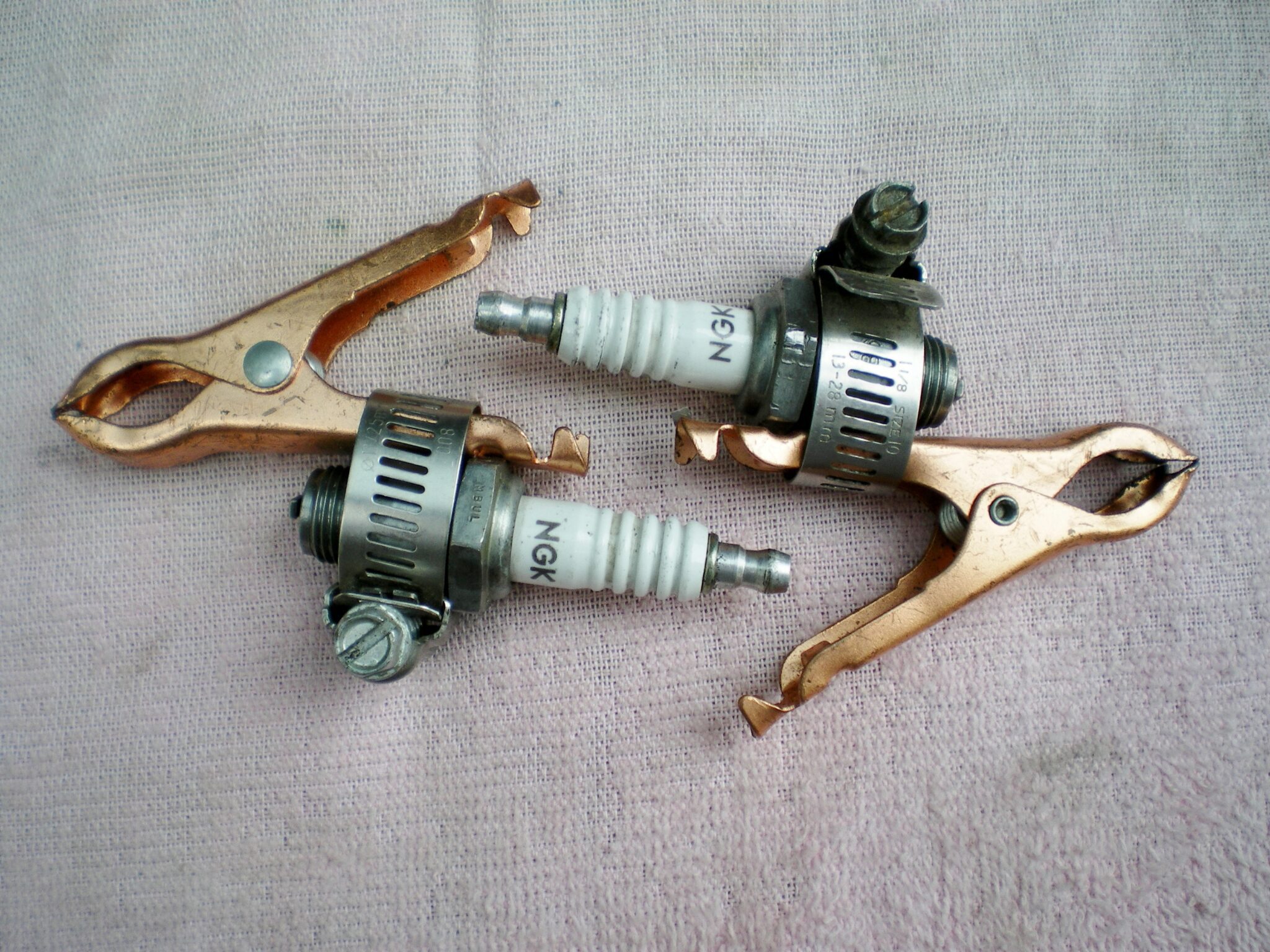

                  First post said good spark. Now I am curious as to your method for testing spark, in the beginning….
                  #245134
                  outbdnut2
                    How did you check for spark? Spark jumping the spark plug gap in air under no compression usually means you have good spark, but if the voltage is weak, it may not fire well under compression. You should be able to make the spark jump 1/4 to 3/8th inch in free air. (some like to see 1/2 inch). You can make a test jig to do this, or I do the next best thing, taking an old spark plug and prying the gap wide open.
                    #245140
                      Simple variable gap spark indicators.

                      farmboy71
                        I just grounded the plug and pulled to see if there was spark. Both seem nice and blue. When I was checking the top crankshaft seal the wire broke for the top cylinder. Fixed that yesterday. I got spark on both cylinders again. I will try and see if it will spark a 1/4 inch gap this evening and then hopefully try and start it again. Thanks for all of the help.
