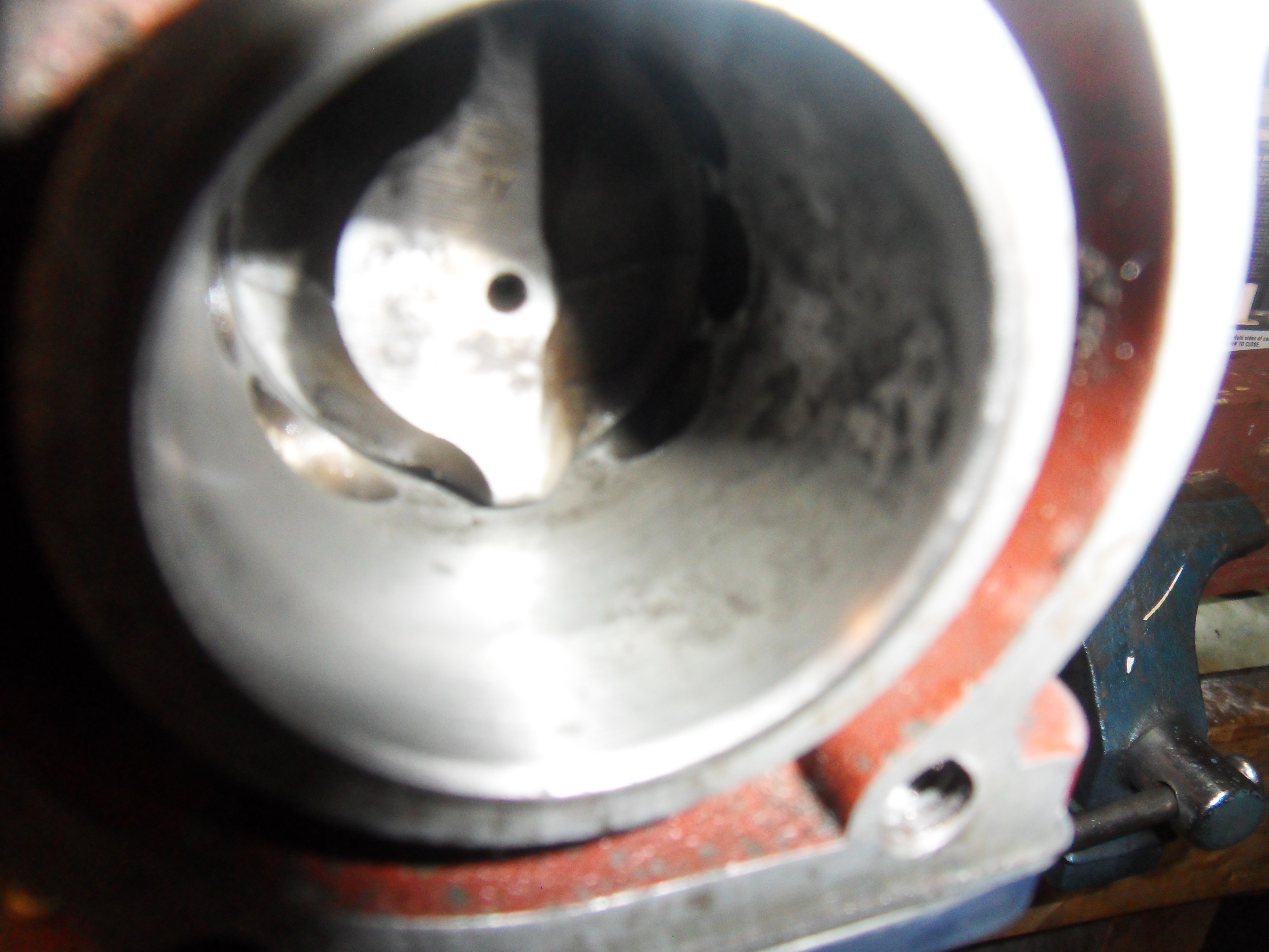

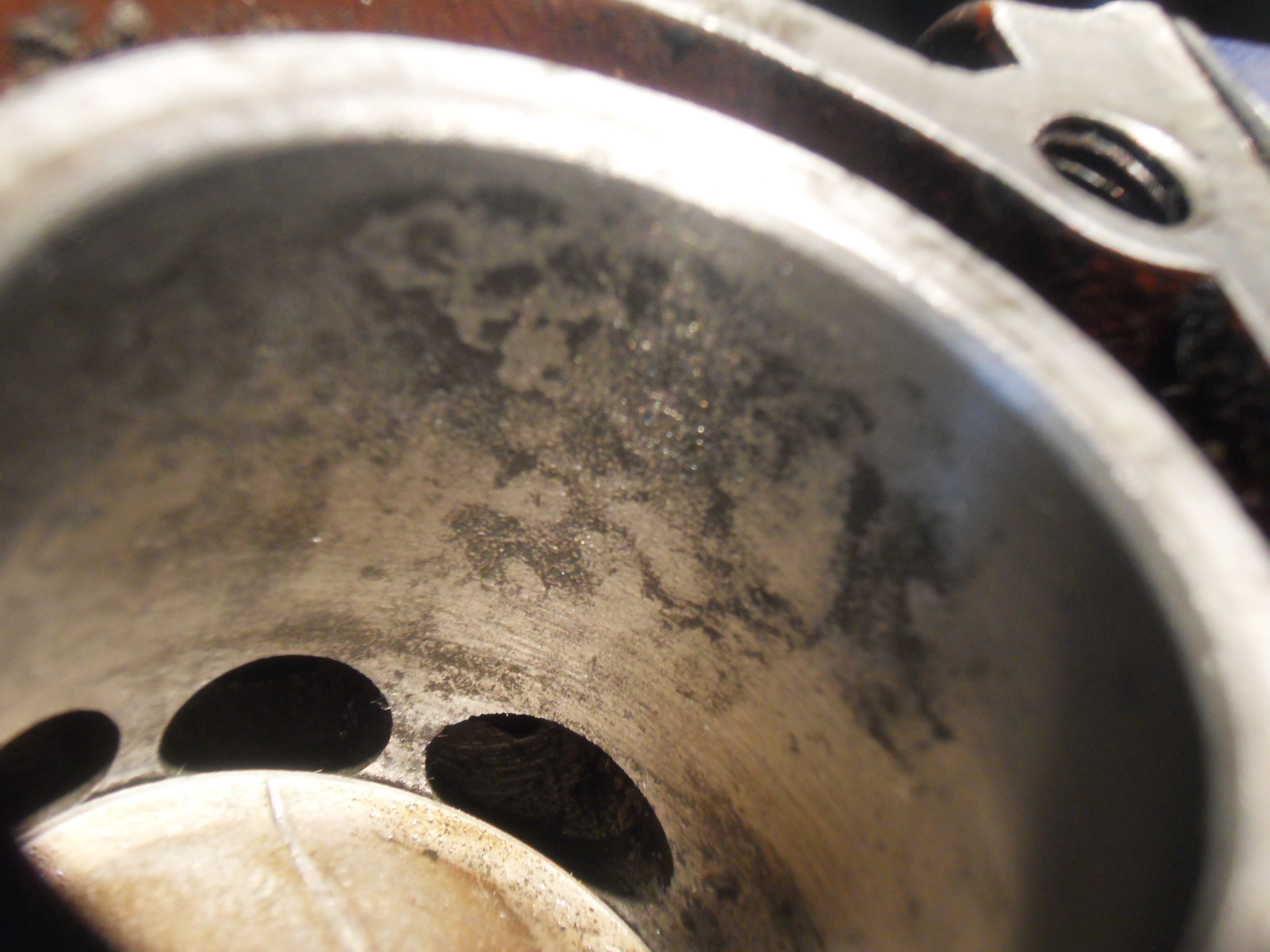

      OK, well the piston IS correctly oriented in the cylinder…But, I see a lot of rust on that cylinder wall. Did you hone the cylinder? If there are actual pits on the cylinder from the rust, this might explain the low compression.
      It kinda looks like the previous owner tipped the engine upside down somewhat when he removed it from the boat, water trapped in the exhaust housing backed up into the cylinder and got trapped there causing the rust and pitting.
      It is tough to prescribe what to do now….Are you sure you used the correct part number rings? You did not check the end gaps, so we don’t really know where we are at now…Rub you finger nails along those rust marks to see if there is pitting…Let us know…

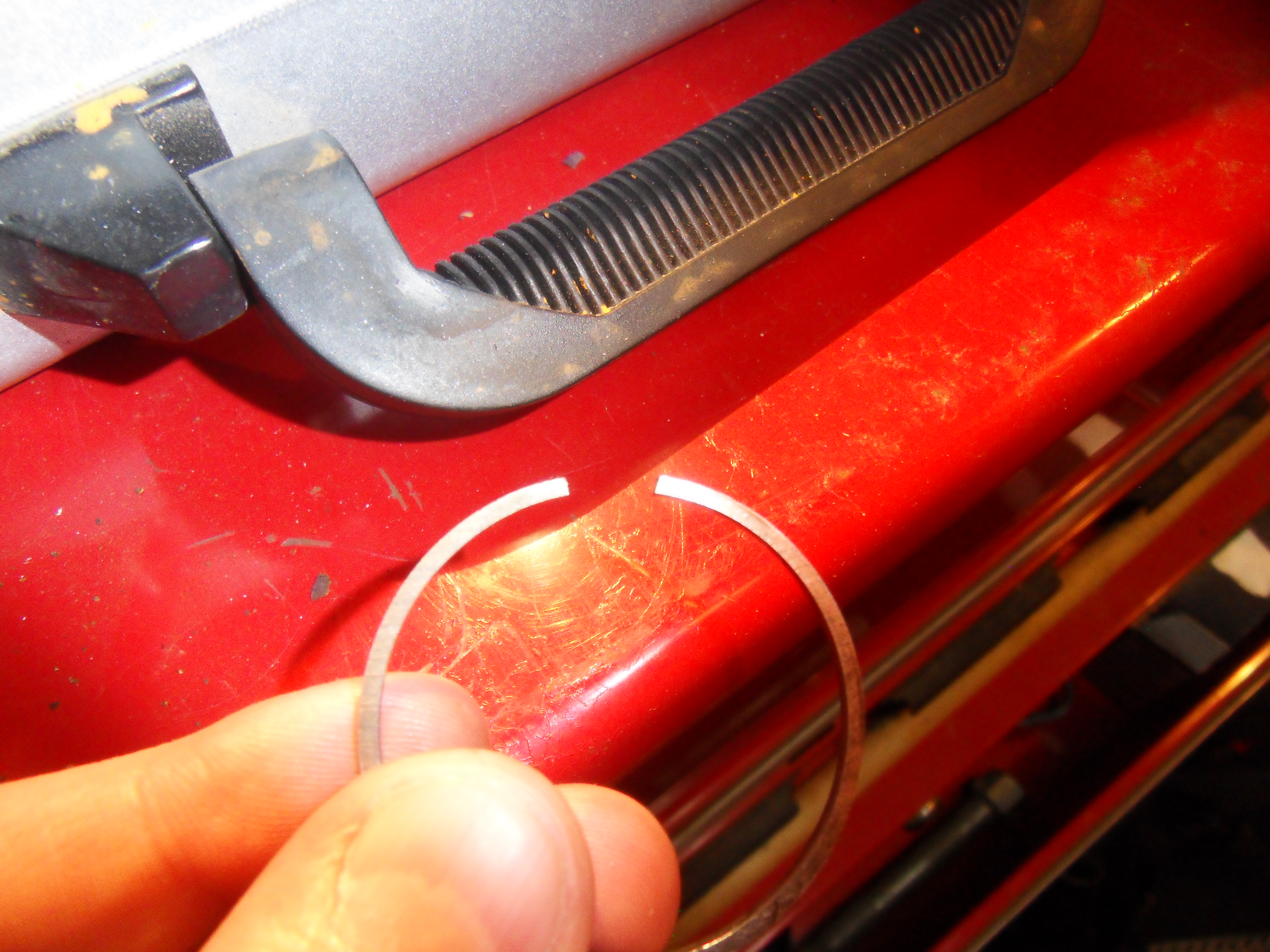

        Thanks for the reply. I havent had it honed, I have however used emory cloth and light oil since I took the photos. It seems to have helped but i worry about taking to much material off. To be honest i don’t know exactly what pitting will look like but I have to think what I see is pitting. I plan to remove the piston and rings again this evening and I can measure ring gap then. The rings I used are the standard sized rings, OMC part number 383920. But these rings had flat ends not the L-shaped which was stock. I’m starting to think that because of the different ends that I may not have received the correct rings.

            Again, this is a tough situation…A conventional hone may seem to remove the rust/pitting, but might just be masking the problem…You will really need a super rigid hone, which would be hard to find for such a small cylinder bore…
            The 383920s are the correct rings for the engine…But, were the rings you bought OEM pieces, or aftermarket? The ring ends should have notches to fit over the locating pins on the pistons, the ends should not be flat. So, I am guessing you did not get OEM rings…Rings with flat ends would have super oversized ring end gaps that would certainly affect compression…

            So, I guess I would probably pull the engine down again and post pictures of the rings you installed. Do you still have any pieces of the original rings left hanging around? If so, look at the ends of the rings to see how they cover the piston locating pins…Flat ended rings will not work correctly…

              Well I honed it out a bit. Smoothed the cylinder up nicely, still some pitting but i was afraid of taking to much off. My rings are wrong, flat ends no notches so the end gap is huge, talking over 30 thou. But I slapped it back together and put a tester on it and it bumped it up to 65psi. to me that seems like a decent improvement from 50psi. I’m gonna try tomorrow to start it and see if i even get it to fire. If it does i’ll be ordering the proper rings this time hopefully. If it doesn’t fire well i don’t know, i don’t want to toss a lot of cash into this with no guarantee it run again.
              The pictures make the rust and pitting seem worse then when i look at it in person. Seems to really stand out in the photo.

                OK, well those rings just can’t be OEM rings, and the big end gaps caused by the flat ends could surely explain the low compression readings… It seems strange that those rust marks did not go away while giving it the 50 cent hone job with the emery cloth, which concerns me.
                You have got it back together now, so go ahead and try it, but I think you ought to go ahead and order the proper OEM rings…65PSI is pretty marginal for this engine, especially seeing that it has new rings…
                I am very interested in finding out just where you got the flat ended rings, and if they were portrayed as OEM equipment…

                  Pits will not hone out. Anything larger than the width of a ring will cause compressed fuel to leak by the ring. You can,however, ignore pits beyond the travel of the rings.
                  IMHO only cure for pits (as opposed to surface rust), is to bore out the cylinders. Unfortunately, I’ve never seen oversize pistons for a Mate (doesn’t mean they don’t exist).

                      I agree i’m not satisfied with 65psi, but i thought it was decent considering the ring end gap I have with the improper rings. I bought the rings local, came in a bag with the correct part number so I never even looked twice at the rings them self until I got home and was slapping them on the piston. Foolish mistake. Ahh well live and learn. If it even fires once tomorrow new rings will be ordered ASAP because at least i know it will run with proper rings and at least more compression hopefully.
