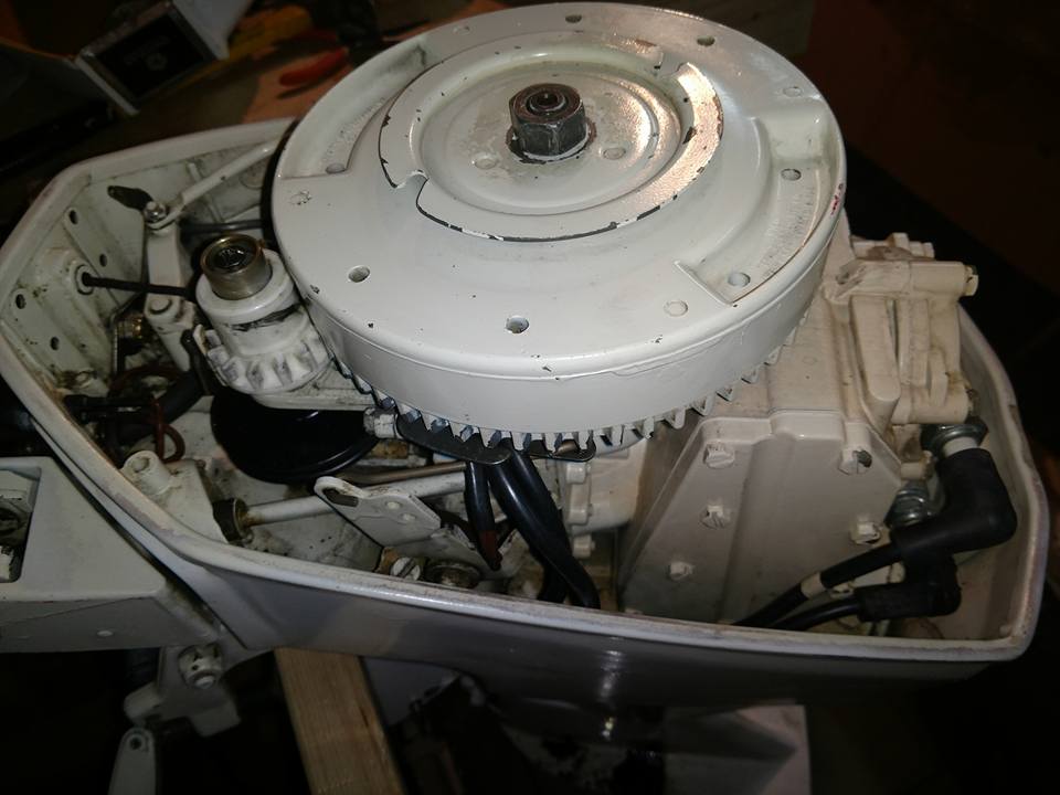

Im pretty sure some of this motor has been repainted in the past. The gaskets for the fuel pump were painted over but wer new style gaskets meaning that the paint happened after they were replaced. The slight difference in color comes off more in the images than in real life. The color is consistent over the entire surface. No scorch marks or peeling paint. my assumption is that the motor was overhauled or the power head was replaced.
May 2, 2018 at 2:46 pm #75214I will however order the parts, how difficult is a head gasket/exhaust gasket change on these?
May 2, 2018 at 3:00 pm #75215Also just a note, I live in Colorado and doubt this motor has ever seen salt.
May 2, 2018 at 3:22 pm #75219I’ve never done one of that model. Looks like the powerhead might have to be removed to access all the bolts (??) You’ll have to evaluate it from there.
