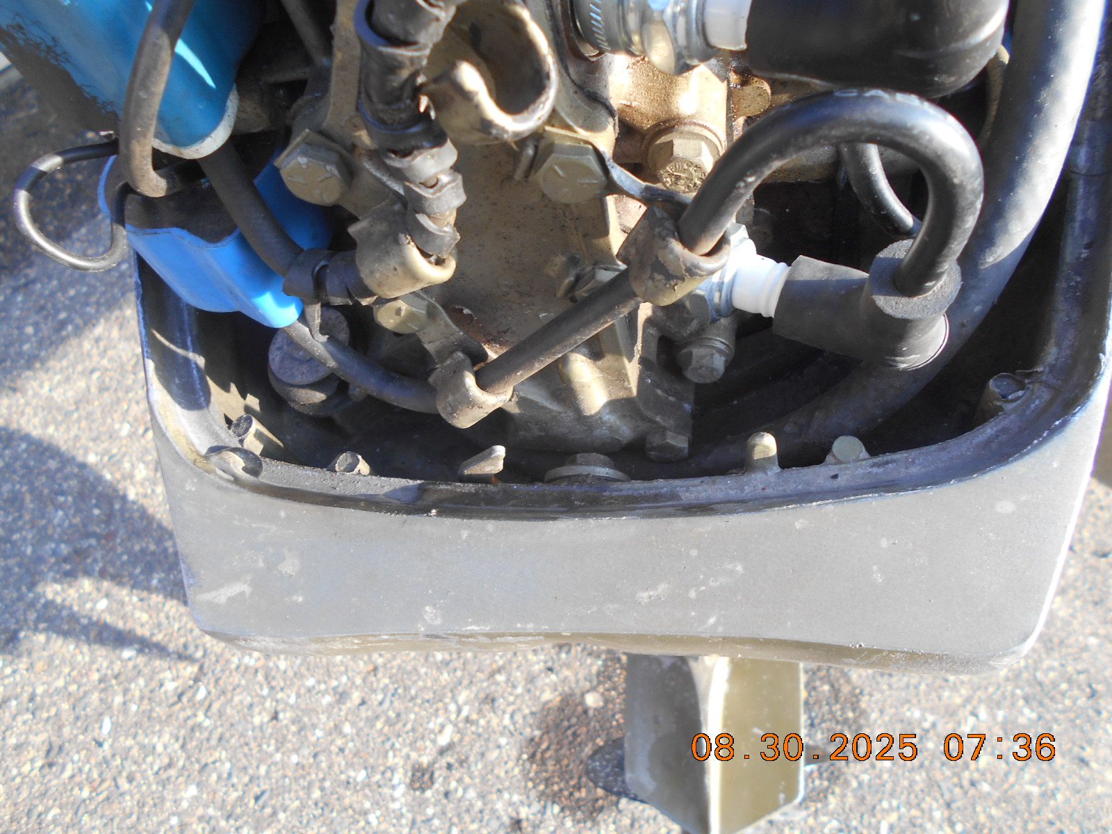

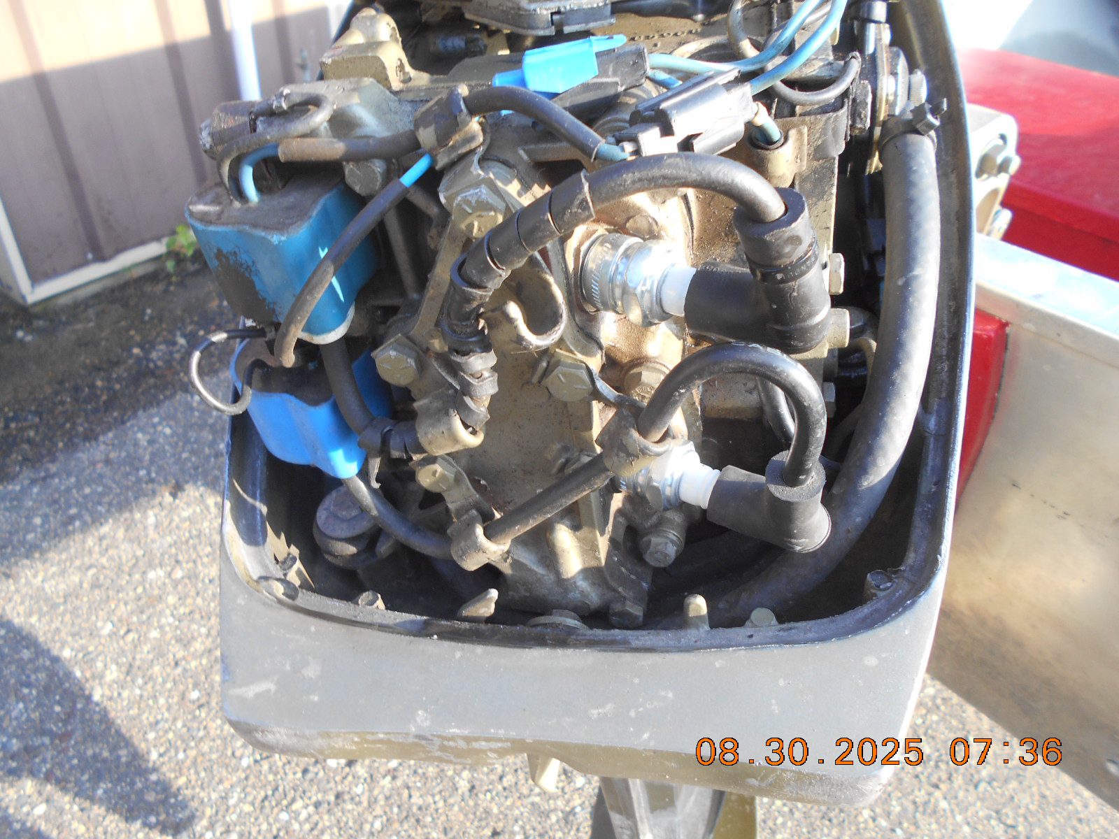

              Crosby Man, I seen the thermostat on the diagram, but
              not on the motor.
              Photos below.
              Please circle the thermostat and send it back, lol.

                well I don’t see it but what is that  sylver  circular bulge just left of the lower side bolt   of the cyl head…. is there any chance the thing could be behind a cyl head cover  necessitating its removeval ??
                if not ….I guess the info on marineengine.com  is wrong or your PH  is
                cyl head pic on marineengine.com show a cavity to fit the thermostat on the INSIDE of the cyl. head….    then a cover fitting over it  ??

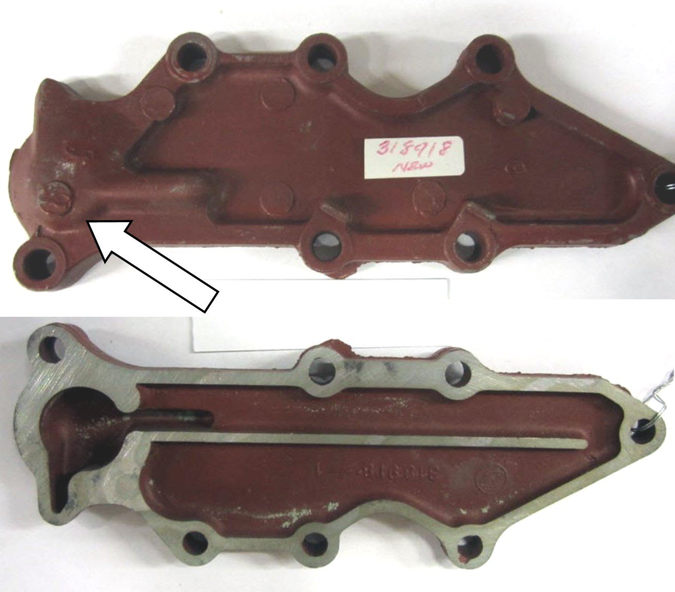

                #299469
                Steve D
                  It’s the bulge…
                  318918

                    I’m guessing the thermostat is behind the water jacket cover.
                    As I mentioned earlier, if that’s the case, it doesn’t look
                    like it’s possible to pull the cover with the lower cowl
                    in the way.

                      I’ve only worked on a couple motors from that era Buc, and never had to try and remove the water jacket to check or replace the thermostat.  Is it possible that maybe once you move the hose out of the way, and remove the spark plug and wire, there might be just enough room to get a box wrench on that lower screw and possibly enough clearance for it to be fully backed out?  I’m sure someone with more experience with those (maybe fleetwin?) will shed some light on it.

                        These things definitely have thermostats, and I would absolutely replace it if it is missing.  Won’t idle worth a darn without warming up and will foul plugs.
                        Be careful, there are two different styles of heads you might find on this thing, each has its own unique gasket.  Post a picture of the head and I will get you the gasket part number.   These thermostats are a pain to replace, but it can be done, am guessing this has not been used in salt water.

                        Buc on my ’74, the thermostat was at the bottom of the head.   Not the best thinking in my opinion.  My motor is gone now and I can say good reddens!
