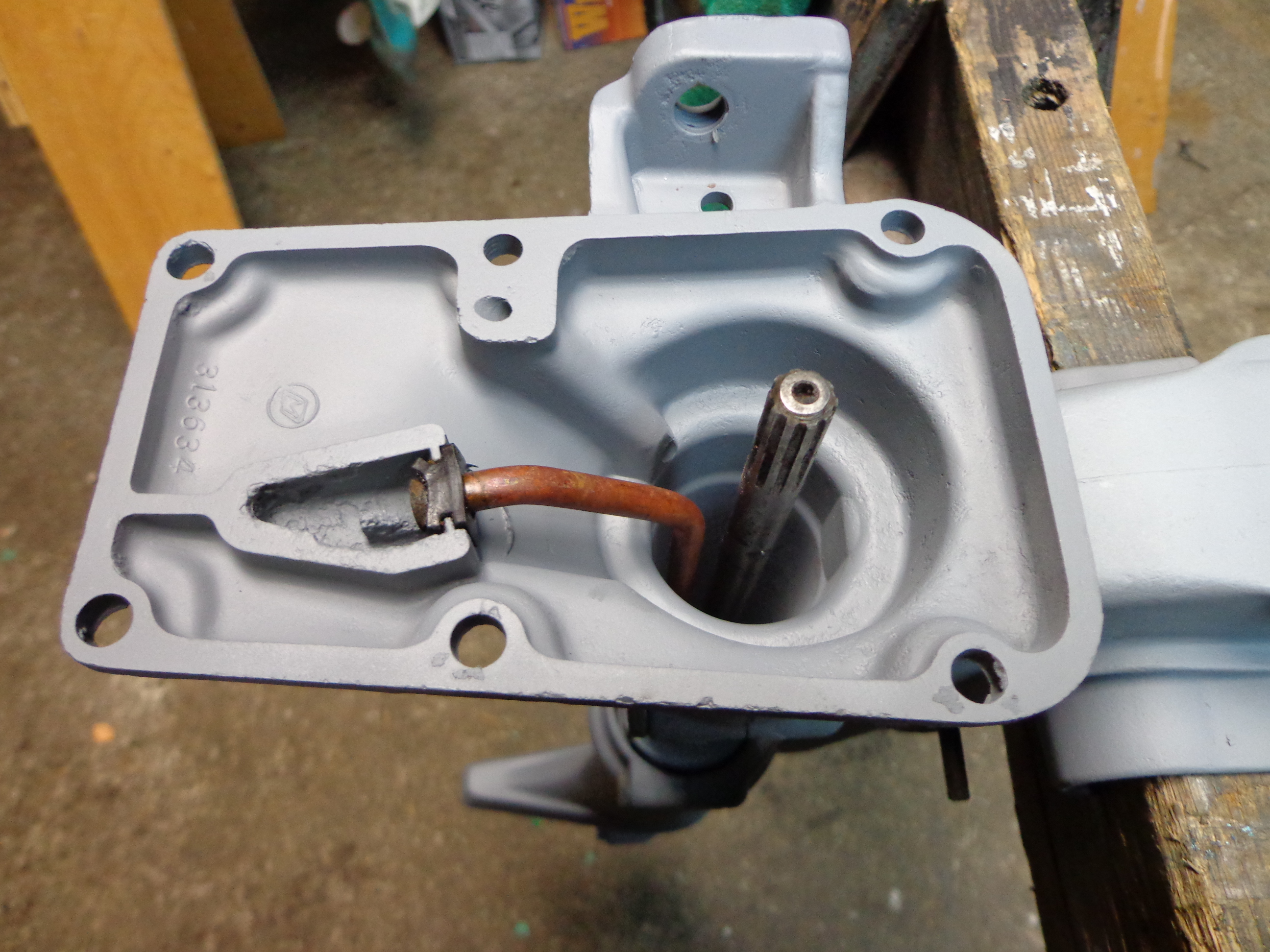

                #36498

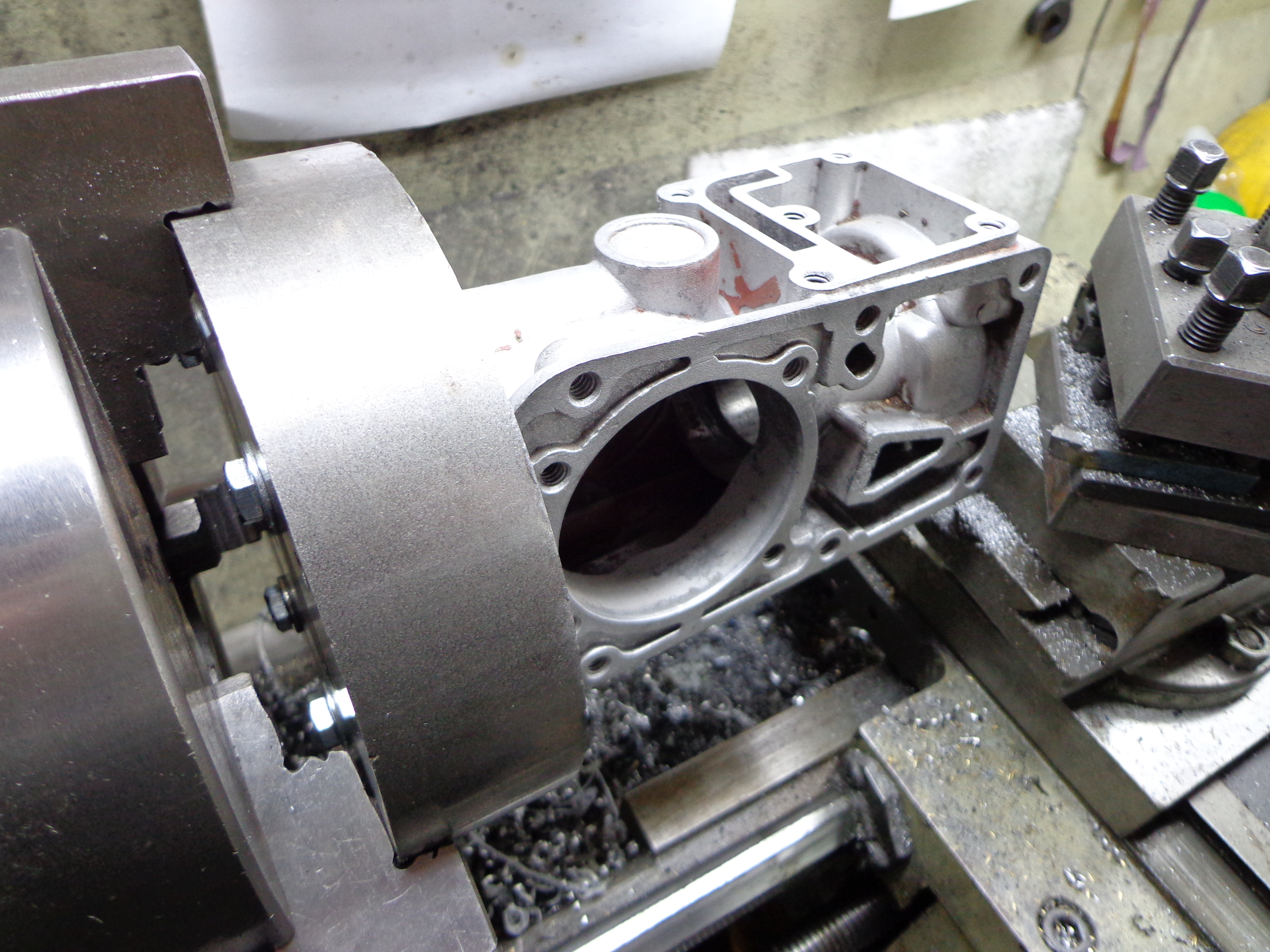

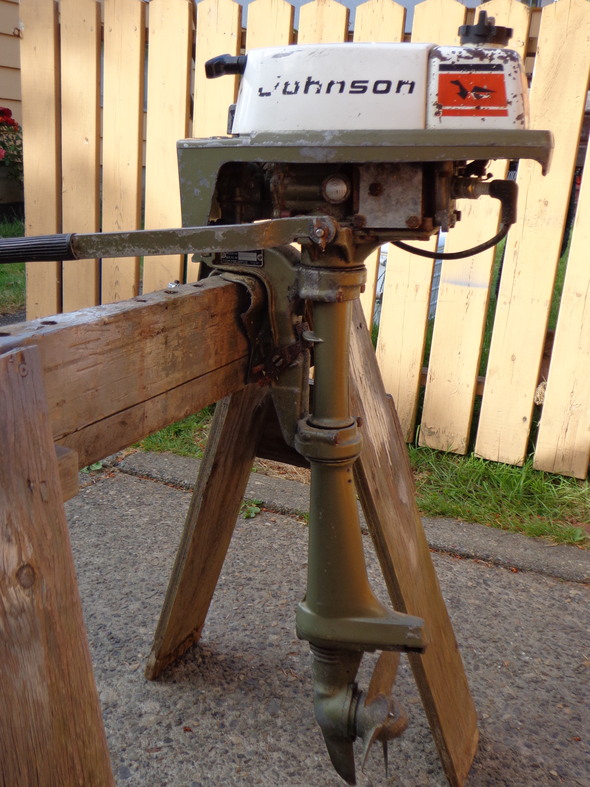

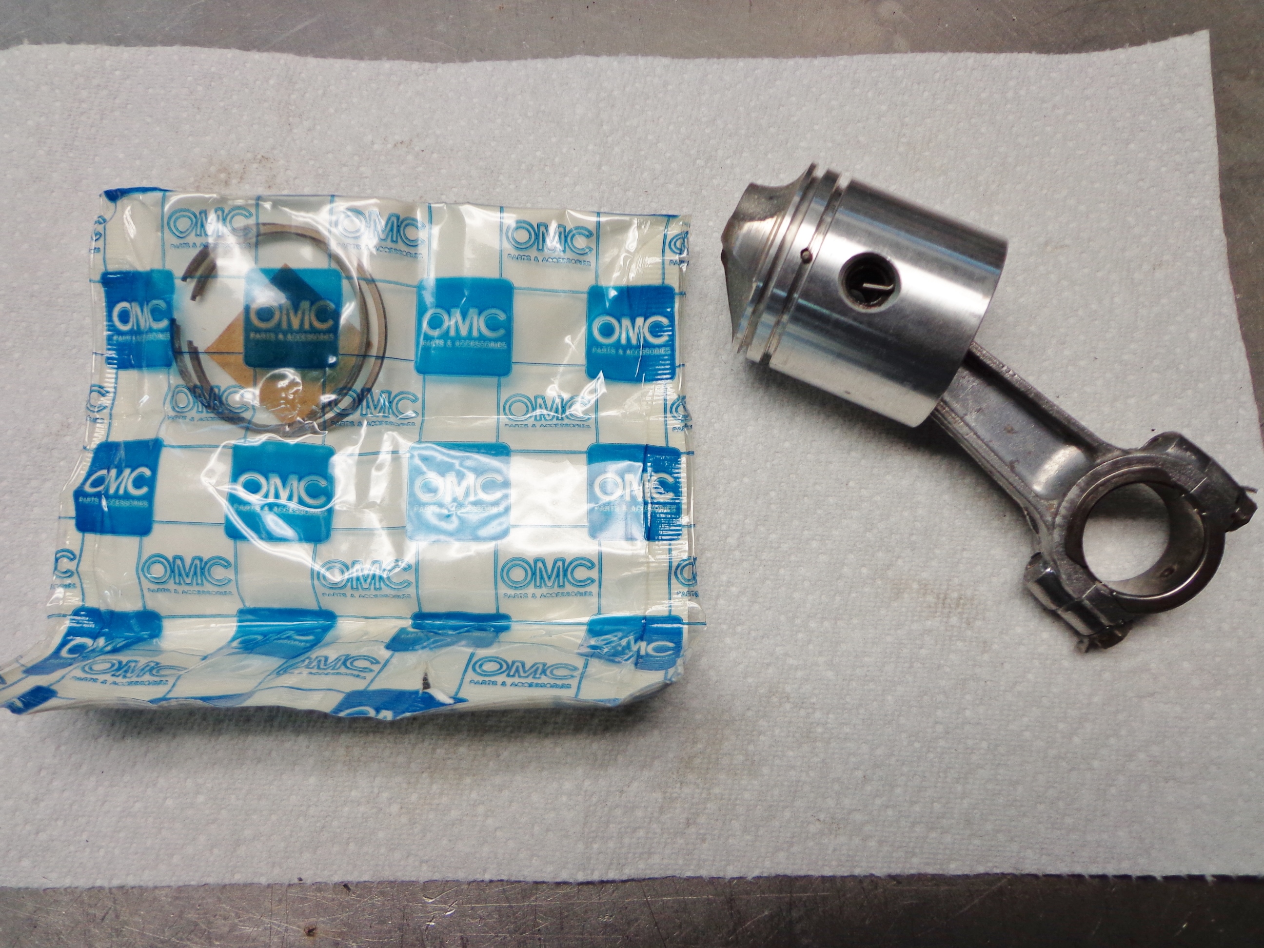

                  Here’s a ’72 two horse which never did seem to want to run right. It kept getting harder and harder to start and finally wouldn’t start at all. Under the head I found a blown head gasket with a matching burn thru groove in the top of the cylinder. A little bit of time in the lathe straightened out both the head and the cylinder. The local dealer brought the crank seals in but I had to order new bearings from China. A new piston and rings were found online so hopefully after a new paint job and decals it will run again.

                    #36513
                    PugetSoundBoater
                      Good work Mumbles. I havn’t seen the insides of one of these till viewing your photos.

                        I’ll post a vid later whenever I get it together. Not sure when.
                        Did I say ’72? I think this one’s actually a ’73 and another one I had was a ’72 motor. They all start to look the same after a while.

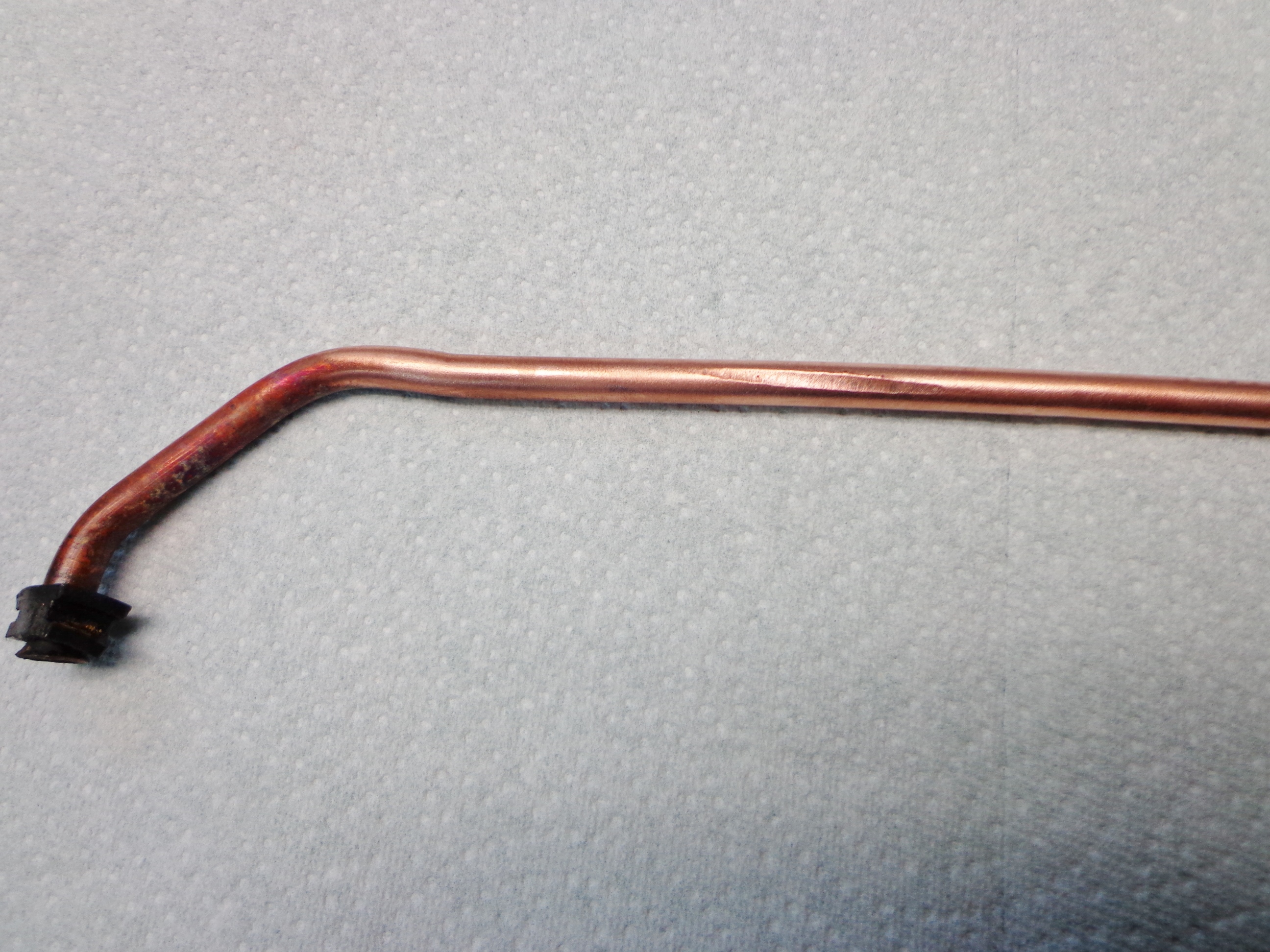

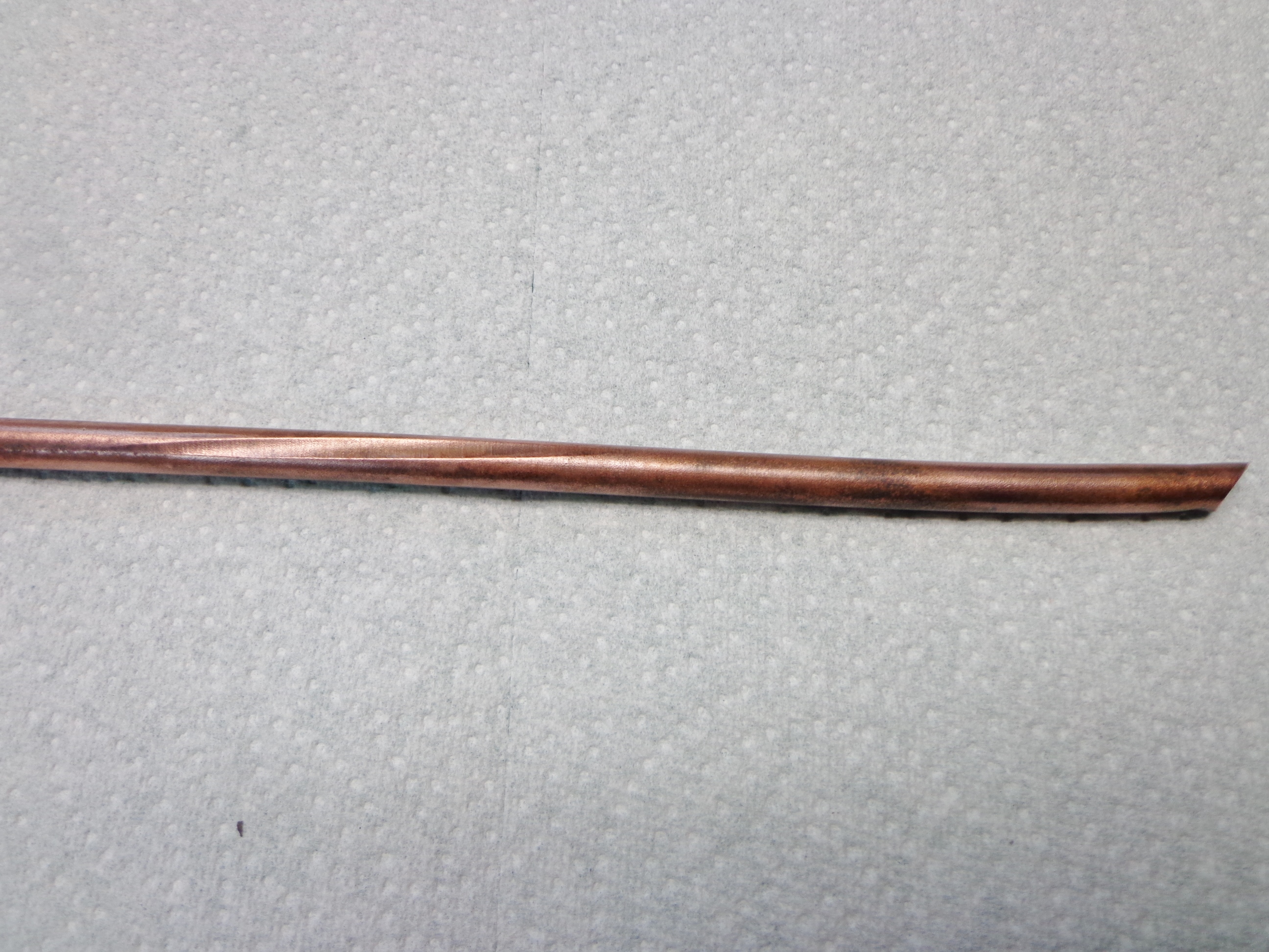

                        Here’s another reason I’m glad I tore it down. The water tube had been rubbing on the driveshaft and was almost worn thru. 😯
