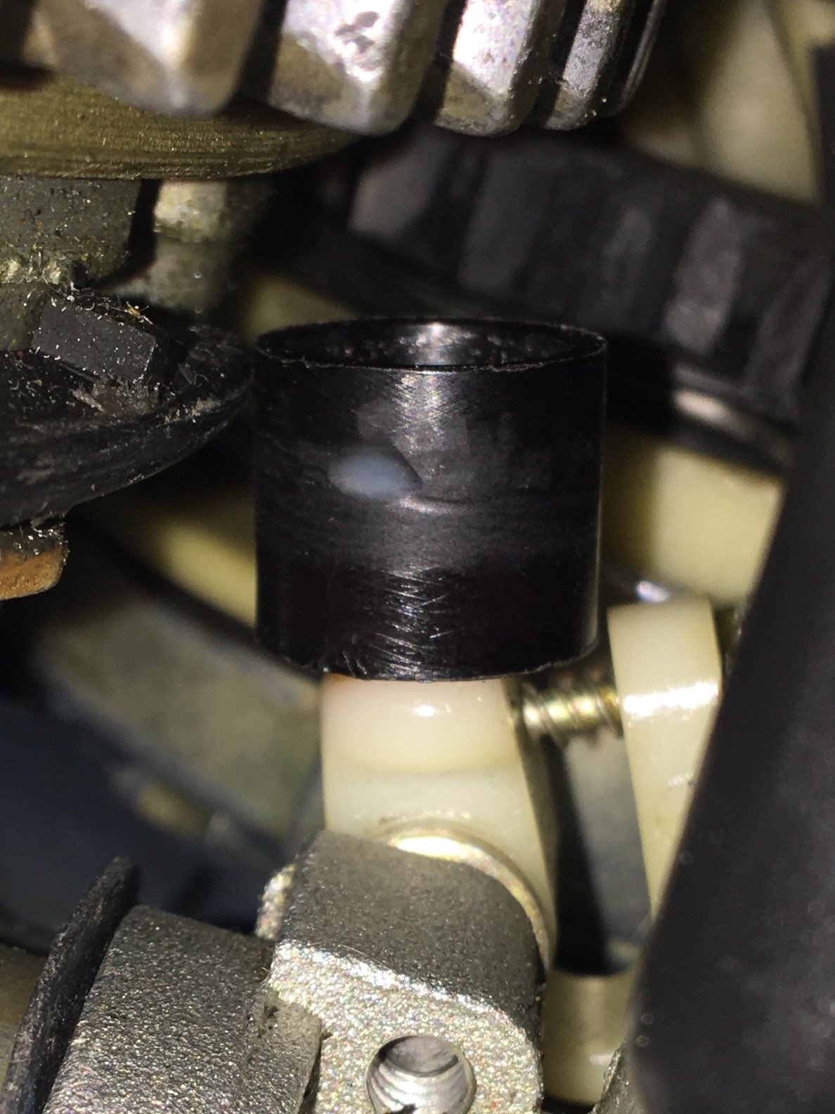

      May I please have an exploded drawing, or parts list, for the powerhead of my ’79 9.9 HP?
      I don’t even know what the part is called. It is related to the recoil starter, and appears to be a pawl – like part which may engage when the recoil is released. It’s black, plastic, and has a small spring which fell out and down when the plastic broke. Dag nab it. And yeah, I am somewhat embarrassed that I can’t give a better description. It’s at the top of the throttle shaft. I hope the pic helps.
      And, if anyone can figure out my vague description, is there any way of replacing this w/out pulling the flywheel?
      Many thanks!
      Alan

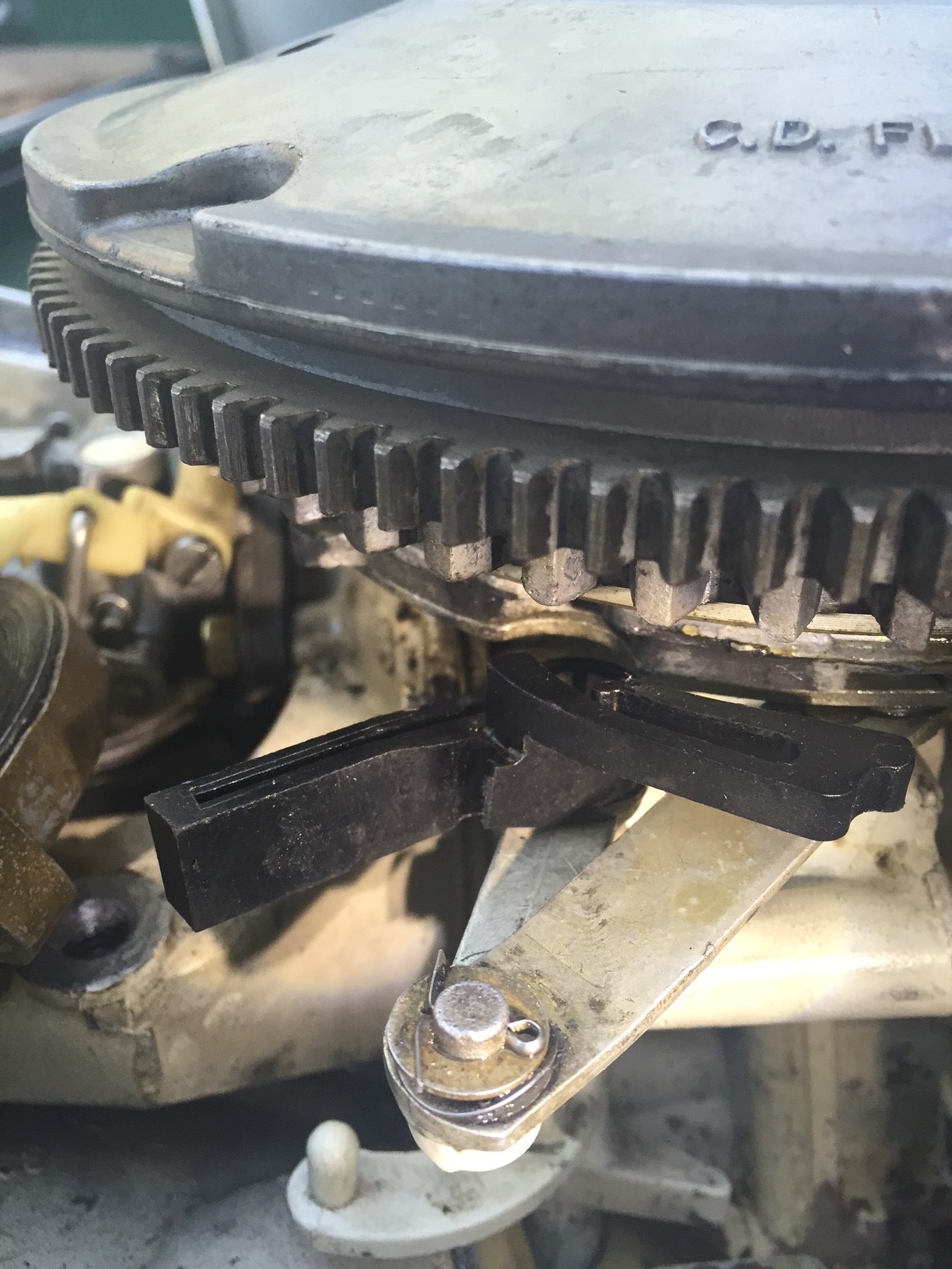

              The plastic ratchet thing’s spring on my 89 9.9 was bent and distorted when I got the motor. I removed the whole thing and left it off. It is a safety interlock that won’t let you start the engine in gear.

                      Update; wow Fleetwin, pulling those two screws was so simple and obvious! Worked perfectly.
                      I thank you for your gentle reminder.
                      #43284
                        Instead of pulling the flywheel, you can probably just remove the two clamp screws holding the vertical throttle shaft in place, move it out from under the flywheel slightly, and remove the plastic recoil interlock.
