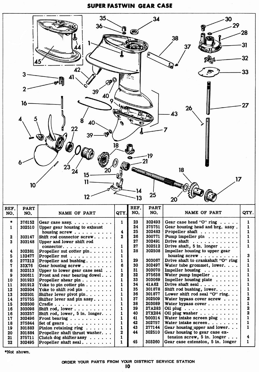

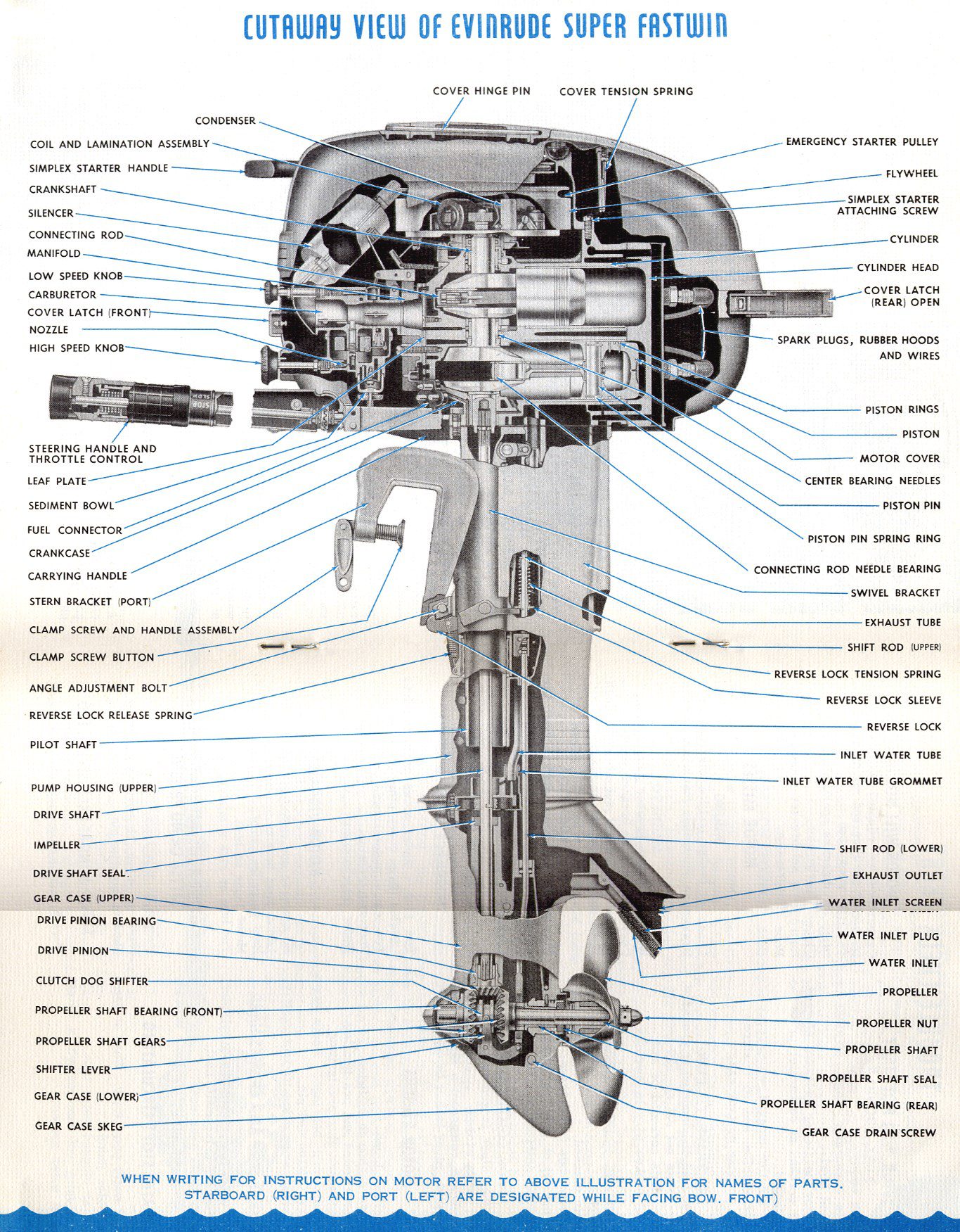

                  #285838
                  Steve D
                    Here’s the Gearcase page and a cutaway. I’ll post a link for the whole parts manual soon in pdf format…the file’s a little too big to post here.
                    53_15HP-pg10-Gearcase
                    Evinrude-Super-Fastwin-15012-Cutaway
                    #285841
                    Steve D
                      1953-1954 Evinrude 15HP Super Fastwin Parts Manual link good to download for 7 days…
                      https://we.tl/t-oFw337RjA0
                      Others know who make up seal kits for this motor. If you had to buy individual pieces, driveshaft seal 41A62 is 321788.
                      And prop shaft seal 302495 is also SKF 6280 on ebay right now for under $20.

                        couldn’t find on eBay, it has a spaghetti seal and I wonder if those that have it might be worth a try? They say they are for 18hp an up models?
