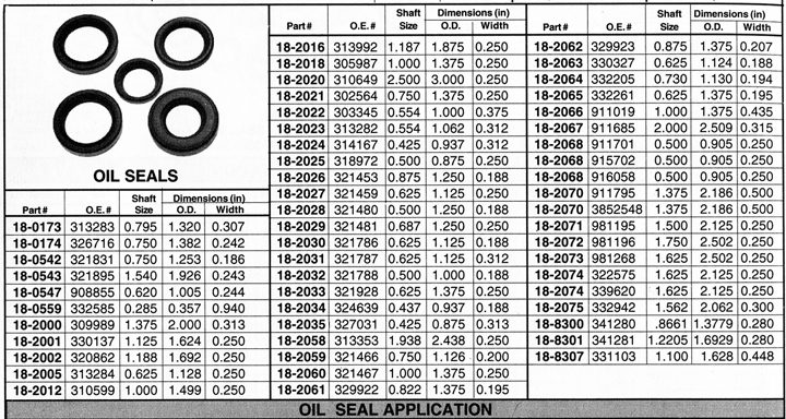

                    #275847
                    labrador-guy
                      Maybe this chart will help.  I knew I had it someplace!  Stupid thing won’t load!
                      dale
                      #275850
                      Steve D
                        Dale, Wondering if this is the one that won’t load for you? I forgot I had it until I saw your post.
                        OMC-Seals-chart
