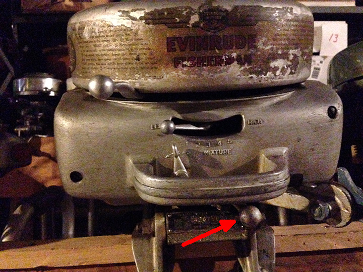

      Can someone tell me what this handle is for? Doesn’t seem to do anything.
      #34301
        In theory when engaged, it prevents excessive shaking at idle.
        #34324
        tom-c
          Hmmmmm…..it doesn’t seem to engage with anything!
          #34325
          Tom
            IIRC, it puts tension on the rubber balls between the tiller bracket and the tower housing.
