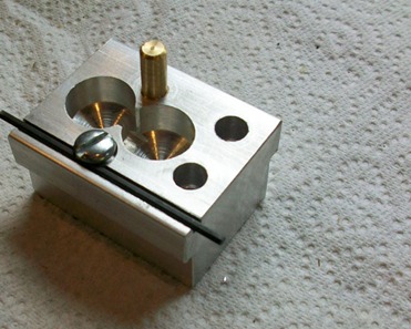

              Started right up! Impeller seems to be pushing a lot of cooling water. Fuel/air connection is leaking though. Do these connections come apart? Thought there might be O rings to replace but I can’t see how to take them apart. Probably just order new ones?
              #54759
                The connector comes apart to replace the O rings. Having the proper fixture to hold it while doing this makes the job a whole lot easier and the one pictured is made and distributed by club member Frank Robb. Using the proper OMC/BRP 301824 O rings will make sure it doesn’t leak anymore.
                http://www.franksoutboardtools.com/
                http://www.franksoutboardtools.com/fuel … xture.html
