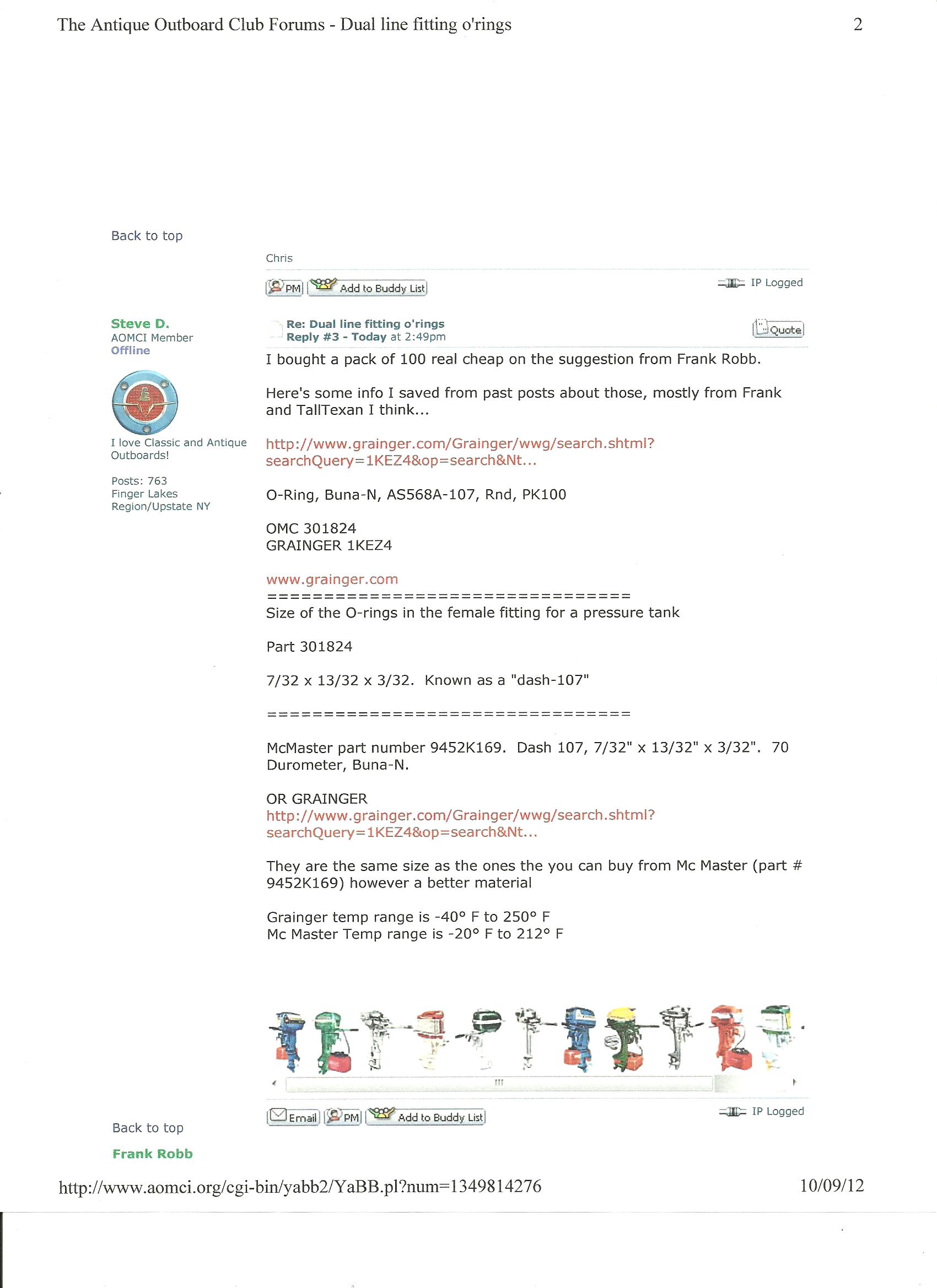

          I’ve been using the o-rings from McMaster Carr for a while now and they work perfectly. They’re not the over sized fat ones. If you don’t have an OMC/BRP dealer near you I can send you some. I just bought a bunch.
          #54791
            Do you remember posting this Steve?
            #54794
              Here is the Service Bulletin . . . ๐Ÿ˜€
              #54797
              Steve D
                quote Mumbles:
                Oh yeah Mumbles, I was surprised when I ordered these the other day that the price stayed pretty much the same. And thanks for posting that bulletin Garry!
