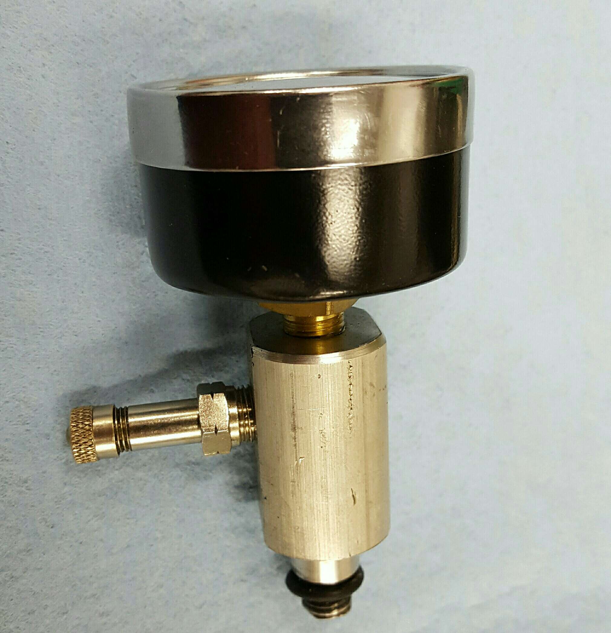

        For my pressure tester I used a piece of aluminum round bar stock. I threaded it for 3/8-16 on one end with a step for an O-ring. I drilled a hole thru the center. Drilled and tapped for a 0-15psi pressure gauge in the end opposite the 3/8-16 thread and a cross hole drilled and tapped for a Schrader valve. I have used it with a bicycle pump, but prefer regulated compressed air. I’ll try to post pics again soon. For some reason it isn’t working right now.

        #79308
          Ben, I found this one on this site.
          I was thinking "bicycle pump" just to be sure
          I didn’t over pressurize the LU and blow a seal out!

                fisherman6
                  quote Buccaneer:
                  I was thinking “bicycle pump” just to be sure
                  Buc,
                  That’s my tester. 😉 I either use a pressure regulator, or only pump up the compressor tank to 10 or 12psi when i use my tester. That way I dont overdo it.
                  -Ben
                  OldJohnnyRude on YouTube

                      Just don’t be fooled by faulty gage set ups…I am not criticizing home made stuff, I have had plenty of Stevens testers show false leakage in the gearcase, when the true problem was a gage issue, hose, valve etc…
                      I guess what I am saying is that if the gear lube comes out without showing signs of water, I would probably just refill and run it…Needless to say, I would change gear lube frequently to ensure all is well. Running it "as is" will give you a chance to make sure the clutch dog is OK as well…
                      Needless to say, if the lube shows signs of water, then you should pressure test to find the actual problem before resealing…
                      Oftentimes test equipment that was designed to help us, ends up confusing us with false readings/wrong conclusions….

                        Sounds like good logic Fleetwin.
                        Making a pressure tester is on my "list". I would think it would
                        be handy also when you know you have a leak, but not sure
                        where. Haven’t tried draining the LU yet. Clean and sandblaster
                        some parts this morning. All afternoon has been mowing and
                        tending gardens. 🙁
                        Thanks.
