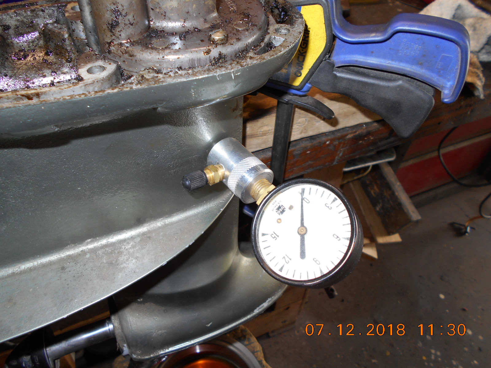

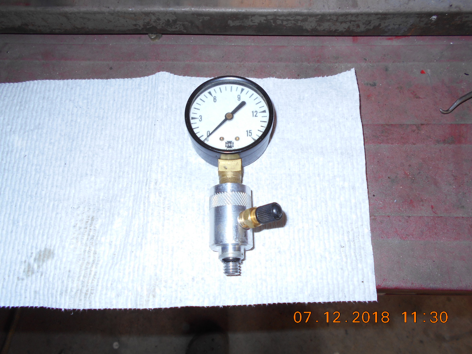

        #79452
          I made me a lower unit pressure tester this morning.
          Hopefully I didn’t infringed upon one of your patents. ๐Ÿ˜ฎ
          Hooked it up to the subject motor and gave it a few pumps
          and heard air leaking right away. Some soap suds confirmed
          it was the shift rod seal.
          The LU oil I drained out was fresh as a new picked daisy,
          but the PO probably changed it before it was laid up.
          No clue of how many years since it was run.

            #79457
              I think I’ll let "manufacturing" tools for sale up to Richard!
              I had all the stuff on hand, but it took me about 2-1/2 hours
              to get er done. My mere lathe skills are "on the job training",
              and I do a lot of "winging it".

                      #79465
                        I’m not sure myself. What’s the general rule fellows?
                        My shift shaft seal was leaking so bad it didn’t hold
                        any pressure, but the gauge would bounce up to 3 to 5 psi
                        as I ran the tire pump.
                        quote NJ-boatbuilder57:
                        What PSI do you test to?
