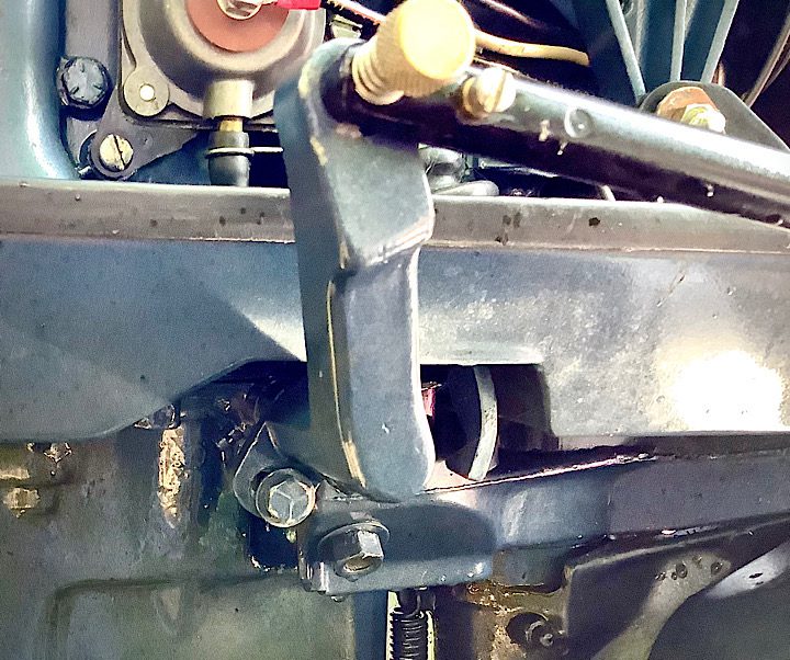

      Don, when I shift into reverse with my Simplex that I rebuilt with all new parts (below), if I don’t hold it in reverse it comes out of gear.
      Good point…..let me disconnect the cable, and just try using the shift lever on the motor and see what happens.

          REVERSE FIXED….. ok Bill W / Don wins the prize for this one. Thanks gents.
          It turned out to be the shift shaft horizontal adjustment. Pulled the boat out of the water, looked at the shifter and it wasn’t going into the forward indent properly (although forward was never a problem). Loosened  the bolt and it popped properly into forward . Well I guess the rest of the geometry fell into place, and now reverse is fine. Should have looked there first, but needed the forum to jog my memory. Thanks again everyone.
          Now on to my next problem. Boiling hot water coming out the discharge. I’ll start a new post for that one.
          Bob D

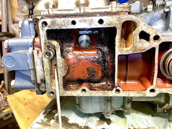

                #278350
                  OK, so engine temp seems normal, correct?  It could be nothing more than the hot summer temps we are enduring now, especially if water flow seems normal.  The exhaust housing gets real hot though, correct?  Does kind of sound like the issue we uncovered with your 10hp, there is that little bleed hole on the bottom cylinder’s cooling passage that is supposed to cool the exhaust housing.  But, you mentioned the block was dipped/tanked, so you would think that would have gotten cleaned, but you never know.  I wish I had one of those blocks to help locate that hole for you, do you still have the original block for investigation?  Normally, I would say this is no big deal, except I don’t want your beautiful paint job getting ruined on the exhaust housing.   I guess I might try running the engine at night, or early morning before it gets too hot out to see how it behaves then before getting to concerned.
                  #278352
                  bob-d
                    Don, unfortunately I was running the motor during a cool late evening when I noticed the steam/ water discharge out the exhaust. I really don’t know how to gauge if the block and head are at the correct temp other than by hand feel? I didn’t bring my infrared digital temperature gauge on vacation.
                    I have the original 28HP block and will poke around to see what the bleed hole looks like. Will post some pictures of the underside of the block for you to take a look at.
                    Thanks,
                    Bob D
                    #278359
                      Well, I’m not sure I would worry about what appears to be steam…  Perhaps it is alot of condensation from warm/wet summer climates.  These engines don’t have a thermostat so should run relatively cool, perhaps warm, but never hot.  The exhaust manifold should also be relatively cool/warm.  The hand/feel method is usually sufficent in these cases.  How about the top of the exhaust housing, just under the powerhead, how does that feel?
                      #278360
                      bob-d
                        Don, the  exhaust manifold seemed ok, but the exhaust housing under powerhead was blistering hot. Exactly the same as my 10HP 58 Johnson.
                        Here is a shot of the underside of the 28HP . The only bleed hole I could find is shown with the pointer.
                        I guess the next step is to pull the 33HP head and check the bleed hole?
                        Thanks,
                        Bob D
                        IMG_3002
