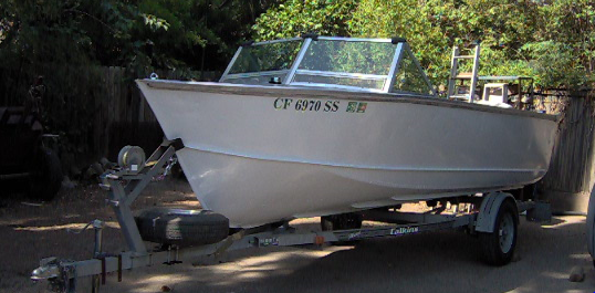

        Old boat was a 16′ aluminum, 450 lbs; this one is a 19′ aluminum, 950 lbs. Heavier, but not so very heavy. Modified V-hull that goes about flat, so it shouldn’t be all that hard to plane, should it?
        The prop is well below the hull; I don’t think it’s a drag issue.

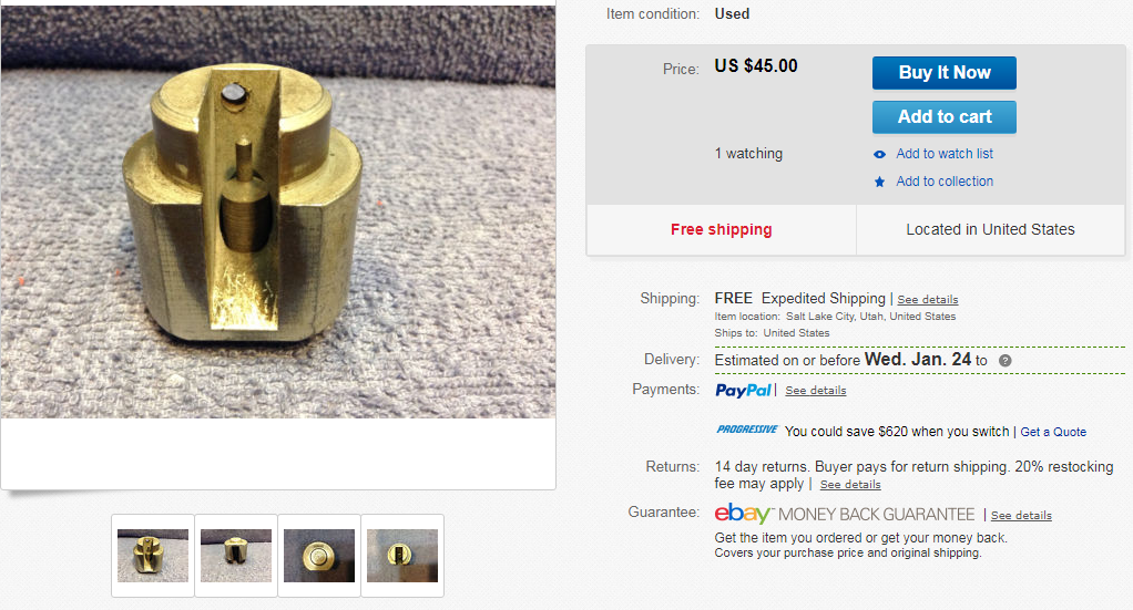

            As for the venturi tool, please let me know if what I need is pictured below.

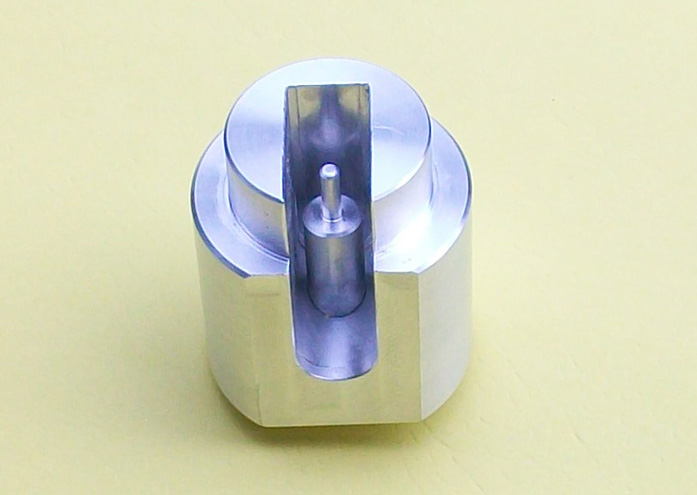

              Yes, that is a venturi locating tool, but can’t tell the size. One size fits 50-60hp another fits 75hp-up. I seriously doubt that is the problem in your case though. It makes a small difference if it is not located, but not to the extent you are experiencing.
              #69851
                The 75-80hp tool measures 1.250" where it fits into the carb bore. I made a couple of them back in the day.

                        Nice machine work, Frank R! Yours looks better than the one being auctioned.
                        I have a pretty good eye; I bet my nozzles aren’t very far off; glad to hear that’s probably not a major factor. I tried two props; don’t think they’d both misbehave in the same way, even if both had bad hubs.

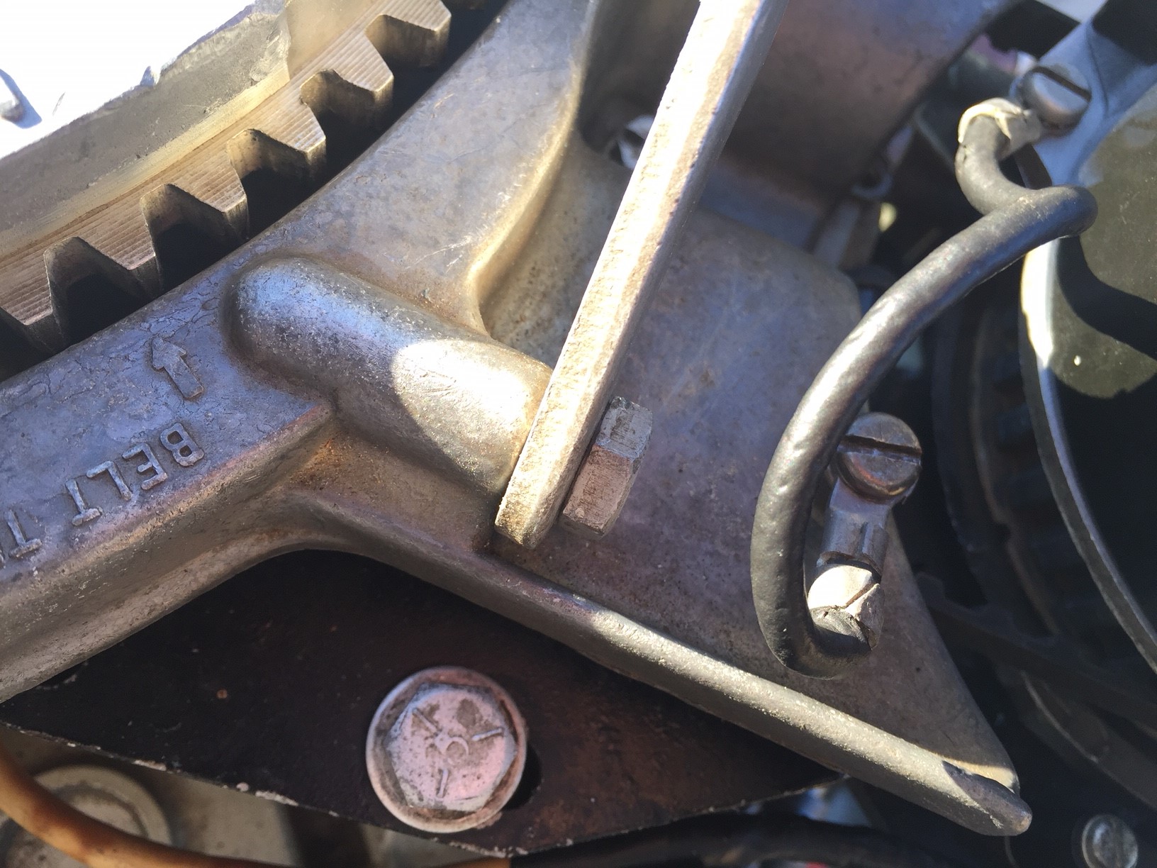

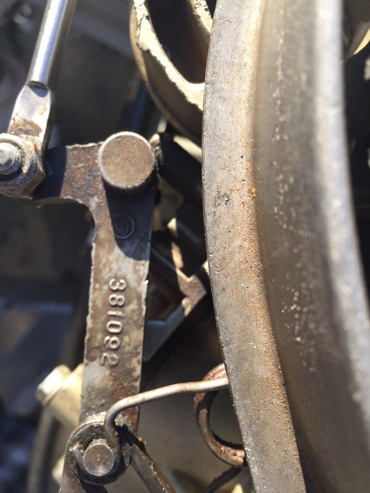

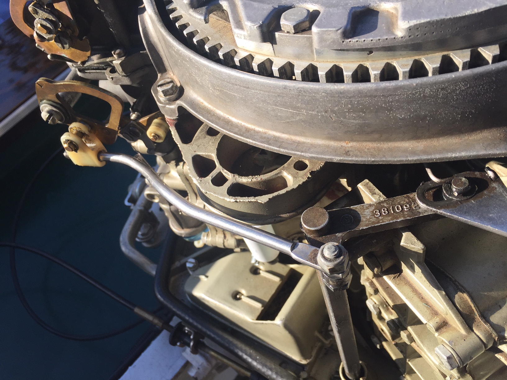

                        I think the belt timing has been OK, despite the flywheel R&R. The belt timing is (I hope) the first pic. I timed the belt with the throttle closed; y’all please let me know if I got that wrong.

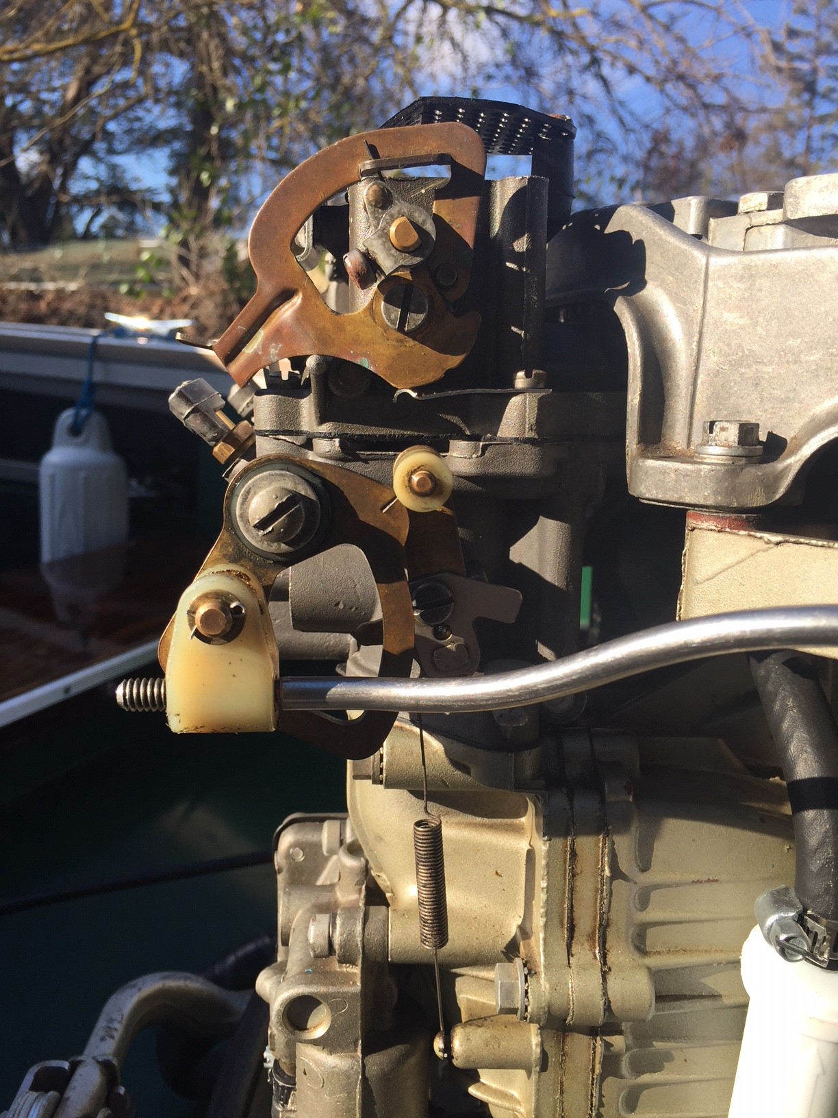

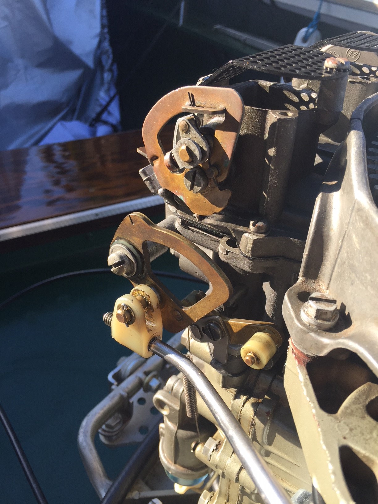

                        I’ve included pics of the carb with the throttle closed, and wide open. One pic has the distributor fully advanced; hard to see but the linkage is parallel with the triangular boss on the block. The last pic is the linkage, with the throttle wide open. The throttle keeps going after the distributor is fully advanced, (which looks correct, with the spring in the linkage).
                        The distributor pulley has not slipped on its shaft. I didn’t pry it off, but after pulling the points cam, (which was right side up) and nut, I can feel the key in the correct slot with a probe.
                        Anything else to check, before I reassemble the distributor and move on to the carb?
