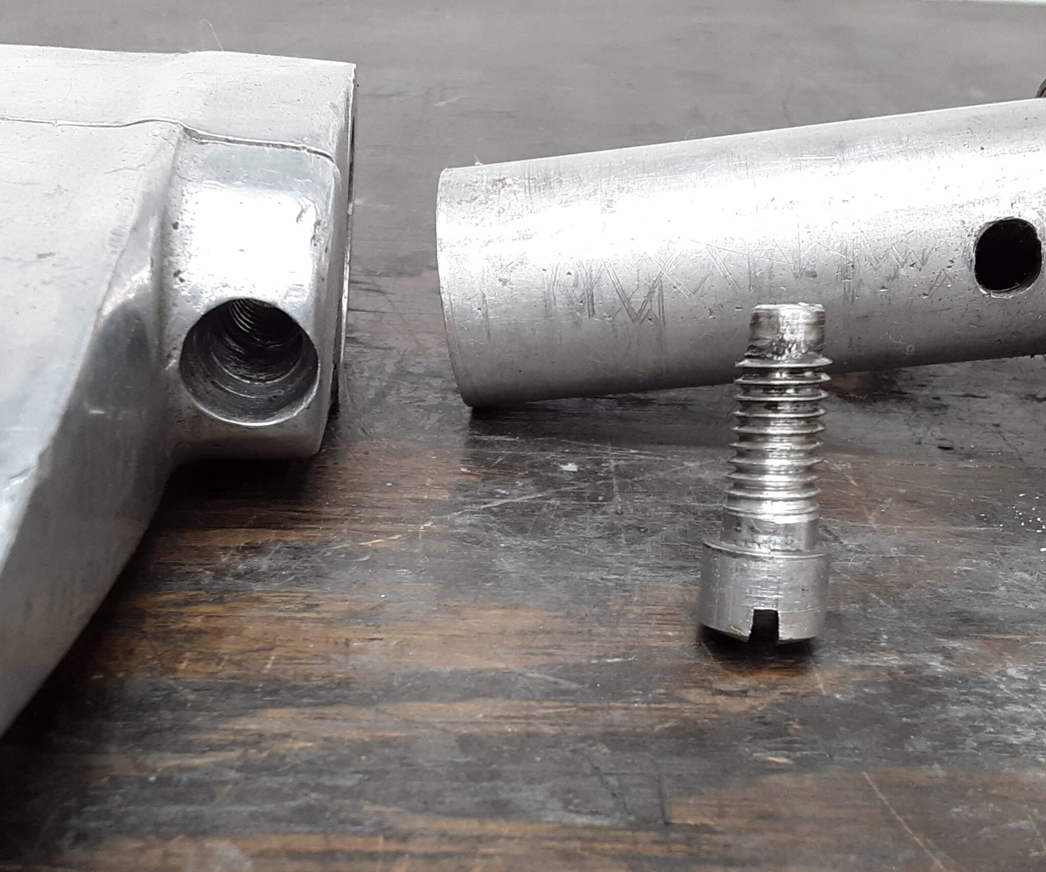

Asking for advice on disassembling the lower unit.
I’m not sure (see pic) if I have a dowel or screw with the head twisted off in one location.
Thanks
T…
June 10, 2024 at 10:20 am #288223There are no “dowels”.
June 10, 2024 at 10:37 am #288224Okay, so to confirm that’s a screw with the head twisted off.
Is there any diagram available other than the Service Manual that’s been posted on this site.

June 13, 2024 at 8:22 am #288280I’ve since learned, been informed, these are rivest and not screws with twisted off heads.
At this point in the process its good to know what you’re dealing with as replacement parts are a rarety.

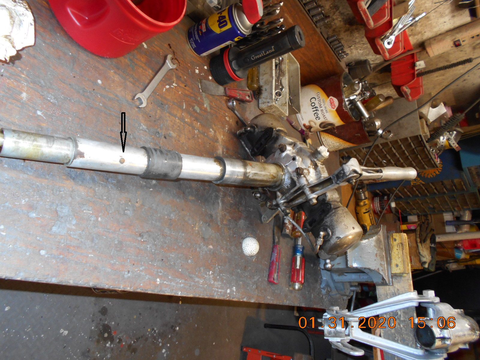

The prop shaft should come straight out. Slide off the drive shaft gear, you might have to take out the key, and you will be able to remove the drive shaft. This is a 26 T but they should be similar. Tubs
June 20, 2024 at 9:11 pm #288451If I’m following this correctly. The prop shaft will slide out from position shown in this pic. Pulling up/out on the shaft it hanging up on what I’m not sure. I’ve tried rotating the prop shaft while pulling up/out. I’m missing something.
