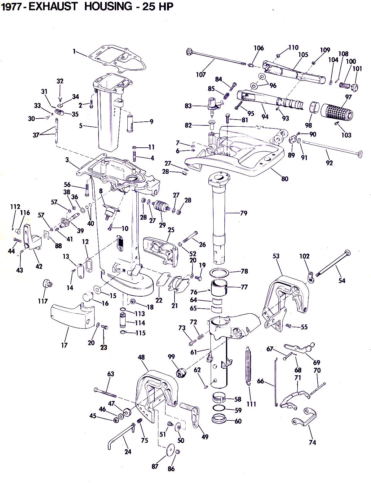

              #251379
                Spacer tube is missing from atop of the water pump.
                #251380
                  #114 spacer & 113 o-rings
                  14.-Exhaust-Housing-25hp
                  #251405
