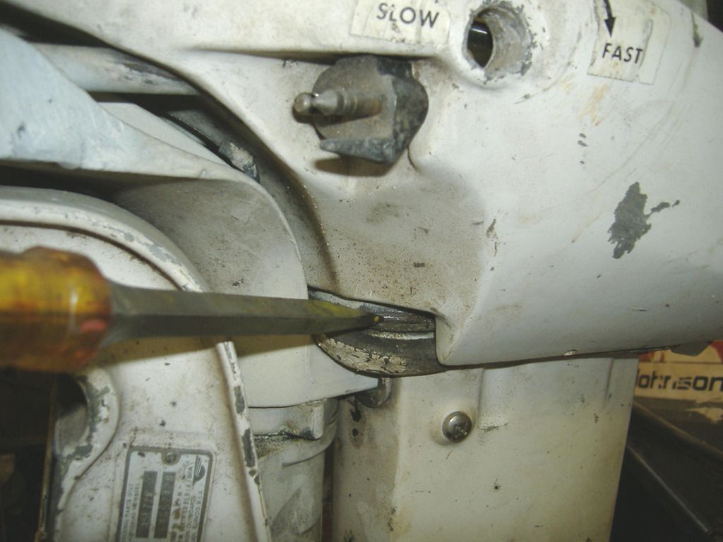

        Courtesy of Leroy’s Ramblings….here’s a photo of the good spot to apply leverage to break the powerhead free.
        #41864
          OK, well Leroy is surely prying in the right area, because it is the lower seal housing that makes these powerheads tough to remove.
          But, he is playing with fire jamming a chisel between the powerhead and ex hsg mating surfaces, damage to both surfaces seems inevitable.
