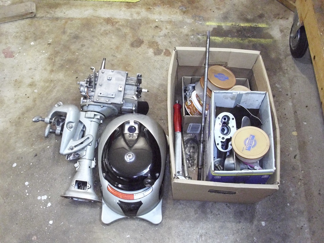

            bullie
              Played with this one some yesterday. It is easily the most expensive motor I have that doesn’t run. Nothing is cheap on a Martin. At this point, I have about $150 in this on plus what I paid for it. sheesh. After new gaskets, the gas tank is no longer leaking so good thing there. For some reason, gas is pouring out of the carb, maybe the float is stuck, this is a new problem. And, the pull cord broke on the 3rd pull. I started it with my drill and it ran ok except for the leaky carb. It heated up pretty fast though so I shut it down. I don’t see any cooling water blowing out anywhere. This thing is like going to the chiropractor. LOL I have to work on it a little at a time. I forget about the money after a few months and start on it again.
              Advice on the pull cord replacement and water pump?

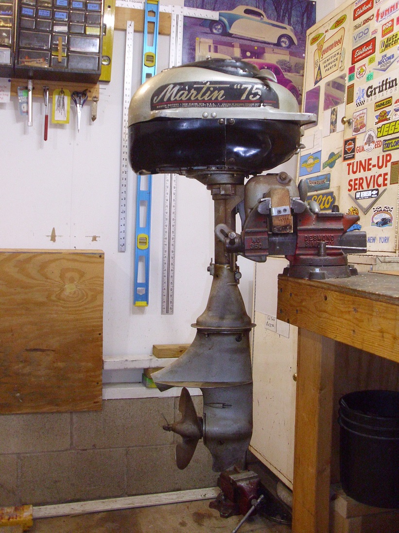

              #73357
                I’m going to have about $350.00 in a 75 Twistshift.
                Maybe a little more. About 200.00 of that will be going
                to Russ Larson but that’s because he has about anything
                you could want or need for these. His seal set is
                $50.00 but at $25.00 for the power head and $25.00
                for the gear case. I don’t think that is out of line.
                Impeller is $18.00. Not out of line for most 60+ year
                old motors if you can find one. I could have saved
                $45.00 by making my own gaskets but that’s for
                every gasket in the motor including the carb and the
                gas cap seal. Most of the motors I work on the only
                gasket I can get comes on the spark plug. He has LU
                gear sets from $30.00 to $40.00 and $50.00 for the 200.
                That’s $15.00 to $25.00 a gear. I’d be glad to pay that
                and more for some of my pre. WW-II motors but they
                aren’t even available. The problem with these is there
                isn’t a strong interest in them. I suspect that there will
                be little interest in asking for anything over $200.00
                for it. So getting to learn about them, repair it, and
                then to use it will justify what I spend. I haven’t need
                any special tools to work on it. I’m still weighting on
                parts so I haven’t started to put in back together yet but
                I don’t expect anything to be difficult. It has several
                interesting features and I’m really looking forward to
                using it this summer.
                #73367
                WAYNE
                  The carb float is brass. It’s not uncommon for them to leak at the soldered joint.
                  Wayne
                  Upper Canada Chapter
                  uccaomci.com
                  #73395
                  bullie
                    quote wbeaton:
                    I will check that out. Thank you.
                    It was running well and the carb was functioning fine (from a remote tank) when I discovered the leaky gas tank. It was quite some time before I got around to working on it again and I stored it at a weird angle. Maybe I will get lucky (finally) and it is just stuck open.
