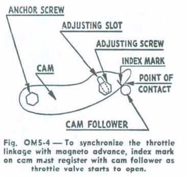

        http://boatinfo.no/lib/johnson/manuals/ … on.html#/0

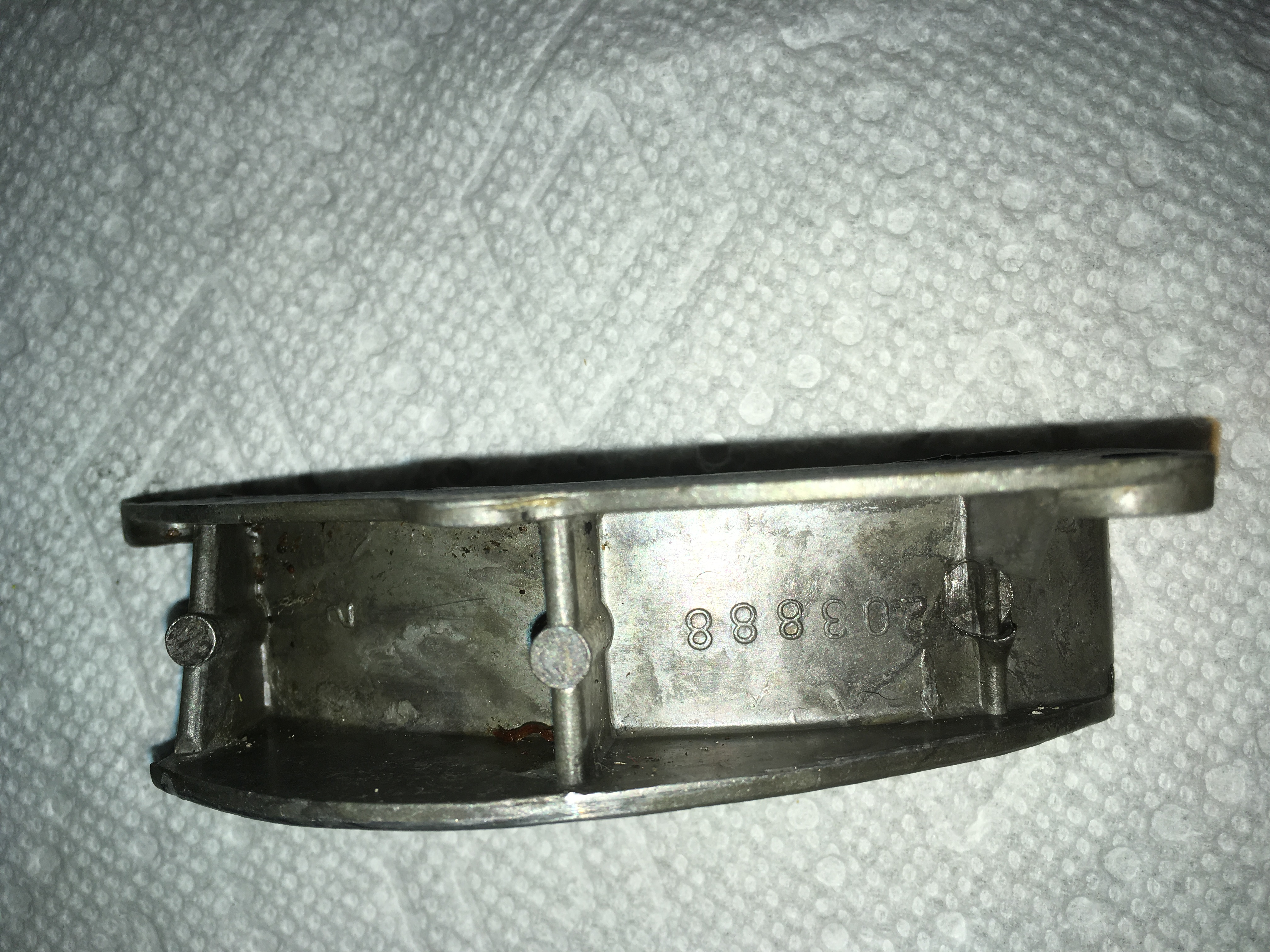

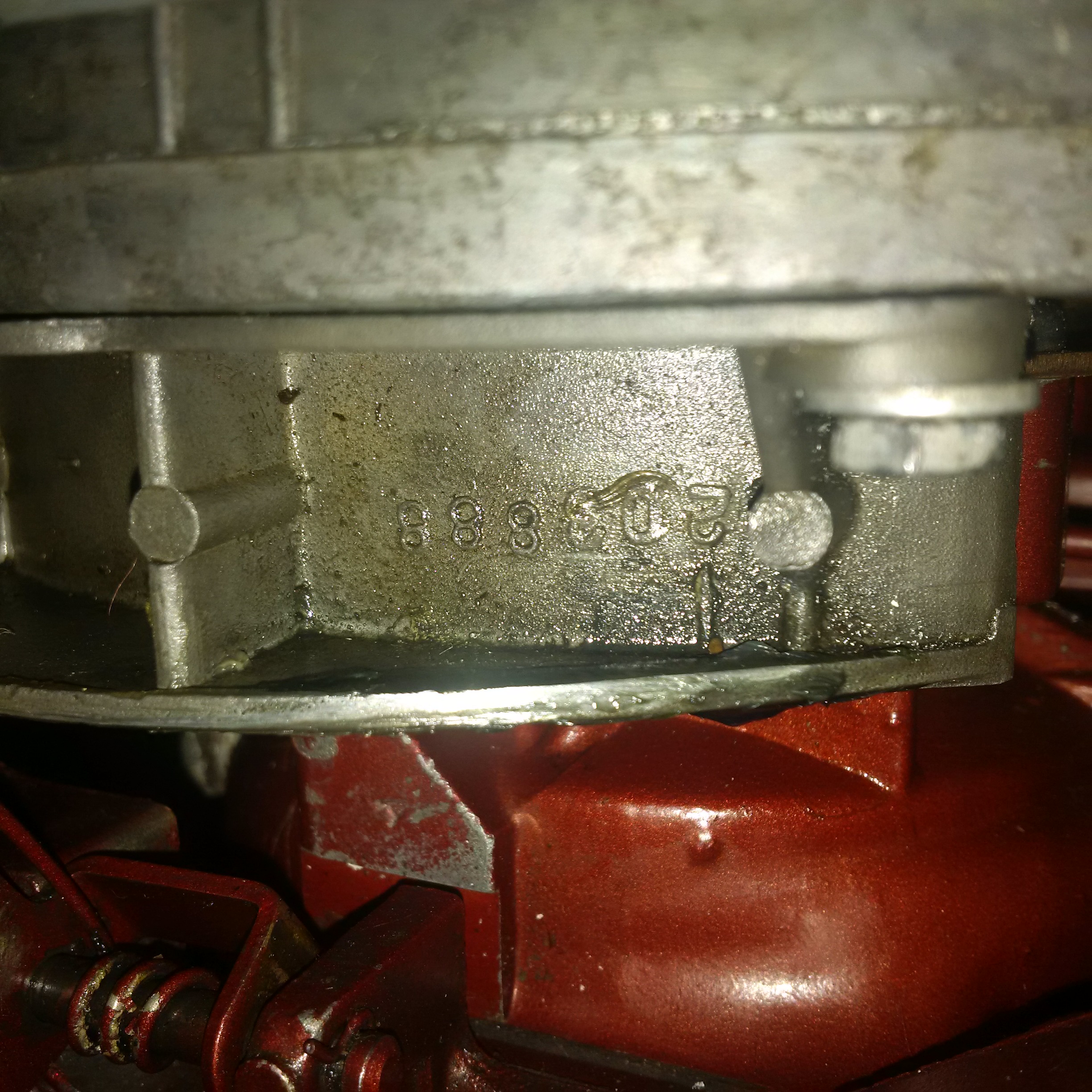

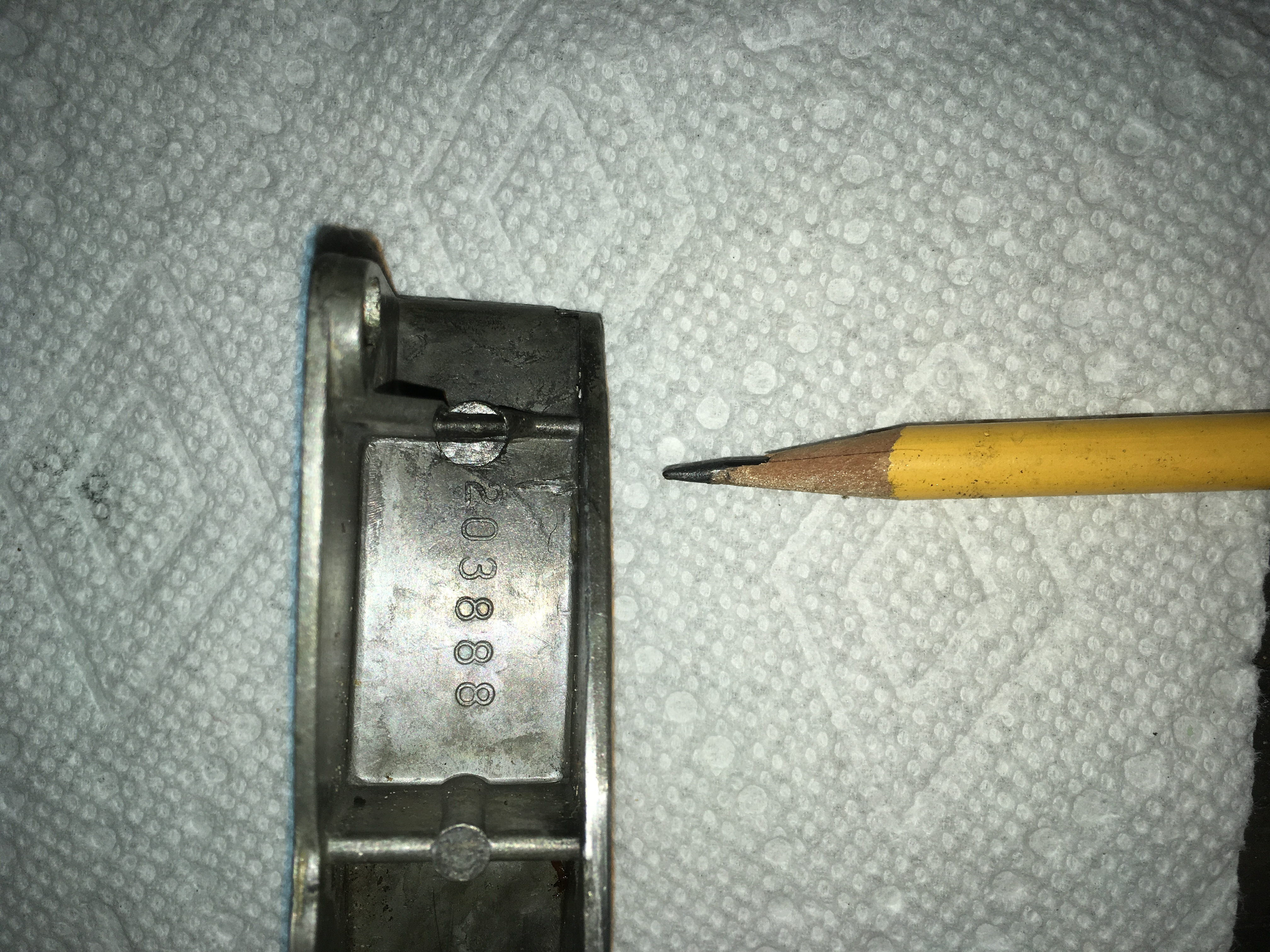

                In the pic with the pencil you can see the casting mark and the pencil is pointing at a "possible" mark, or it could be a casting flaw.
                #51088
                david-bartlett
                  Well for now I put the cam back on and used the mark I pointed at with the pencil. This will get things close enough to run and I can tweak it more in the Spring.

                      I checked out my AD 10 and my Evinrude Fleetwin 7.5 and both have a clearly cast in "mark" in
                      exactly the same place on the cam as you show with the pencil point. I guess yours was just not
                      "marked" well when it was cast. My throttle follower makes first contact at that point as it
                      should so I think you would be correct in using your "fuzzy" mark as you have.

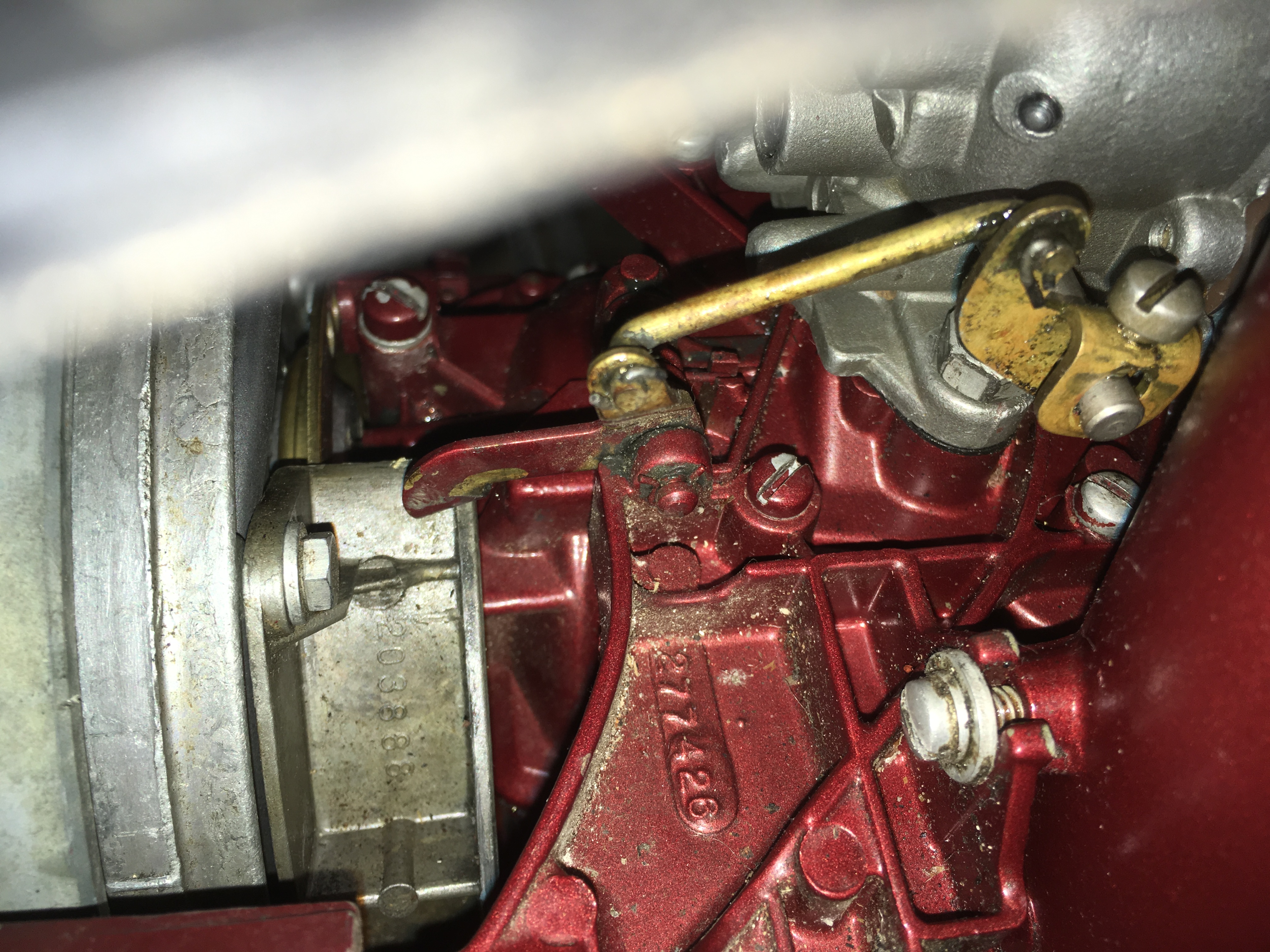

                      wedgie
                        Here’s my AD 11 that I just winterized halfway through winter. 😳
