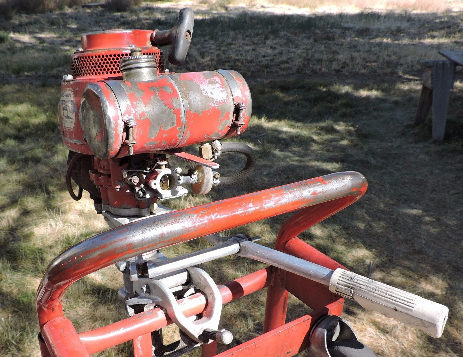

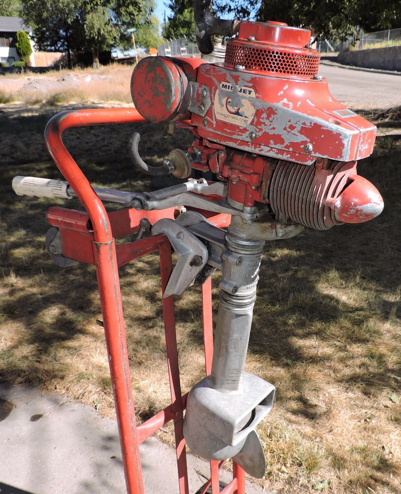

          The motor is complete when compared to the sales advertisements. There are no holes anywhere for additional shrouding. Its possible the cooling fins on the flywheel aren’t providing enough air flow. The recoil works perfectly and the motor starts easily. The recoil and jet drive are the only reason to have this motor IMO. I’ll be keeping it as is. I would like to find a good photo or illustration of the tank decal so I could reproduce it. Mine is painted over.

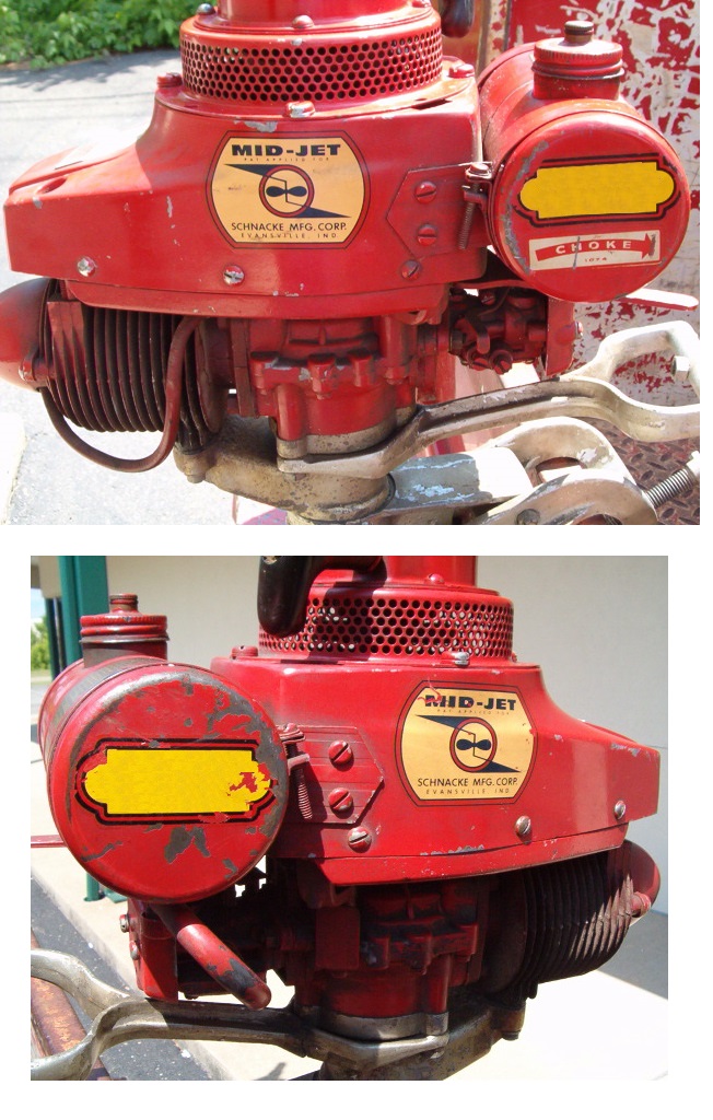

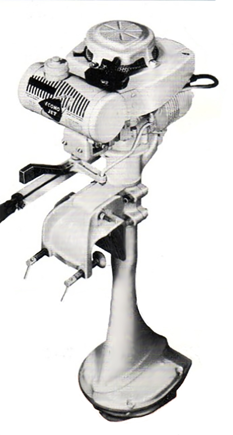

            Here are some pictures (I only have pictures)
            of what looks to be the same power head as
            yours branded as a Schnake Mid-Jet. It is also
            a jet drive motor but a different configuration
            than yours. As mentioned by others your motor
            doesn’t seem to have some of the shroud used to
            direct the air around the cylinder for cooling that
            this motor has. It would seem though that if your
            motor ever had these there should be holes.

                Hard to tell from the ad what the actual decal would look like – if you wanted to fake it. . . 😆
                #49197
                  The Mid Jet looks almost identical except for the recoil and the extra blower housing skirts. Same power head, same blower housing, same heat….except for those skirts. I wonder when those skirts came to be, like what year in the Tecumseh time line? They are definitely an add on, either factory-add on or home made. Maybe, just maybe, the Cal Jet had a wide-spread problem and yours was not the only one? I would love to see whether those Mid-Jet skirts are just straight down or whether they have a stamped, more flow-inducing shape underneath.

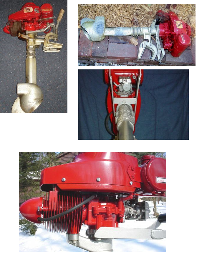

                    This is the best I have. Sorry.
