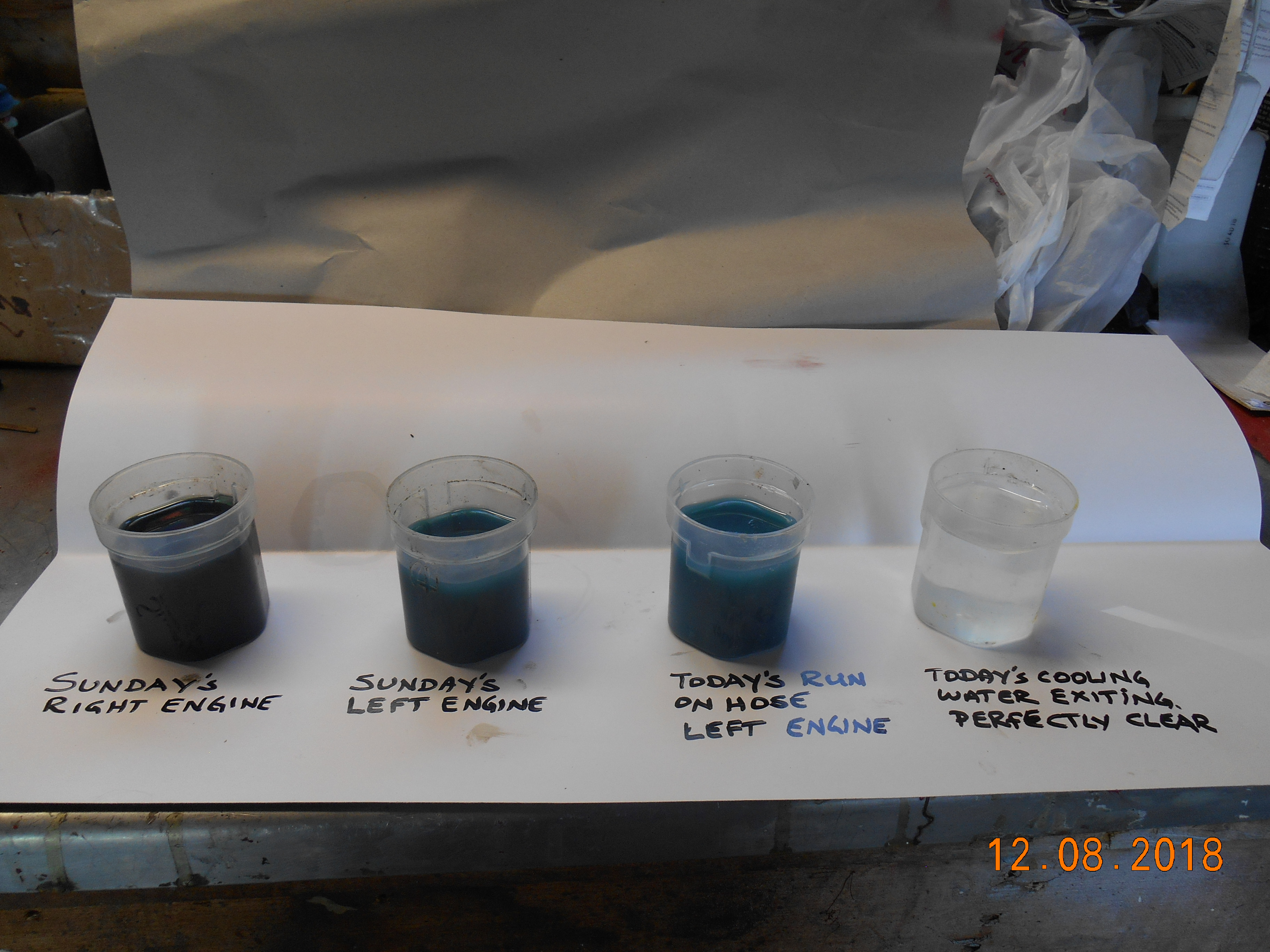

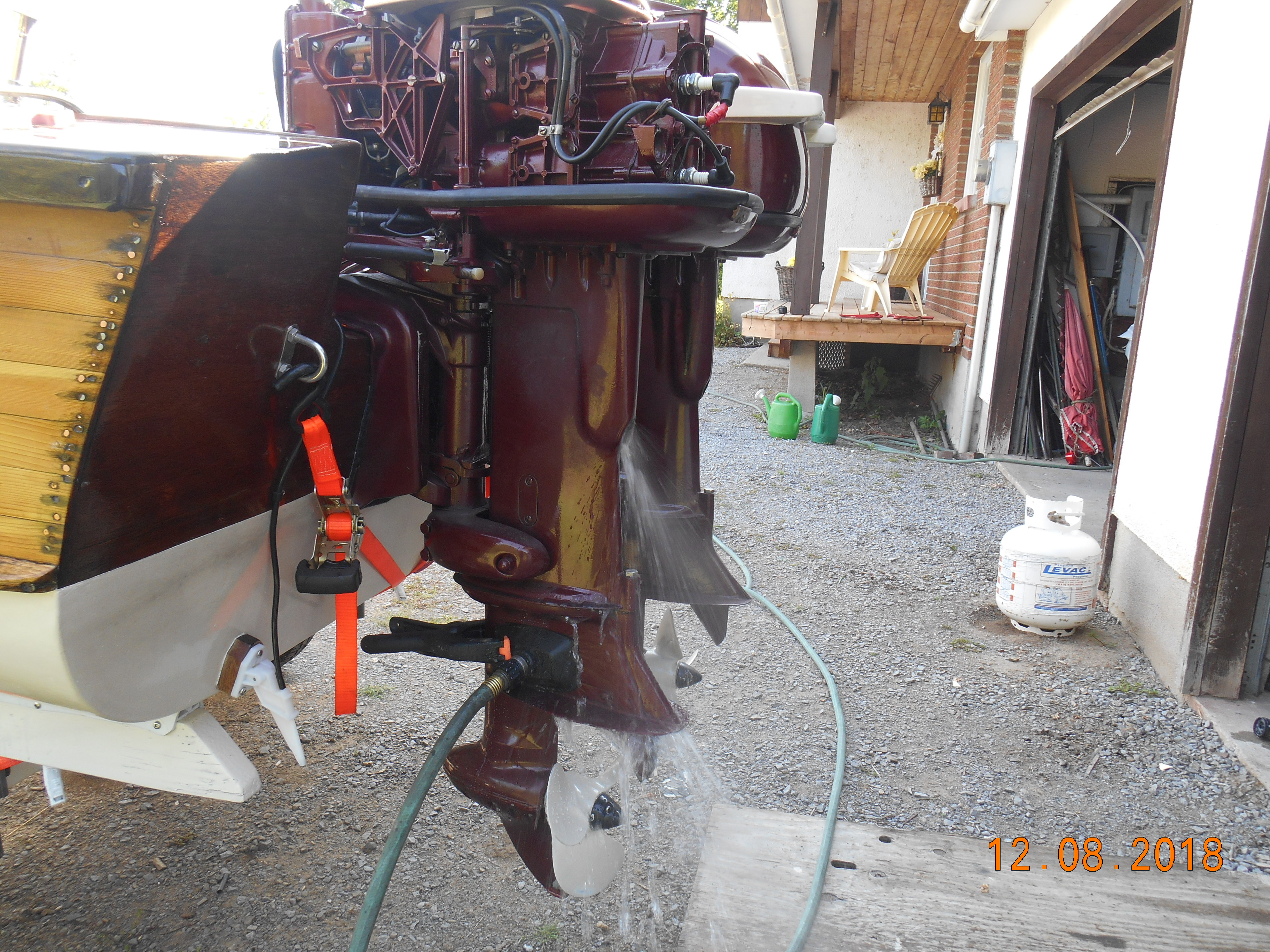

                Installed a couple of new exhaust housing gaskets and ran the engine on the hose today.
                Unfortunately the same result as original observations, with a sort of turquoise fluid in the collection bottle again.
                So, where to look next???
                Some facts
                Engine ran for about 20 min on fast idle.
                Purged the lines for a few minutes to clear out Sunday’s fluid.
                I DID see some vapor in the bottle today.
                Pulled the plugs right after shut-down, one had the slightest trace of dampness barely evident.
                I only had the one "muff" so could not make a fluid volume comparison simultaneously.
                Took some pics of fluids collected on Sunday and today for comparison. Love the one on far right of cooling water ejected from exhaust spout!
                The fun continues……suggestions welcome.
                Bill.

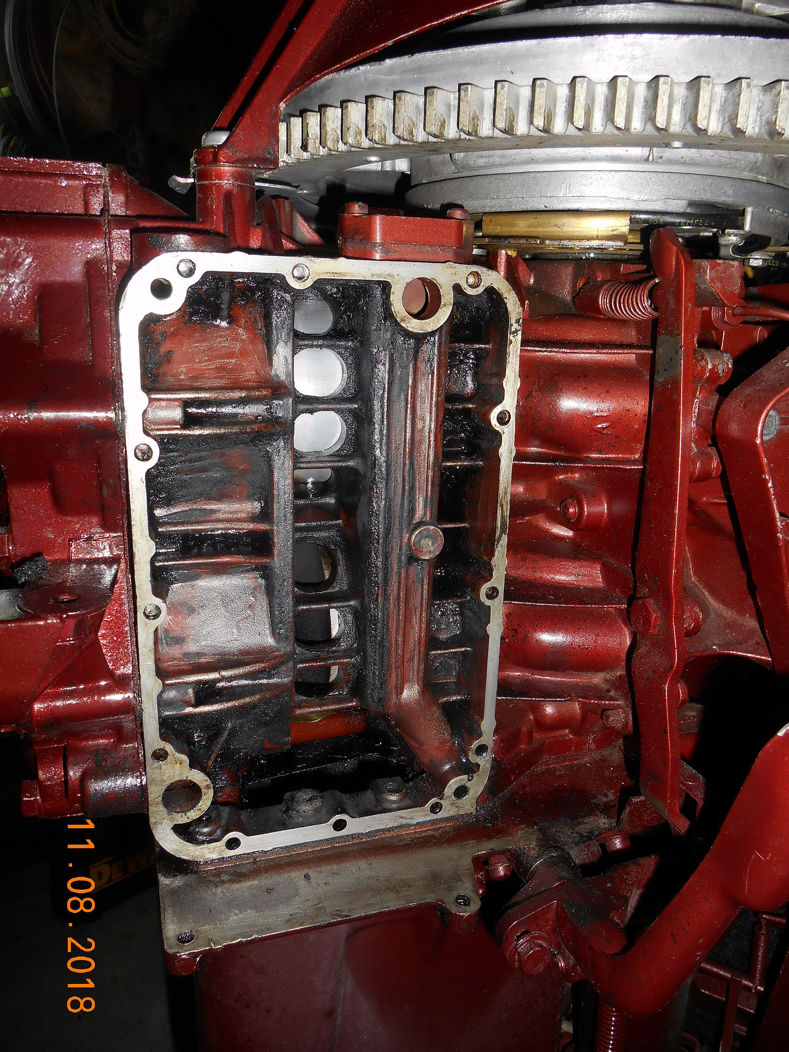

                #81110
                  Bill,
                  In your previous post, I thought you were onto something when you found the loose exhaust cover screws and what looked to be water intrusion at the bottom of the exhaust cover/exhaust chamber. The inner exhaust baffle plate looked good, right?. I couldn’t see any sign of perforation in the plate.
                  Assume you used gasket sealer when installing new exhaust gaskets?
                  Applied gasket sealer to exhaust cover bolts?
                  Any sign of water seepage around the outside of the cylinder head gasket?
                  Unfortunately, might have to pull powerhead and check lower crank seal.
                  Those are some great looking motors. Hope you can track this down.

                      Just by the amount of water in the original collection, I would have sworn you had a pin hole in the exhaust baffle. But I guess not. If that much water gets past the lower seal, I am amazed. I know it gets enough to ruin the engine, but never would have thought it would be that much. I guess we all are on a learning curve here.
