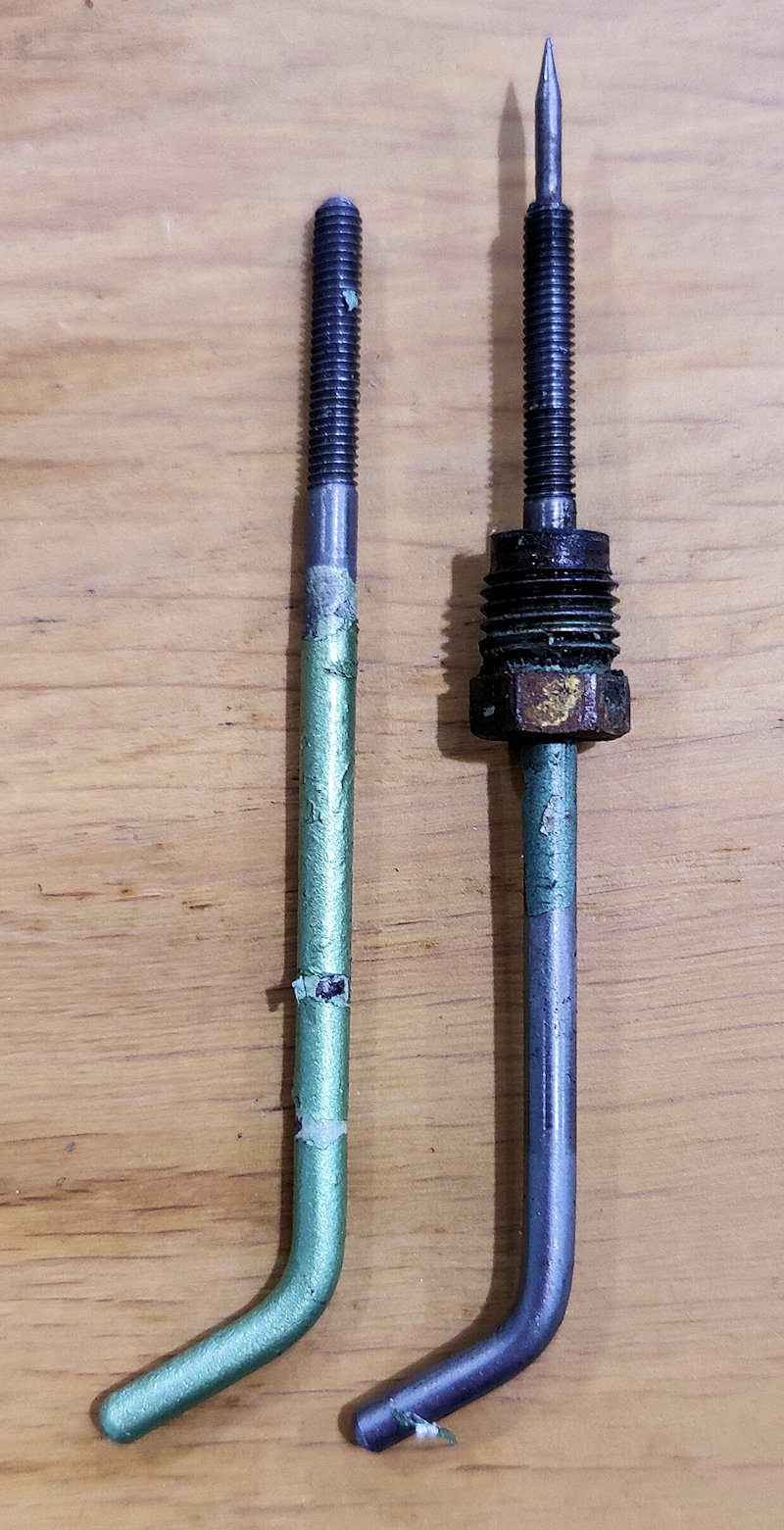

      I removed the low speed needle, still could not prime the motor.
      Then I took a low speed needle from my donor motor to compare, see below. If it isn’t obvious enough, the left one is from my good motor, the right from the donor. Guess what’s causing the obstruction? That’s going to be a pain to get out.
      #270667
      Tom
        It may not be that hard to get out… the threaded part is intact.  Some solvent, maybe a little heat, it should come out with a tap on a wood table.
        T
        #270668
        Fastwin18
          Actually a bit of compressed air aimed at the front hole blew it straight out.
          Screwed in the donor needle and it started almost instantly, much easier then previously. Then I started tinkering with the needles and it died again, and now it starts difficult, if at all.
          all in all I think I (or rather you) have found the culprit. I will try again this evening (really have some work to do now) and let you know how it worked out.

          #270670
          aquasonic
            Try removing the low speed needle, and push the primer with the low speed needle removed. Sometimes this will clear an obstruction.
            Try this again with the replacement needle removed.
            Improvise-Adapt-Overcome
            #270675
            Fastwin18
              The obstruction was the broken needle point. With the new needle the motor actually responds when I’m turning the low speed needle, whereas previously it wouldn’t. I couldn’t resist giving it another go (work can always wait, right) and now it runs much, much better. Still not as slow as I know they can, but I think I’ll get there with a little bit more time.
