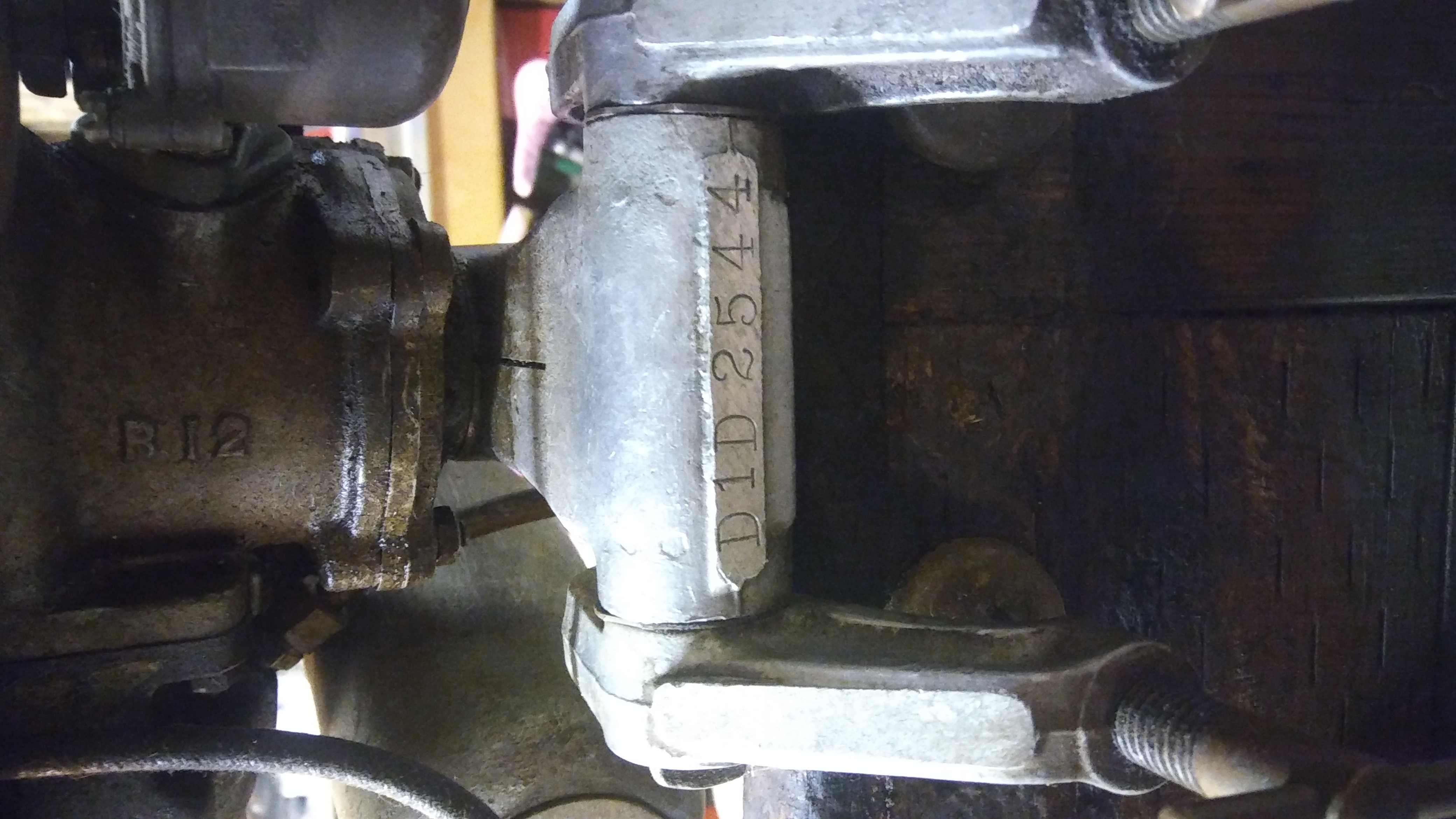

      Here is an example where you find the model and serial#;

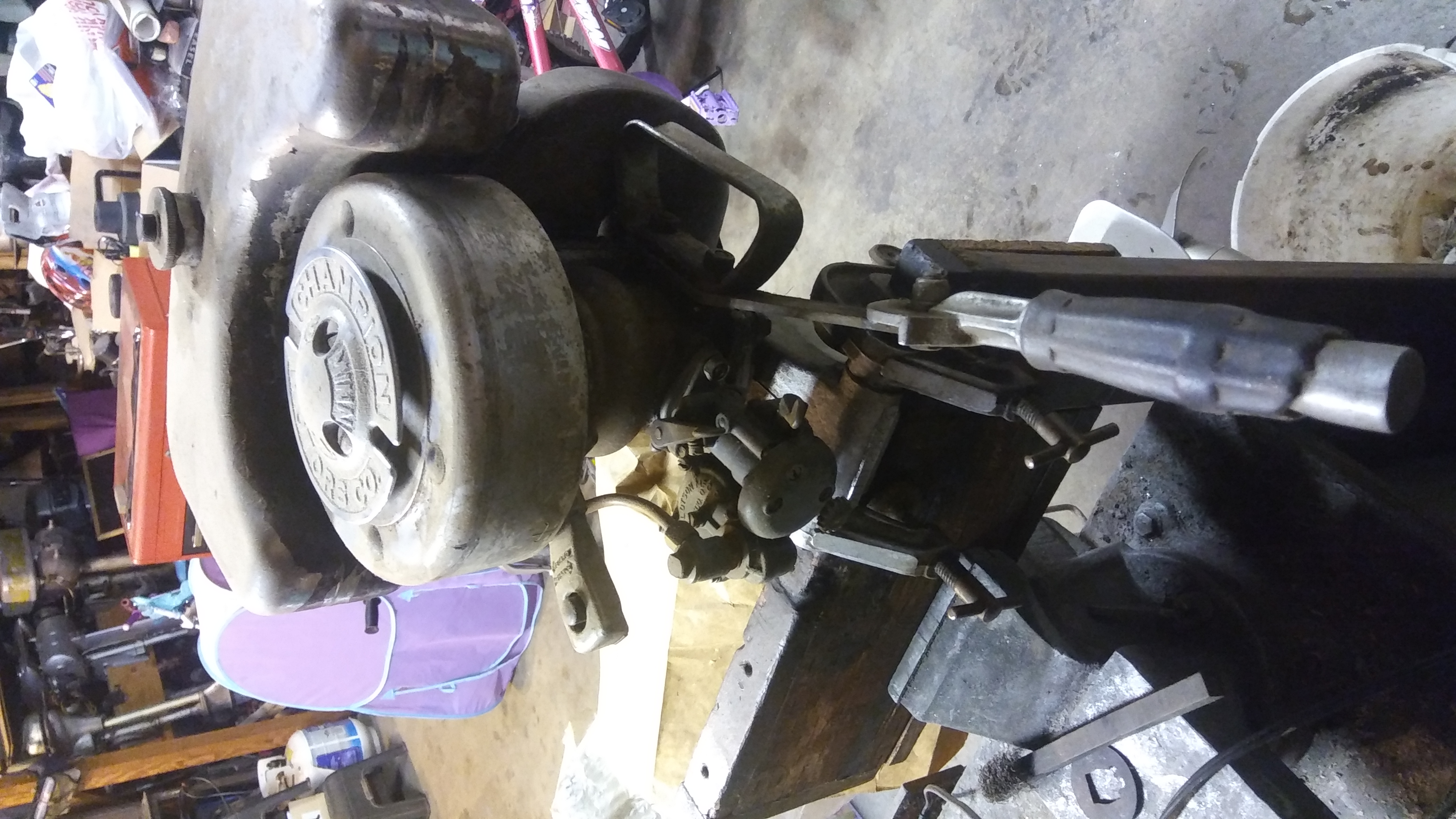

            #57244
            skeg
              Remove the tiller handle. Behind the shock obsorber there should be a serial number. Is the exhaust can aluminum or a metal can? What does the sheave plate say on it? IS the lower unit water pump bras and exposed or is it in an L Shaped Alum shroud.
              Sounds so far like you have a Model A from 35 or 36.
              Tks,
              Skeg
