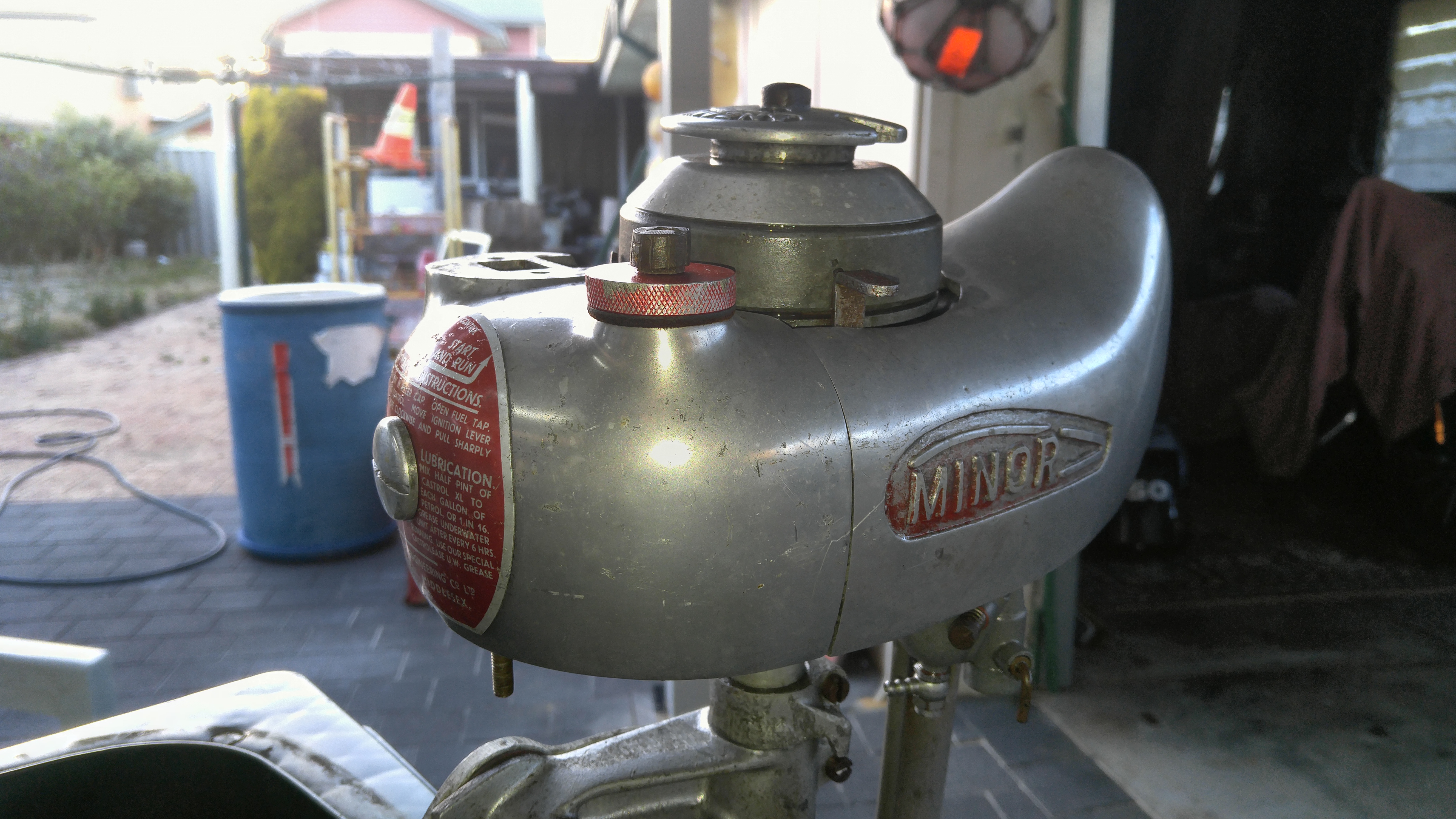

          most Britannia’s here are from the 50 ties and not so rare, I think I have four in the storage.
          this is a nice one , except the tank .
          Homemade ? but……., what ever , better than nothing
          Senior problem I give that a big tick.
          What is the problem with the tank?
          It is a direct copy of original except in aluminium (Correct Spelling) ?
          Regards
          BnC

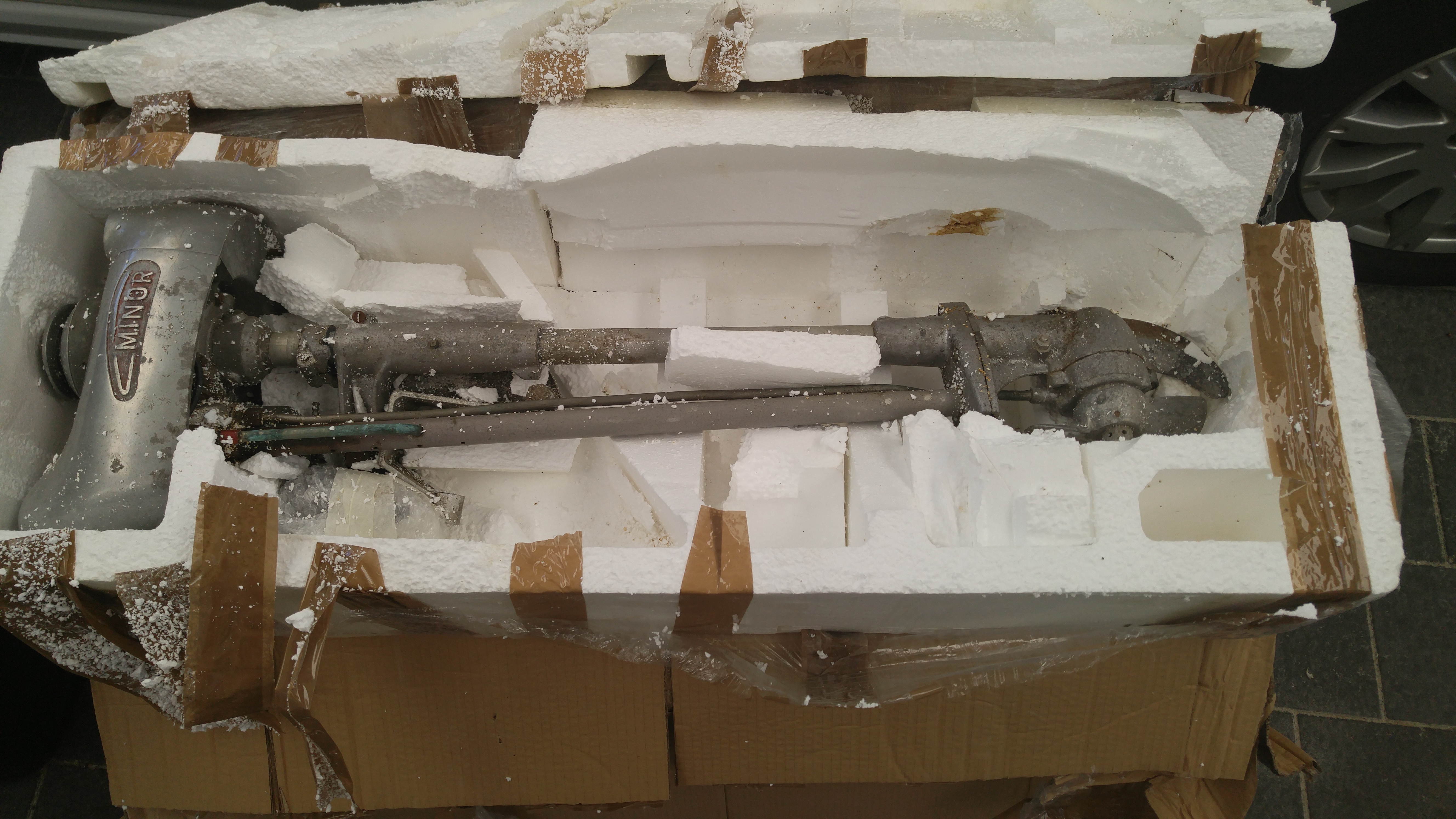

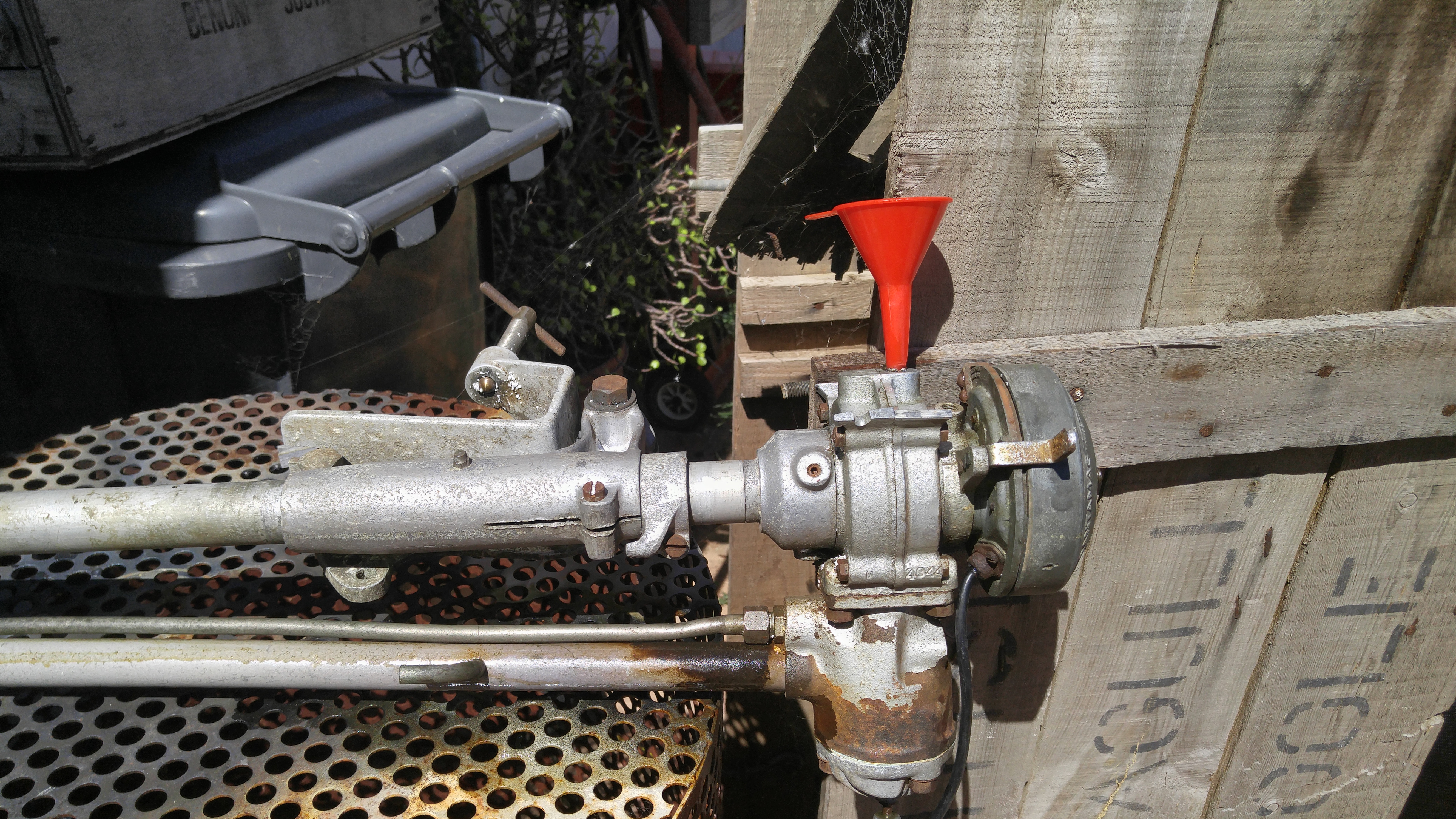

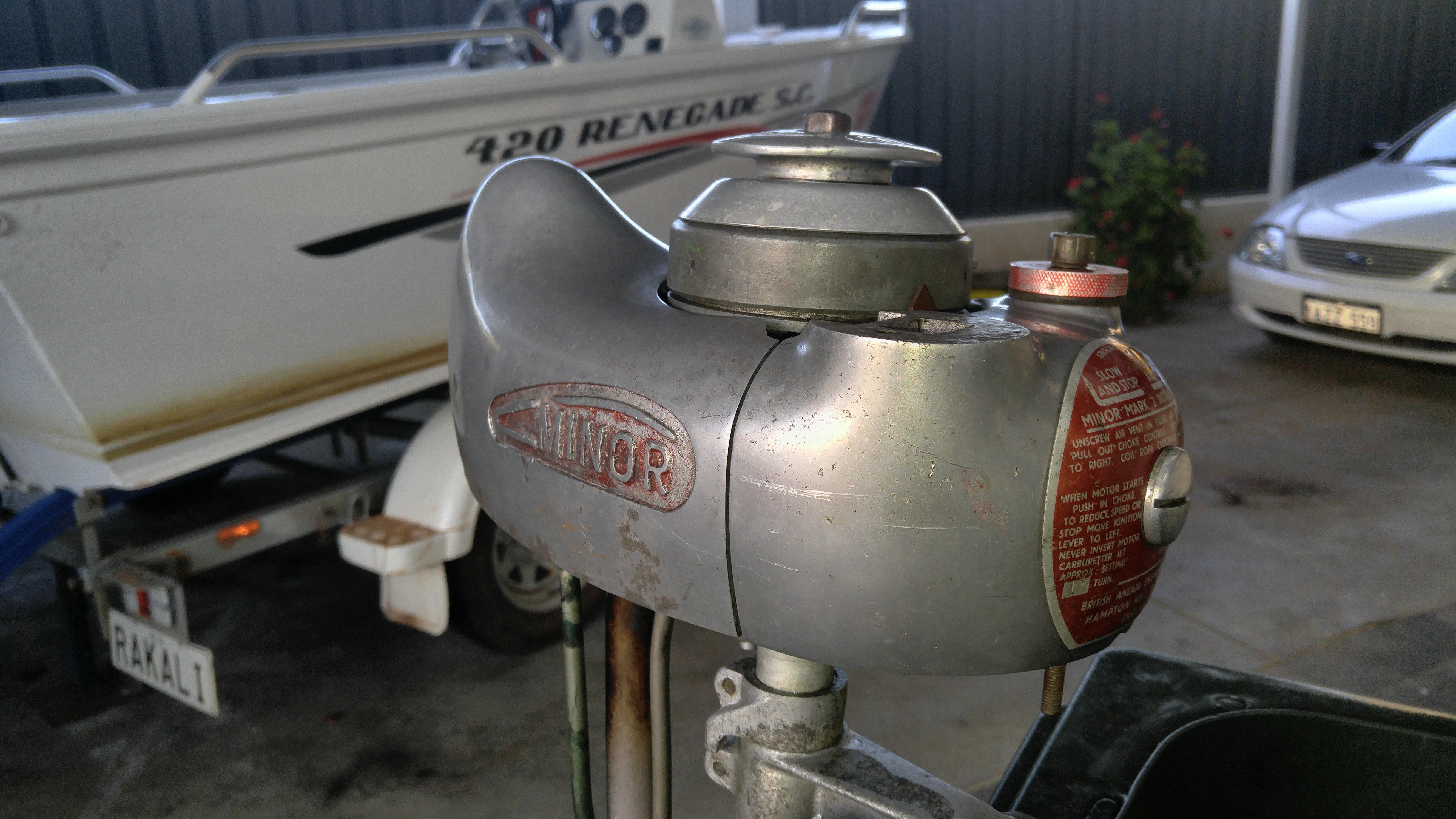

            OK motor arrived nicely packaged.
            Good compression but very dry internally so the tank mount stud out and filled the cases up with 16:1 making sure piston just covering transfer port. It is holding the lot as nothing dripping out last hours.
            These have ball race mains further supported by bronze bushes top and bottom.The bushes do the crankcase sealing. Somewhat finicky if doing a crank rebuild last few that I have done. This one just feels "Correct" which is something cool aye.
            I made another good choice via what Ebay communication with seller allowed. I have all of missing doodads.
            BnC

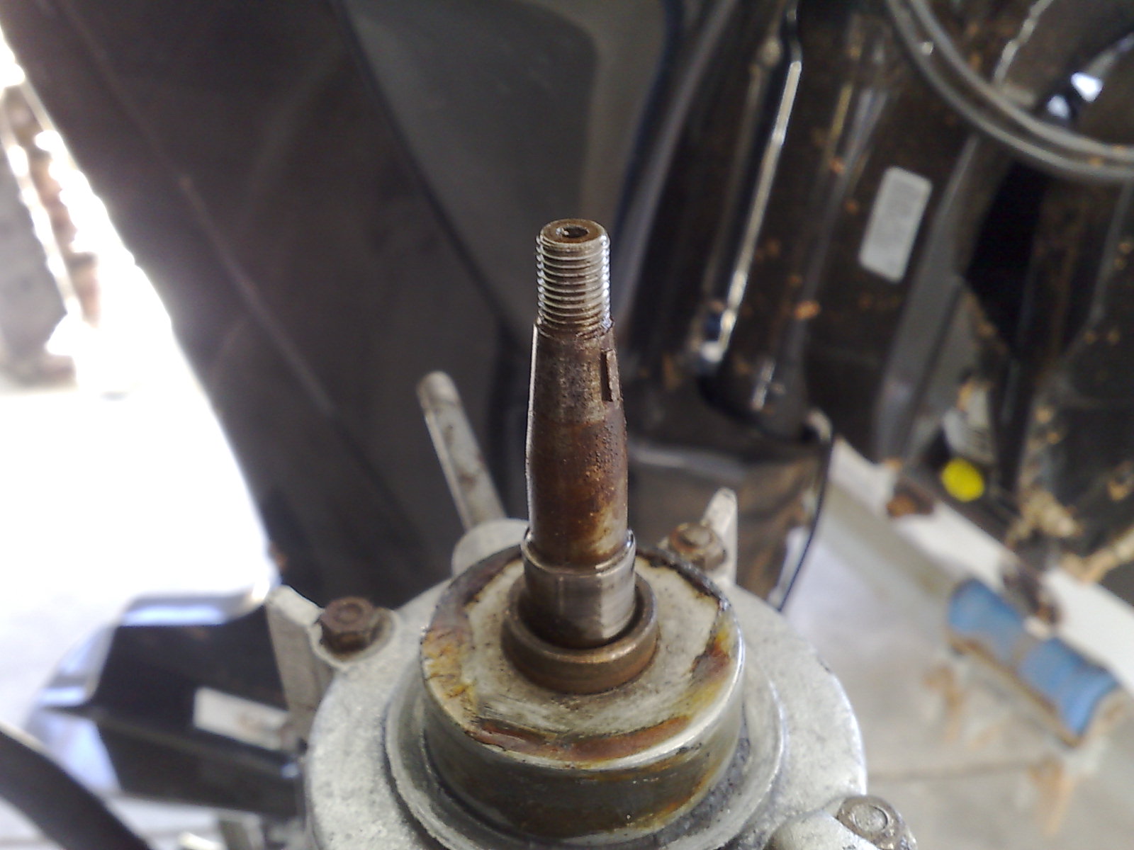

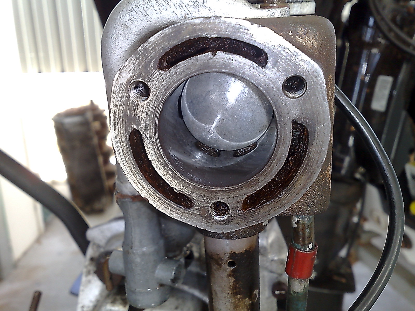

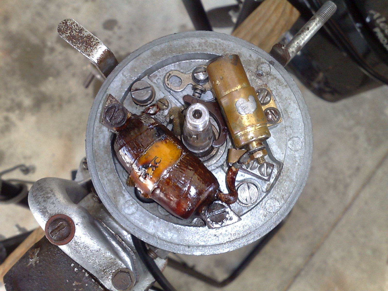

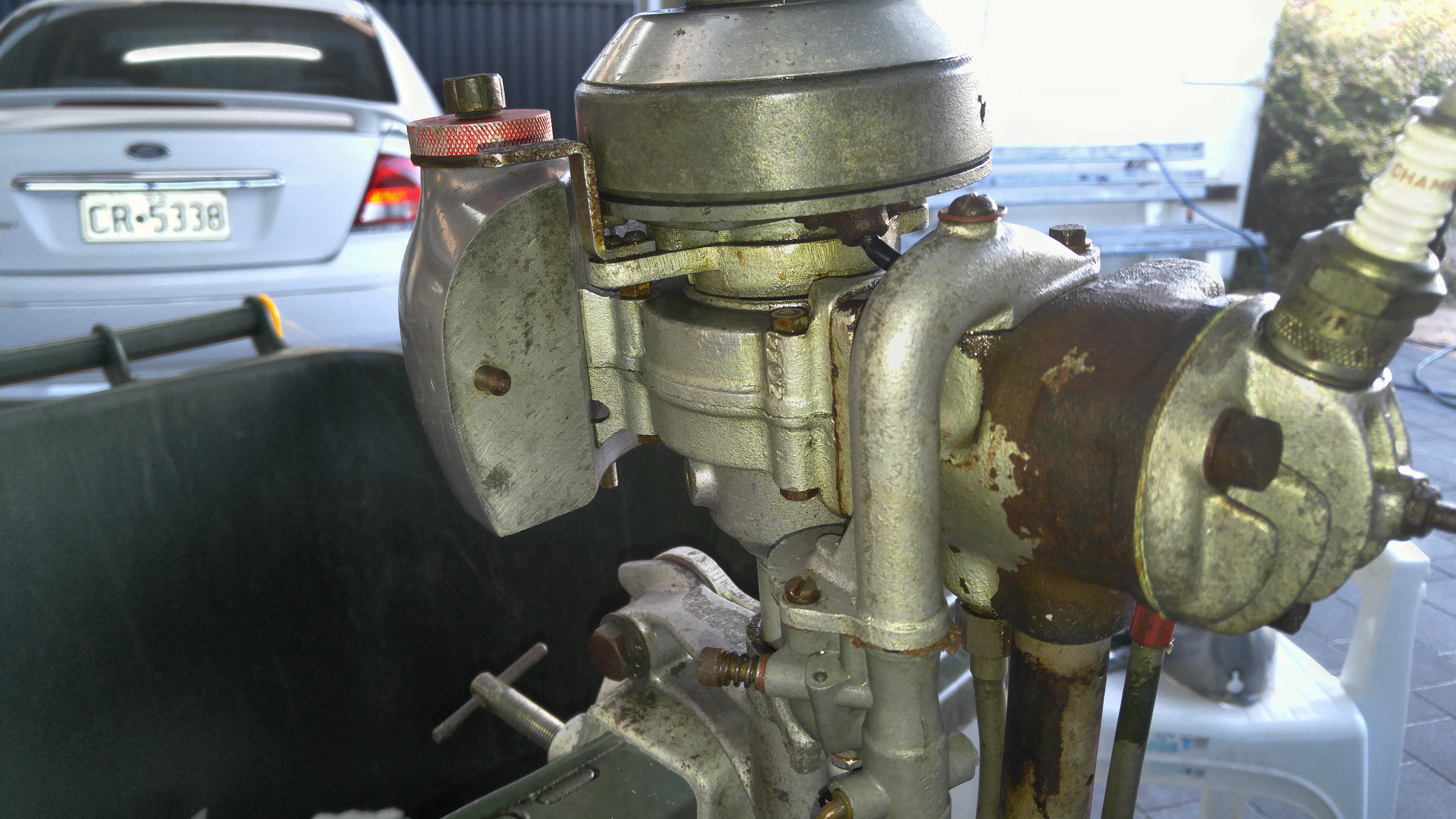

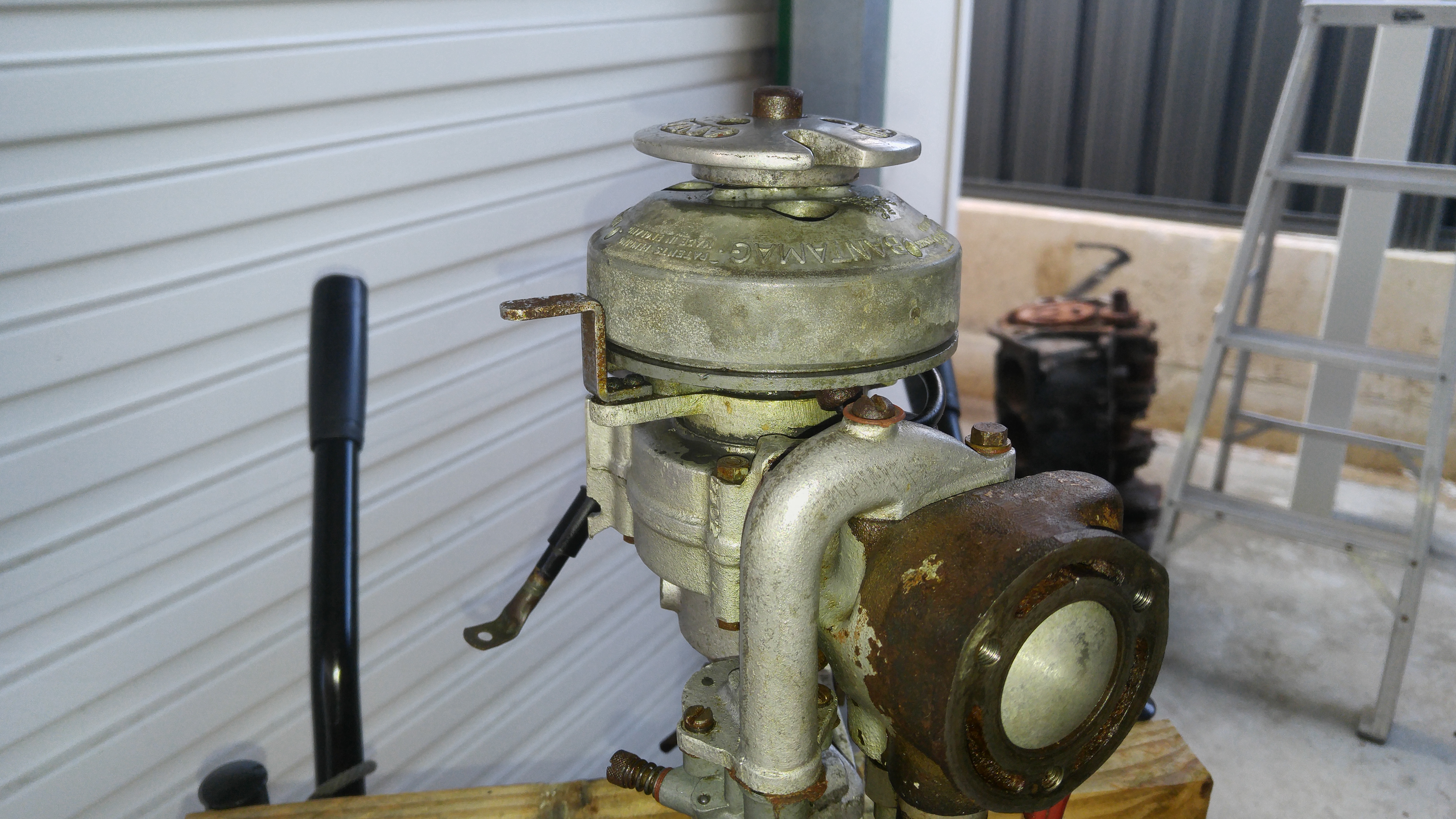

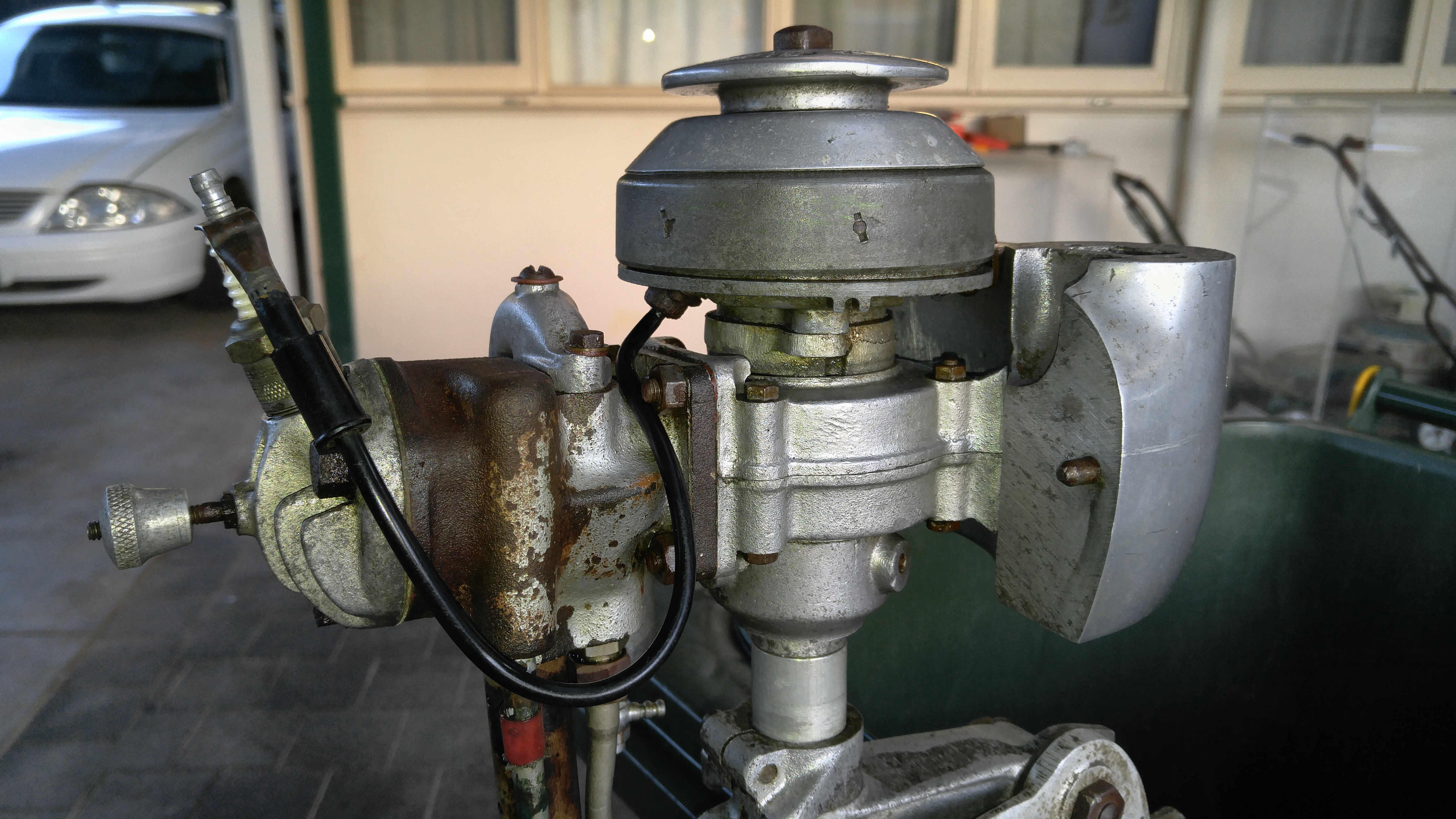

                      collectorinspector
                        Update.
                        Flywheel was an absolute sod to remove. Someone had greased the taper and it had gone hard as brick. Plenty heat and about 24hrs under constant tension with warming and cooling cycles during waking hours. It ended up coming apart with a very disconcerting snap! Thought I had pulled the centre out of the wee Wipac Banta-Mag. 😯
                        Is all good now with everything cleaned up and checked.
                        Coil reads between 3K – 4K and 3 – 5 Ohm. 😎
                        Points are cool both open and closed. 😎
                        Condenser is very erratic but averages 0.62mF Totally πŸ™ I will replace with something 0.1 – 0.2

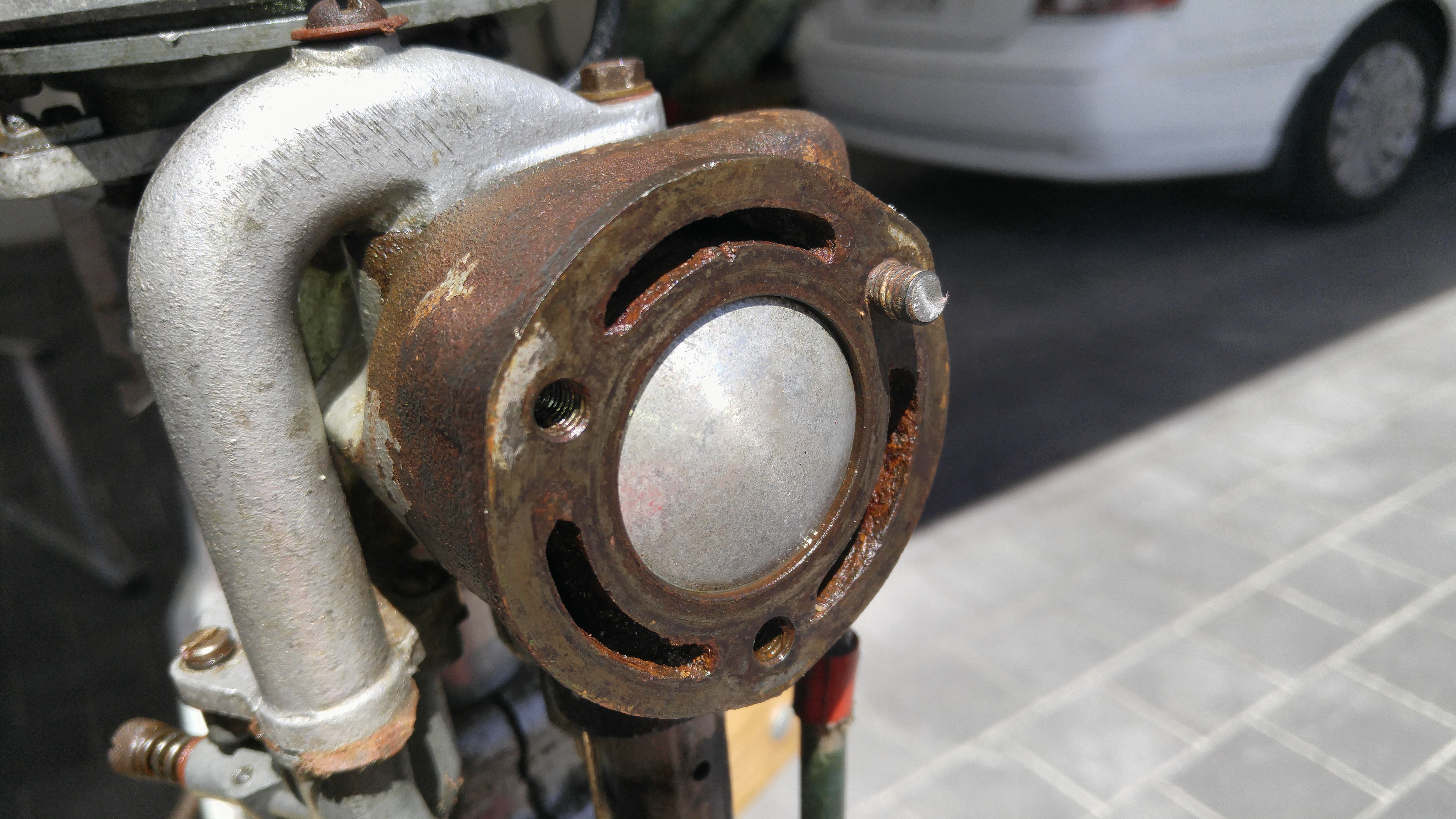

                        Broke a head bolt as not enough heat first go………I will be more attentive in 2017. No probs broken bit out.
                        As many pics that will fit so far….
                        Some pics
                        So many edits because my poor old lappy is short on RAM.
                        Next the carby.
                        This is all too good so will not be splitting cases or removing barrel.
                        BnC
