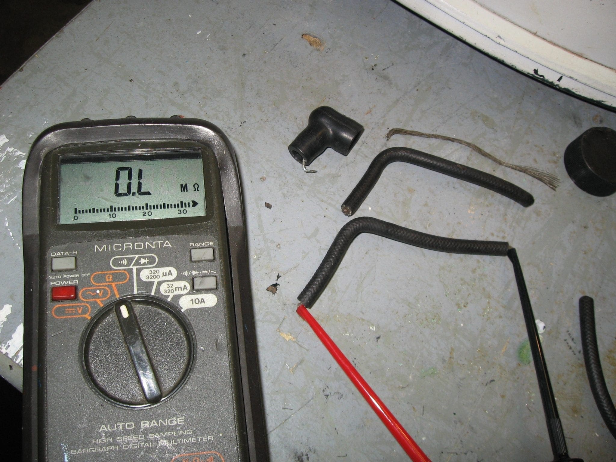

      working on my winter project 1965 MQ 9.5hp both coils read open from the plug booths
      one coil was bad (cracked) one coil was ok at 6.5kohms but….both plug wires were dead
      a quick autopsy showed why …. broken in the bend under the mag plate
      booth prick pins were shiny clean but same break identical corner on the wires !!
      snipping a quarter inch of to remove oxydation won’t always work
      IMG_0016

      #187109
        Good Detective Work!
        #187117
        squierka39
          Plug wires are cheap, well reasonably cheap. May as well change them when you’ve got new coils going in. I’ve had dead ones that I couldn’t find the break.
          #187143
            no sweat I have 7mm metallic wire on hand………. all suspect parts will be replaced
            #187160
              this dormant MQ must have slept ….quite a while… found broken primary wire under the cracked coil
              mag plate all cleaned up & rebuilt except for caps and points which I suspect are quite good ..to be tested when ice is out next spring 🙂
