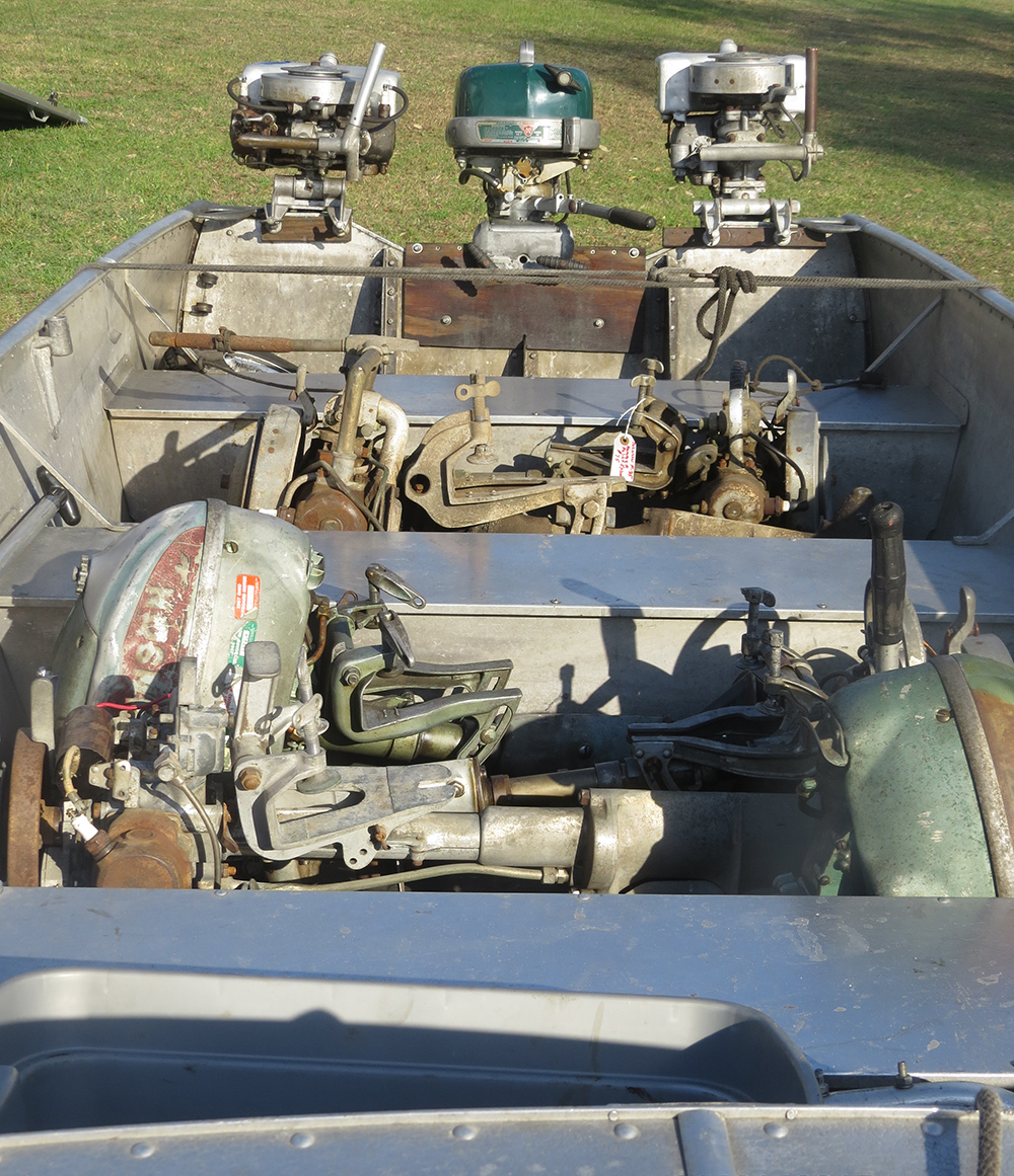

            Steve Woods runs his Big Four on an aluminum 16 foot Orlando Clipper. It gives a GREAT boat ride. The motor is stored hanging from a ceiling beam in his garage when he uses the boat for one of his other hundreds of motors.
            The boat is also good for hauling motors – Then he put a 14 foot boat up side down on top. He also has 4 smaller outboards in the trunk of his car. . . 😀
