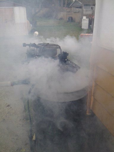

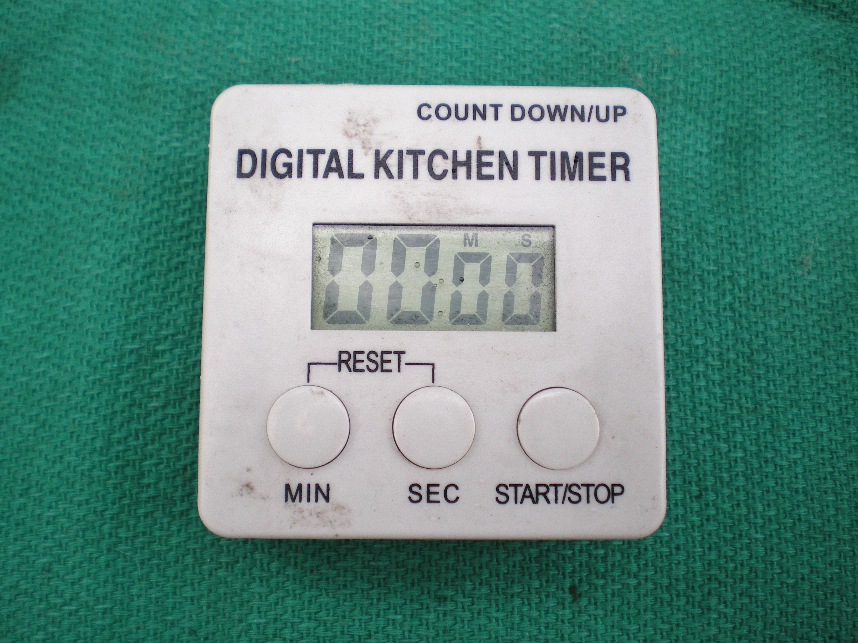

        Here’s a tip to help out while fogging motors to empty the carb/fuel lines and coat the internals at the same time. With the motor running, I unplug the fuel line and use a cheap dollar store timer to see how long it will run before running out of fuel. I do this several times without adjusting the throttle to make sure I’m getting consistent times. When I’m ready to fog, I watch the timer and when the motor is getting near the end of its fuel supply, I start spraying the fogging oil. This way, when the motor dies I know its from lack of fuel and not from the fogging oil fouling the plugs and leaving fuel in the system.
        If you are using Sea Foam to decarb a motor or fogging a motor, it’s best to do this on a breezy day or at night if you have neighbours nearby!

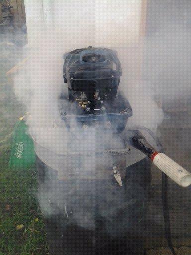

              Fogging is very necessary on any outboard with roller bearings in the crankcase. My favorite method is to have a can of fogging oil and using the red extension tube spray directly into the carb throat while the engine is running. While I’m fogging the motor, I already have the fuel line disconnected… I like to treat the fuel with stabilizer as well. If you know what to listen for, you can hear when the engine has consumed the remaining fuel in the carb bowl, as it will speed up slighty. Continue to fog the motor a few seconds more, then let it die. I don’t worry about removing any spark plugs to squirt oil into the cylinders, because in my opinion, you have already accomplished that. Here on Lake of the Ozarks, it is very rare to see someone fogging an outboard, say on a bass boat, etc. I can’t tell you how many motor’s have come through my shop with rust in the cylinders! Not fogging a modern roller bearing motor will promote crankshaft and bearing rust as well… a good way to ruin your motor. Of course outboards with brass bushings need to be fogged too, IMO.
              As far as what fogging oil to use, I think any would work. My preference is Quicksilver which is very good stuff, or I use CRC brand, my personal favorite

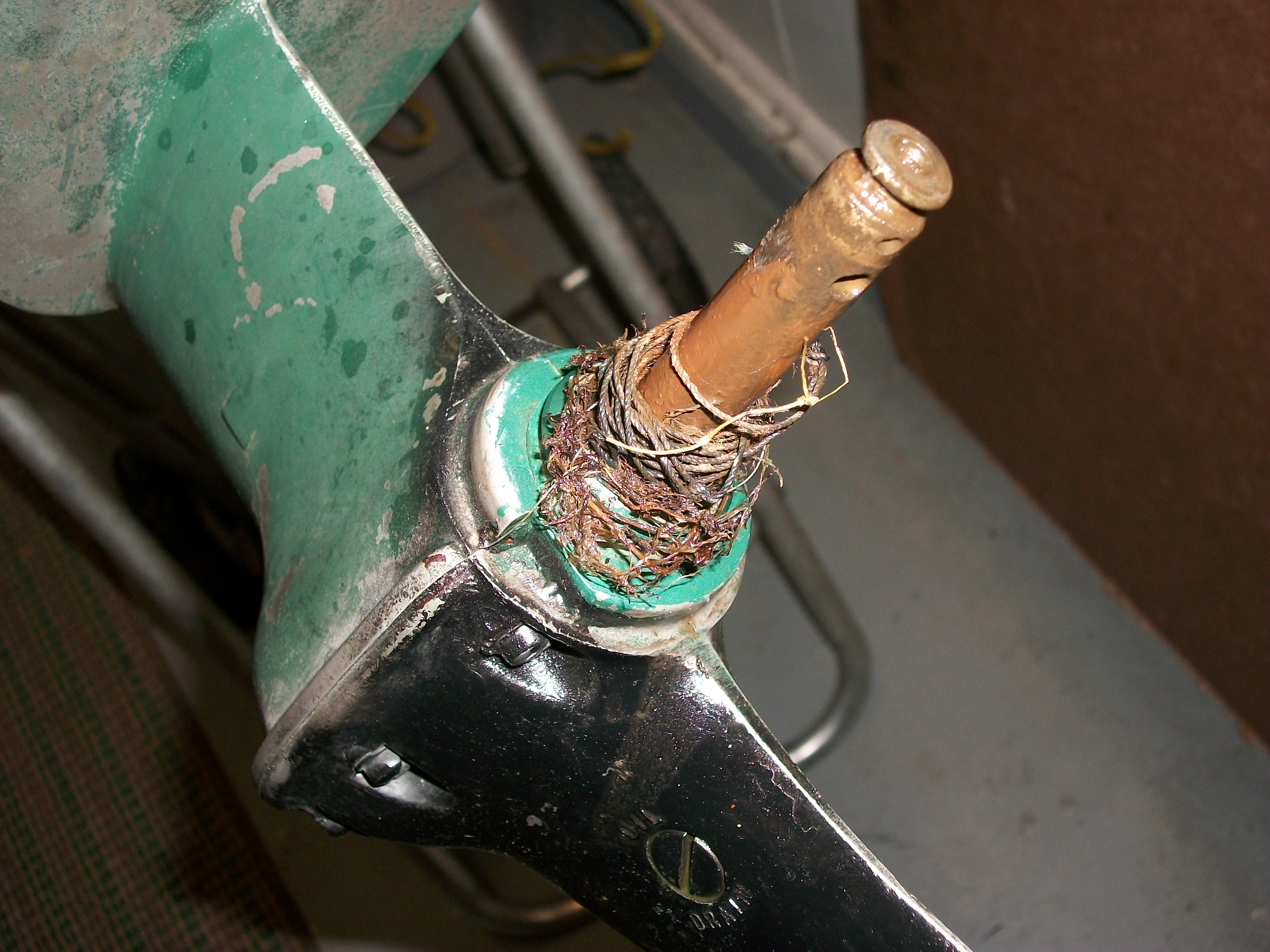

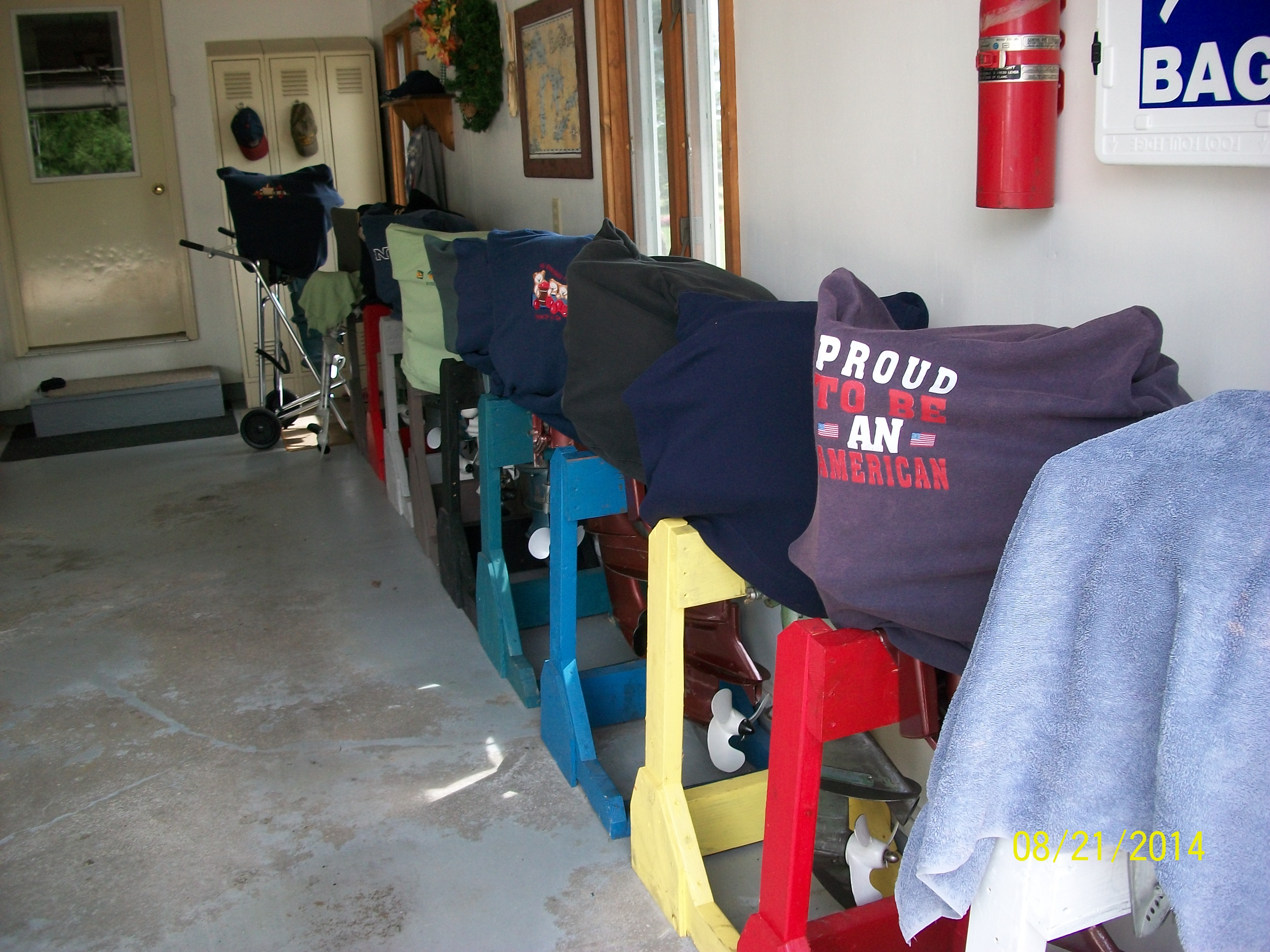

                  I have a little different way of winterizing my one arm bandits. First all my motors have a tag on them. With info about the last time they were run and work they might need. Motors not run in the season get the roll over on Friday method. The runners get the prop pulled to check for fishing line, plugs pulled, pistons put at bottom dead center, and I shoot the fogging oil into the transfer ports while the motor is tilted up. Trying to get the oil into the crankshaft area. I also found out you can send some fogging juice up the gas line connector. Put the plugs back in and roll the engine over with compression to move the oil around some. Check lower unit for water, either change oil or leave it empty if it is milky color. I have home made covers for all my motors. Old sweat shirts that I have cut the sleeves off and sowed the neck and the arm holes together. The covers help stop the nicks and dings that happen when the baby’s are moved around in the off season.
